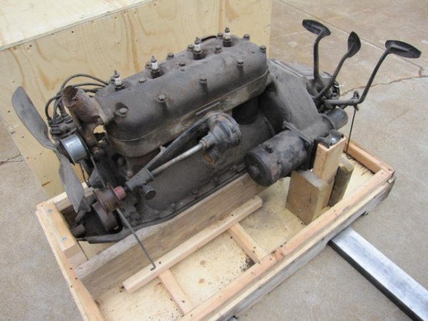

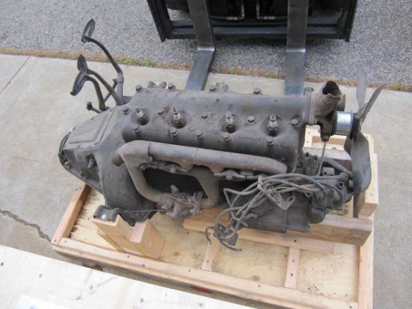

Complete engine or short block? There is one link that shows one built may give you some ideas. Note how the pan is supported
viewtopic.php?t=17080
You could also use some of these dimensions
http://www.mtfca.com/discus/messages/11 ... 1279901294
http://www.mtfca.com/discus/messages/118802/147784.html

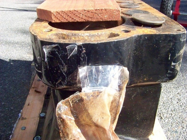

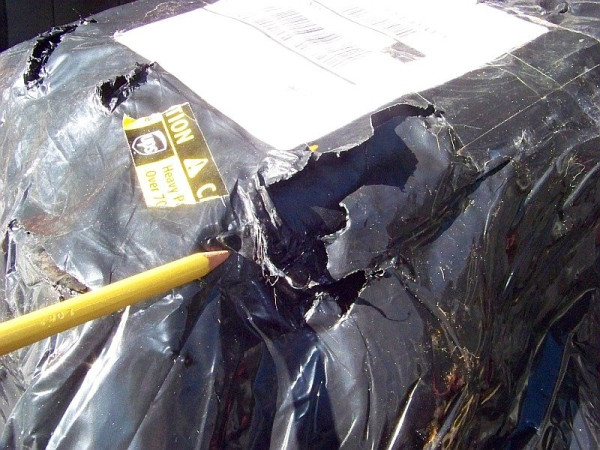

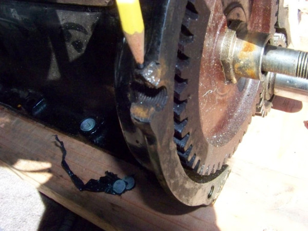

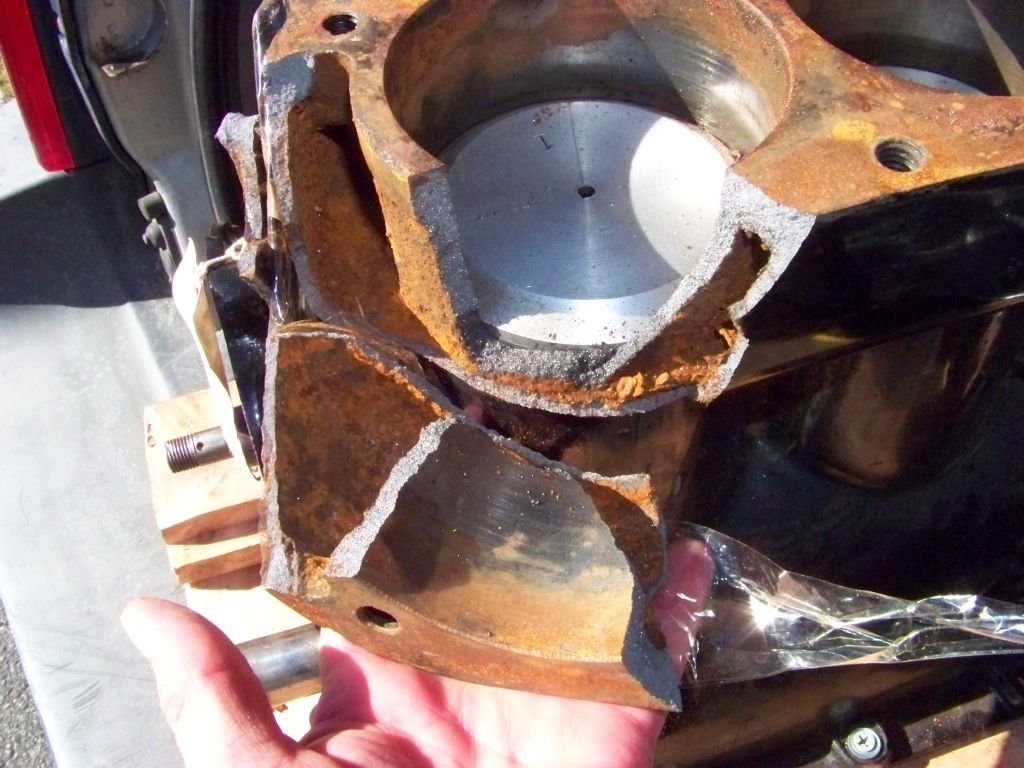

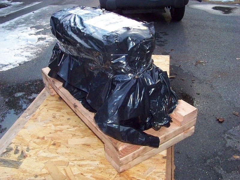

It really is important to properly secure and protect any package.
A rebuilt short block was shipped from the left coast to me, here in The Shire.
Rips and tears in the plastic roused my suspicion.
The block was secured to a modest "pallet" of boards with another board taped to the top of the block. It was all wrapped in clear plastic with an outer layer of black plastic.
There was some rough or, at minimum, careless handling which resulted in a bit of regrettable and discouraging damage. :roll:
Do make a serious effort to pack your items for safe and secure shipping.
Bill Harper

Post by jiminbartow » Sat Apr 09, 2022 8:44 pm
Wow! What a disaster. I’m so sorry to see that! I hope you insured it for a substantial amount. A good illustration as to why to use heavy 3/4” plywood top, bottom and sides and 2”x 4” supports and to insure your shipment. Jim Patrick
