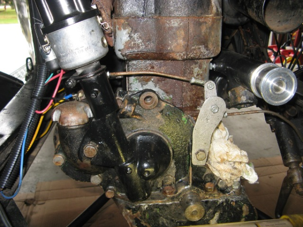

I assumed that the rest of the instructions might apply. Best picture I could find for the Reader Distributor.
I'm throwing this out for further discussion
So some verification needs to be made of the parts for the current supplier has cap, rotor, condenser, points and gear set are the same as their VW01 and a VW 009.
Also note statement from Langs
"The distributors heads that they use are vary similar to the Volkswagen heads out of the mid 60's. The advance curves for the Volkswagen's do not work for the Model T's though because the model T likes to run at a much lower RPM so they either have taken the whole mechanism out or have locked it in place so it doesn't move. But the distributor will still be connected to the manual advance just like the original timing would to get the correct adjustment." They also sell a VW009 upgrade kit - so is this different (been modified) than a a VW009 that NAPA sells.

Re: Distributor Question
Frank,
That looks like the distributer I have and was told that it was a Reeder Dist.
Craig.

Thank you to everyone for the information,
Your posted pictures do look very much like the distributor in my car. All the input has been most helpful. Any suggestions for the best replacement points & condenser?
Thank you, Peter
