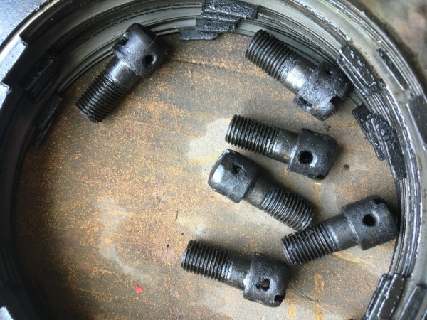

also my drive plate had this style holding it together. All the ones I have seen have bolt heads. Just an observation…
Posts: 5104
First Name: john
Last Name: karvaly
Location: orange, ca
Re: Transmission drum riveting
Post by speedytinc » Sun Apr 10, 2022 5:56 pm
Early wide drum. 26. Not easy to get a good torque on.
Substituting drilled allen bolts is better than these screws IMHO.
