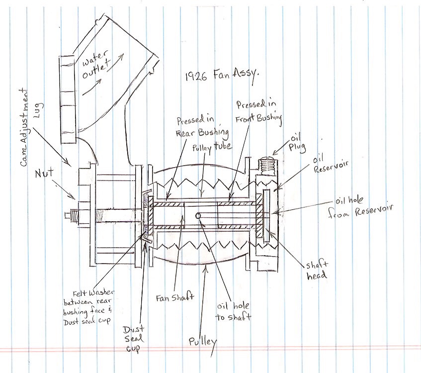

Unscrew the fan hub set screw just behind the fan and fill the reservoir with engine oil. The oil flows through a tunnel through the center of the shaft and comes out into the void between the front and rear bushings. Jim Patrick

That’s a nice drawing Jim! Very detailed 👍

Thank you Bryant. I drew it ten years ago when I had my fan assembly apart installing new bushings and seals. Regarding the oil viscosity, the most important thing is to find a happy medium. The oil needs to be thin enough to flow through the shaft tube but thick enough to not be slung out. Too thick and it will not be able to find its’ way through the shaft to the void between the bushings. Jim Patrick.

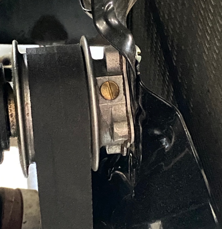

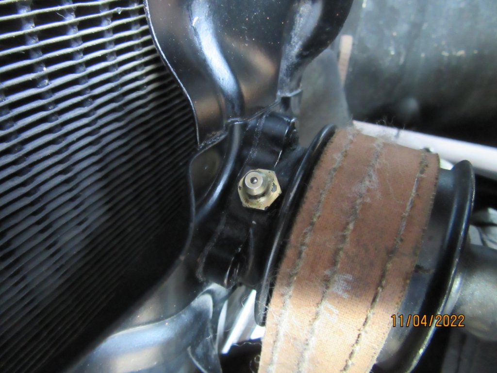

Dan - here is photo of oil screw on my ‘26.

Thank you for the picture. I'll check later today, but I think the brass screw on mine is under some paint. Might have to clean things up a bit.
But thanks again.
--Dan

Thanks for that pic Chuck.
I had to do a little exploring thru multiple layers of paint and gunk to find mine on my '26 project.

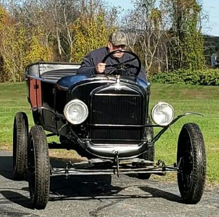

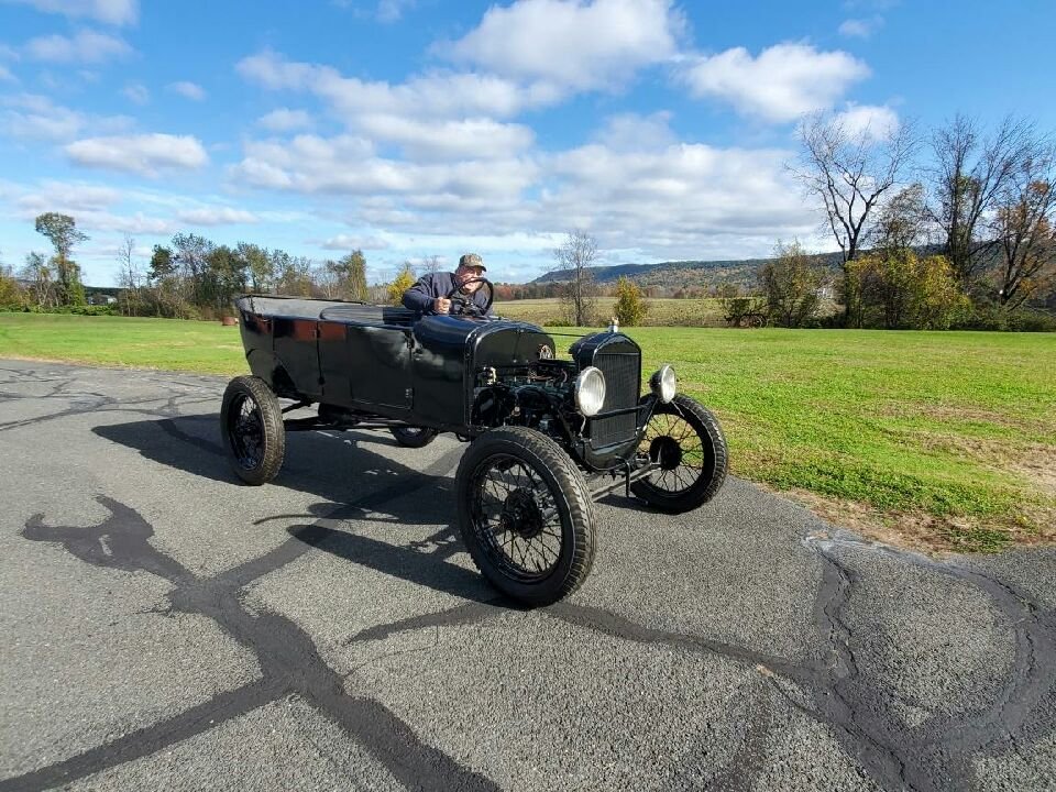

Half windshield and hood to be installed shortly. Speedster style! No fenders 4 me......😁
