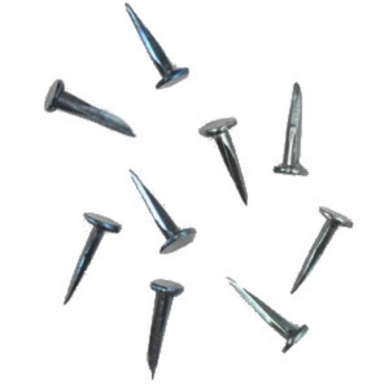

Just looking to see if anyone might know/remember what size they used when re-installing the kick panels, Not the upholstery nails that hold on the welting, rather the tacks that attach the kick panels to the wood frame. The kick panel material is 3/32" in thickness, so I am thinking that the 2.5 oz tack would be the right size. Any help is greatly appreciated.
2.5 oz is 5/16" in length
3 oz is 3/8" in length
4 oz is 7/16" in length

I would use the 3 oz tacks an the bare minimum. The wood is old and could possibly be a little 'punky'. The longer tack will probably hold better. Just my opinion.

Arcane, yes. The thickness of leather is measured in ounces and the size of the tack would indicate the thickness of leather it would securely clinch, a 3oz tack for 3oz thick leather.

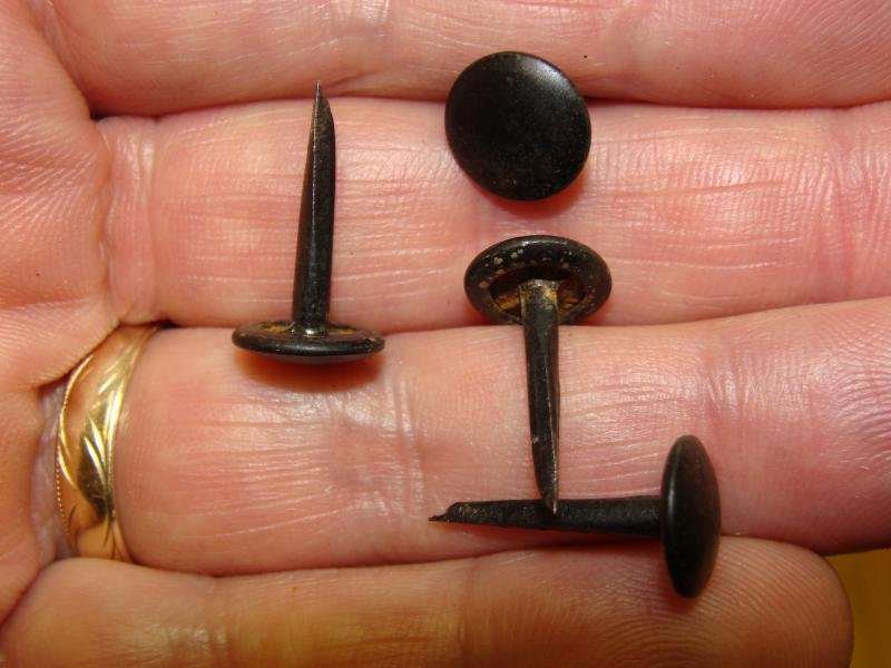

The tack holds the panel to the wood frame:
Once the panel is in place, the upholstery nail holds the welting to the panel and frame:

Re: What size tacks to re-install the kick panels?
It is prior to your '25 Runabout, no metal channel/clips to hold the right-front and part of the left-front kick panel, but there are still tacks to hold the panels in place on a '25. Because of the metal channel/clips on a '25 Runabout, there may or may not be tacks along the top edge of a the left side kick panel, I do not know I have never owned a '25, but the upholstery nails for the welt/binding trim most certainly hold the kick panel in place. The door panels are put in place then trimmed out with the welt/binding, unless you are installing the panel and welt/binding at the same time and only using the upholstery nails. So for the sake of the discussion we will say it is between 1913 and 1927, which the Encyclopedia from the MTFCA website says that for 1913 to 1927:Original Smith wrote: ↑Sun Apr 10, 2022 9:19 amMy '25 roadster uses nothing, and I'll bet the touring doesn't either.
"Door and side panels were covered with imitation leather until about 1917 when the side panels were changed to a black cardboard-like material, with a trim welting around the edges"
If you are using nothing on your '25 Runabout, what holds the kick panel along the top on the drivers side, tacks and upholstery nails or just upholstery nails? And what holds the kick panel to the door frame? There is most definitely something there, I will take that bet.
The original question still stands: Just looking to see if anyone might know/remember what size they used when re-installing the kick panels. Or, what size would come in one of the kits from the vendors (Classtique, Snyders, Langs).
