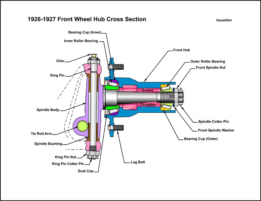

- Posts: 1678
- First Name: Dennis
- Last Name: Seth
- Location: Jefferson Ohio
Re: Front Wheel Bearings
This drawing is done by Martin Vowell and can be found on the MTFCA home page under the resource section subsection drawings.
CatGuy
Topic author - Posts: 341
- Joined: Wed Apr 06, 2022 9:50 am
- Last Name: Hunt
- * REQUIRED* Type and Year of Model Ts owned: '26 Runabout
- Location: Knoxville, IA
Looking at the above drawing I can't see anything amiss. I'll have to do as Alan says and tear into it to see the issue. I've has the ones on my '28 A apart before. These aren't that much different, are they? I can't comprehend how they can be loose, bu the spindle nut so tight.

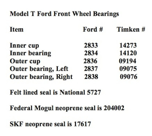

- Posts: 7393
The best prices for bearings are usually at rockauto.com.
A local auto parts store can get the seals for you so you don't have shipping.

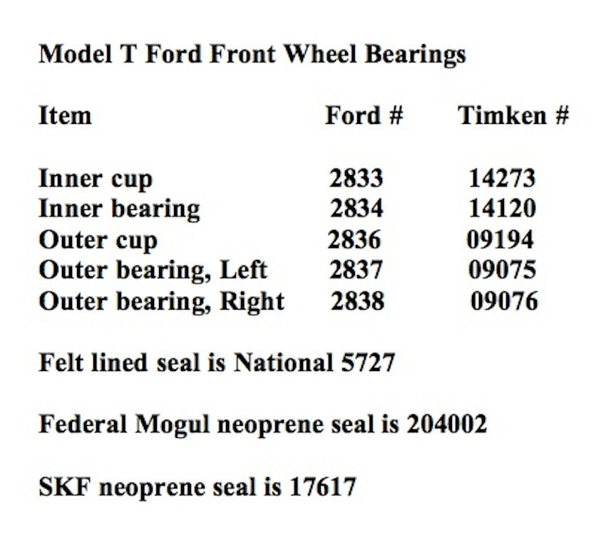

- Posts: 5470
"Now that I look at the pictures again.....I'm almost thinking I have the right set in there, but the outer bearing separated somehow. Is that possible? Mine looks just like those pictures, but came out in pieces. Would that cause it to be loose?"
Could be flat worn out !
ChrisB
- Posts: 405
- Joined: Thu Jan 03, 2019 1:38 pm
- First Name: Chris
- Last Name: Brancaccio
- * REQUIRED* Type and Year of Model Ts owned: 1909 Roadster 1915 Coupelet 1923 Coupe 1926 Touring
- Location: Calgary AB
Steve's numbers are all good, I used them last year, although the 09075 (left) bearing is still out of stock.
https://www.rockauto.com/en/parts/timke ... aring,1672
Chris
Chris
