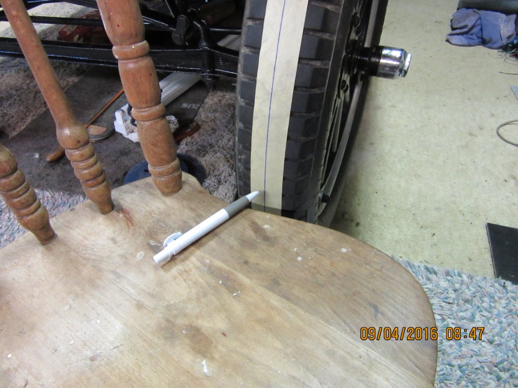

I like to jack each tire up, spin it and spray a lite color paint in the center of the tire, then spin again and scribe a line in the paint and use that to measure from. Put the wheels back on the ground and role it forward and back settle everything the check. If you don't have a trammel bar you will need to sweet talk someone into holding the dumb end of the tape measure for you. This way you get the center of wheel and eliminate any wobble in the wheel from the equation. If you can't get to the center of the rear of the tire you will need to measure the same height up on the front and calculate the difference. 2" is a lot of toe in and you're right that will wear tires out quick.

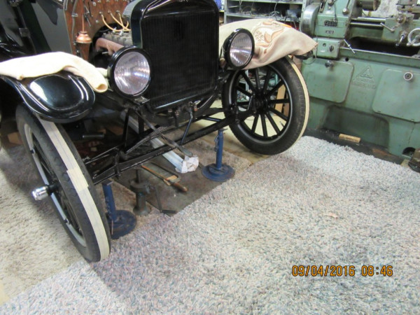

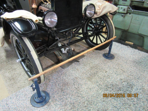

Joshua ; I do it always this way .
Toon

I scribe a mark on tape attached to the tire tread instead of Craig's method. I measure the distance between the marks with a 6 foot straight edge. I get the straight edge close to position with jack stands, then I clamp the zero end of the straight edge with a large clamp. Mark the straight edge where the scribed line is at the other wheel. Do this front and back and the difference is the toe-in.

If you're only measuring the from rim-to-rim or from tire-to-tire, etc., keep in mind that any wheel wobble will throw error into your measurements. How many T's have wheels that don't wobble??? That's the beauty of the method using the tape and magic marker line. It eliminates all of the runout error of the wheels.
