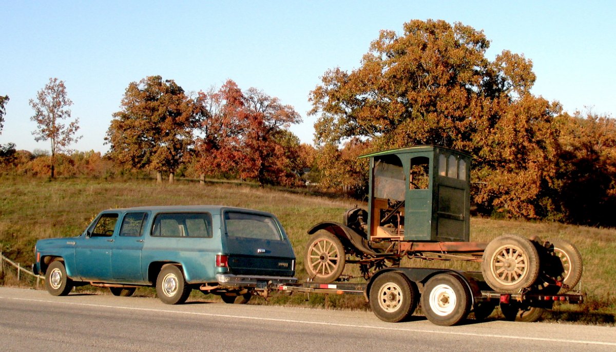

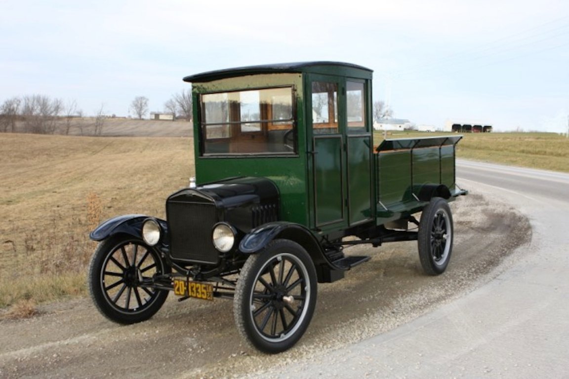

Ford didn't sell TT's with wood bodies, so there is no factory correct color for those. But of course many of those aftermarket wood bodies were painted various greens. I did a little internet search and found remarkably few good photos, but I have a couple in my files.
This one belonged to the late John Berch, who posted the photo on the forum
My 1924 TT project when I was fetching it home.

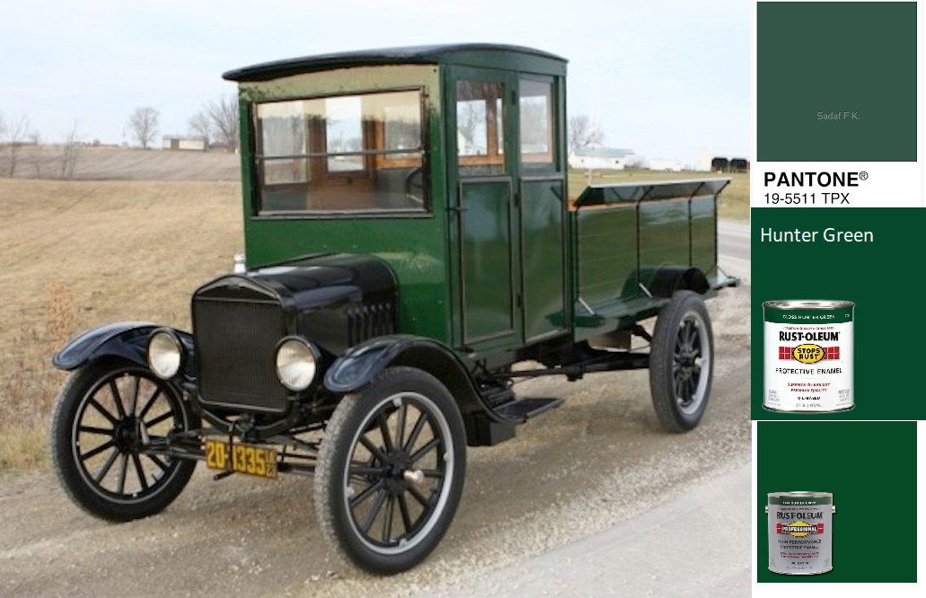

I am not recommending a brand or type, just taking a stab at the color. And as discussed one brand of HUNTER GREEN may not look like another

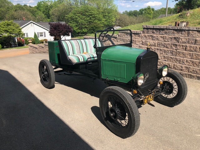

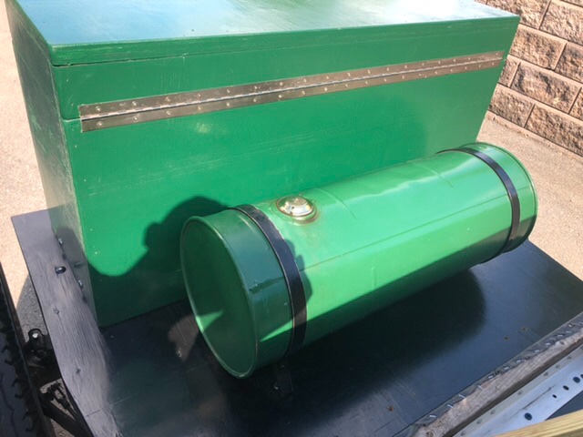

This was on my speedster but the rust oleum Hunter Green holds up well and if you want it a little darker I they sell the half pints of black to add in.
Brad

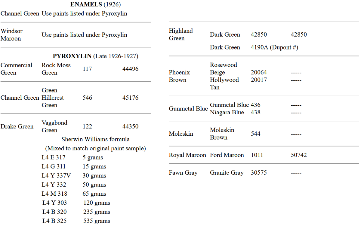

Ford painted pickup bodies in "Commercial Green".

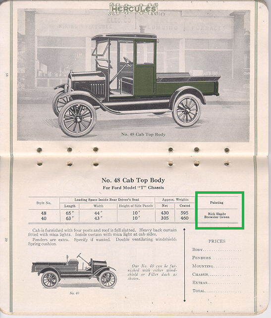

Hercules Bodies painted "Brewster Green" http://www.mtfca.com/discus/messages/17 ... 1319559906

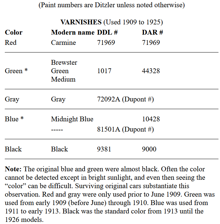

Paint colors from the the MTFCA Encyclopedia http://www.mtfca.com/encyclo/P-R.htm#paint1
