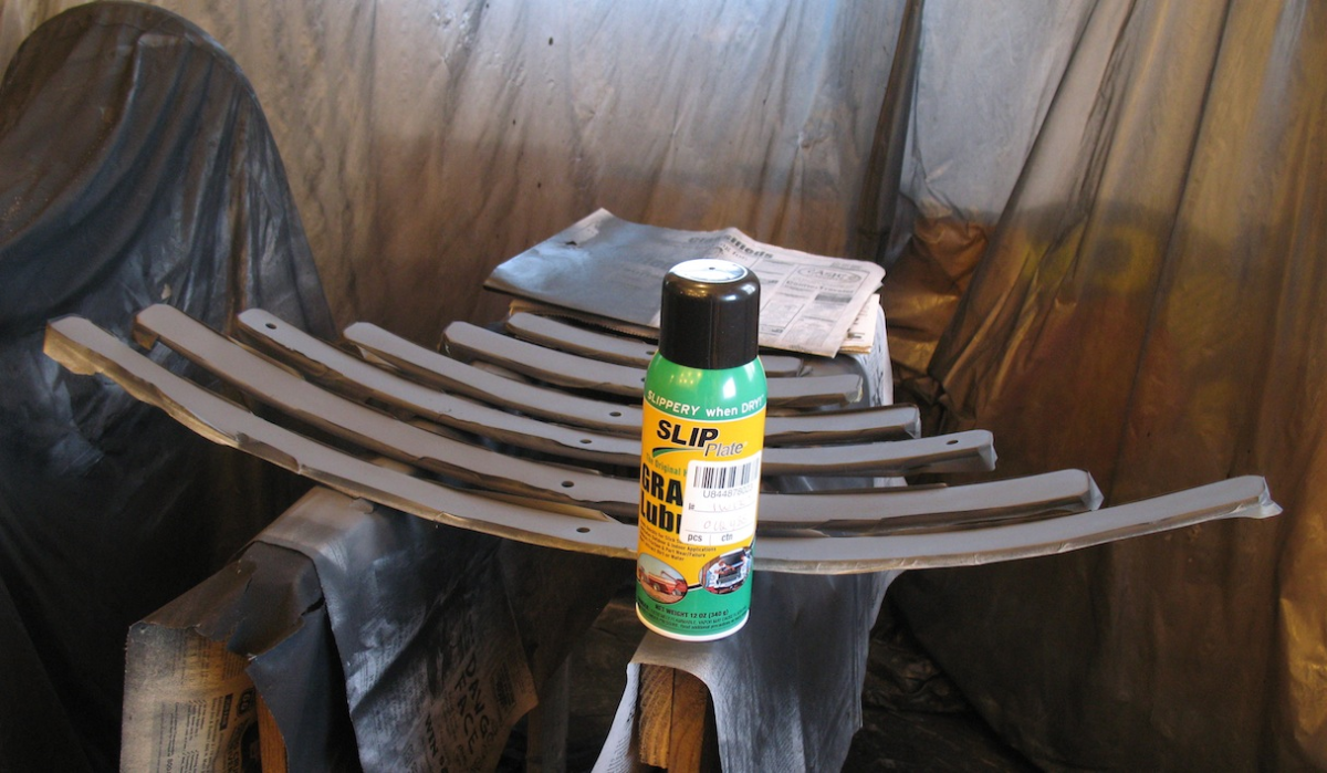

I did both sides and the whole length of the rear spring on my Model A last year and it has become a lot more sensitive although it is starting to settle. That advice might hold water. One thing I would not do is use grease or oil as lubrication as it attracts dirt. The exception being if you have a spring cover. I would use SLIP plate. Works like a charm.

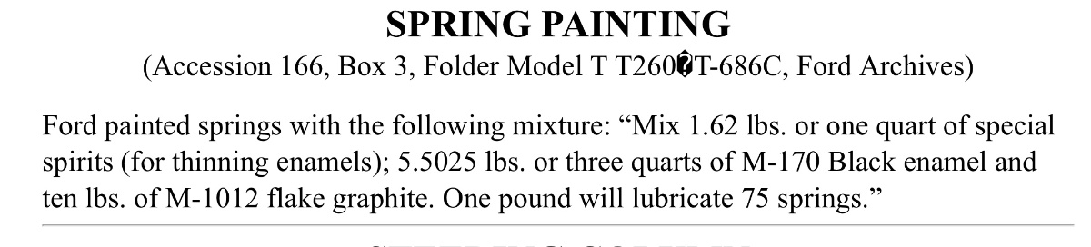

The factory used graphite flakes in a thinned black paint and each leaf covered the full length. Surviving leafs pulled apart will still retain some of that dry sheen.
Modern graphite paint like Slip paint and Easy Glide is a good substitute for such a dry lubricant .

I did my rear springs last year with slip plate. Just took apart the front and did those. Definitely a improvement in overall ride.

There are many discussions on this subject: I'd say the recommended way is to use brush SLIP-Plate, EZ-Slide or similar product especially since you have them apart. Painting is done after assembly http://www.mtfca.com/discus/messages/599638/607785.html

McKay graphite spray. One can is about $9. NAPA has it. Easy spray on the underside of the leafs. It feels like a hard coating. Drys in minutes. Doesnt easily rub off.
After grinding out the worn areas, prime leafs with flat black spray paint. use the graphite. (3 coats) Assemble the spring & finish paint semi gloss black rustoleum.
Do not prime with grey primer.

Either should do the job nicely, or you can make your own. Did that years ago, messy but worked! Thinned black enamel and stirred in graphite powder from a tube labeled for key lock cylinders.
