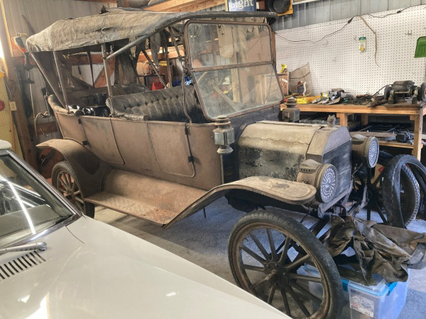

I maybe able to help on a few things. I have what I believe is a mostly all original early 1914 Touring. Paint is pretty much gone from most of the body but most brackets and hardware I could look to see if they have paint or traces of paint.

Doug Flick, that is the most delightful '14. I would love to see other photos.

There was a previous post someone started back in October of 2020 that has a few pictures of the car right before I bought it.
Search "all original 1913 touring for sale"
viewtopic.php?f=5&t=16519&p=125238&hili ... nd#p125238

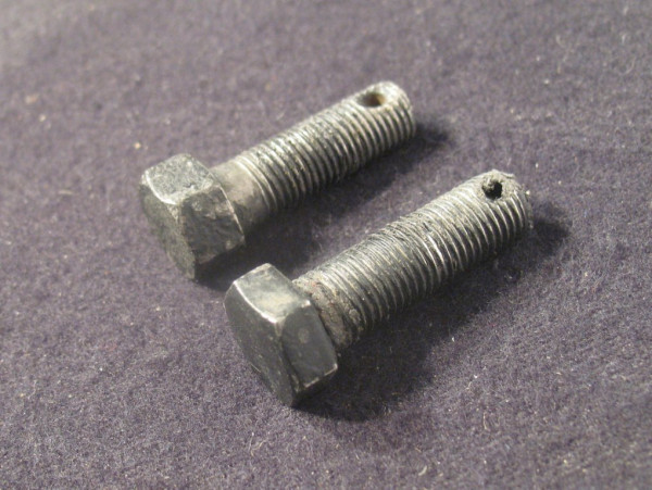

If you want to be absolutely correct and original, you need to use original bolts.
Not having many original bolts, I have ground and buffed the markings off modern bolts and drilled them for cotters. Looking at an original and a modern together, the difference is obvious. But would a judge at a car show notice or care about modern bolts on a 1914? I doubt it.

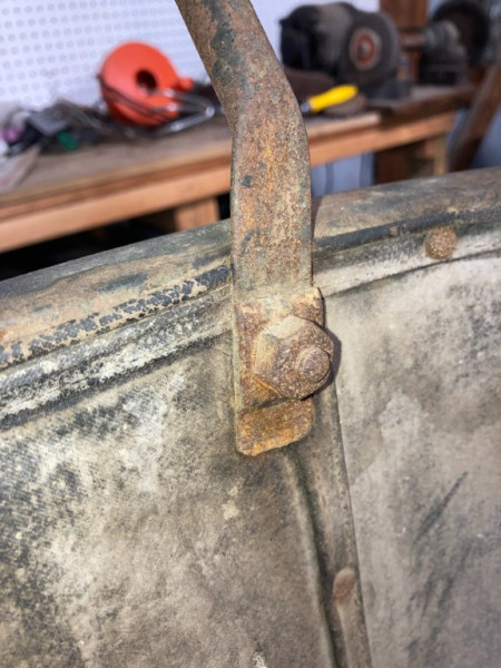

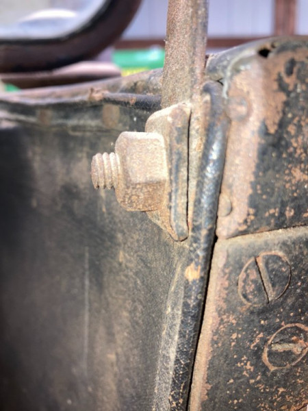

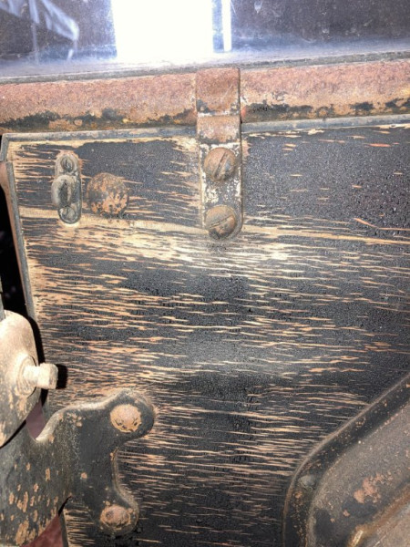

Windshield mounting brackets and hardware appear to be painted black steel on mine. You can see black paint and a magnet sticks.

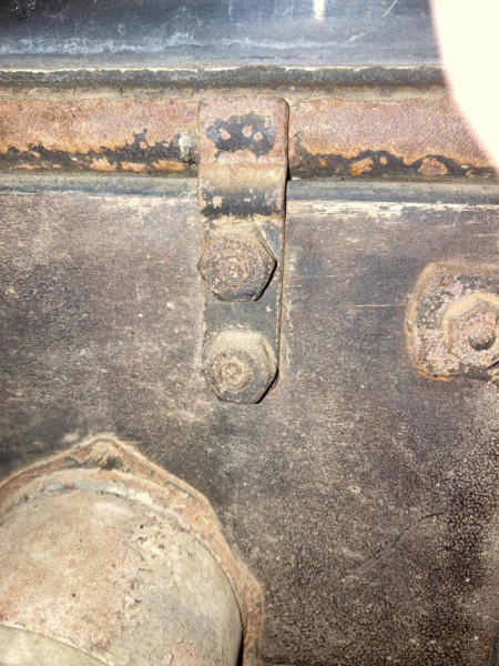

Does your W/S support arms have a square clamping plate where it attaches to the body? Picture?
What a beautiful patina T!! It dont get any better. Back in the 60's this gem would get an automatic amateur restoration, destroying all this original character. Fortunately we live in a more enlightened age. Barn finds are respected.

Top picture is passenger side, bottom is driver side.

Beautiful. This T is worthy of a complete foto spread documenting it's originality. Could it be another Rip Van Winkle?

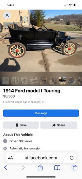

Saw this on Facebook Marketplace. 1914 Touring for sale in Indiana. Has all the bows and windshield components, brackets etc. It would be a project to complete but from pictures it looks mostly there. Is it worth $8,500? I have no idea just passing this along and have nothing to do with whomever is selling this car.

Is it worth $8,500?
It's impossible to tell from one crappy little phone picture, but probably so.
Bryan, the book they're talking about is Bruce McCalley's Model T Encyclopedia. There's a very abbreviated version of it on this website, but the best fifty bucks you can spend on a Model T is the full version on flash drive with lots of extras.

Steve, you are absolutely right regarding that FB 1914.
From the limited pictures I do see it has a riveted rear end, a non starter engine and looks like right carbide lights and coil box but am no expert. Could be a non authentic “Bitsa” car as you call them. Very difficult to tell without viewing in person. Clearly needs paint, upholstery,top,tires, mechanicals etc. beyond that ??
For someone looking for a brass era T restoration project and live in general area, might be worth a look see.

According to today's classifieds, this car is already sold.J Sundstrom wrote: ↑Thu Apr 14, 2022 7:48 pmSaw this on Facebook Marketplace. 1914 Touring for sale in Indiana. Has all the bows and windshield components, brackets etc. It would be a project to complete but from pictures it looks mostly there. Is it worth $8,500? I have no idea just passing this along and have nothing to do with whomever is selling this car.
