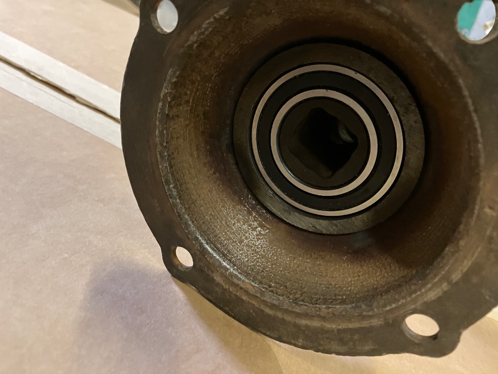

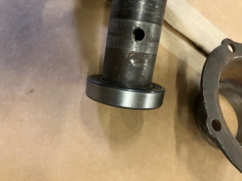

I make my own. The bearing is a light press fit on the shaft and a close slip fit in the housing.
With my design the torque tube does NOT need trimming

Further to Gene’s comments about alignment, the floating transmission shaft reduces the risks. Unfortunately I no longer offer it.
- Posts: 5248
Re: 4th main bearing replacement
Very good Les. Your method takes away my objections with what is commercially available. I may build one myself.Les Schubert wrote: ↑Sun Apr 17, 2022 2:31 pm09765546-720B-4DF1-8B3B-2BB733D39CB9.jpeg
With my design the torque tube does NOT need trimming CF205C2F-1768-4DFE-9BE1-C9CADD03D17F.jpeg

Les,
Could you show us more design detail and bearing number?
