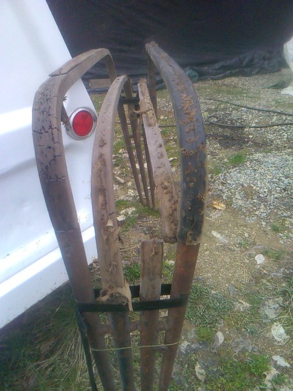

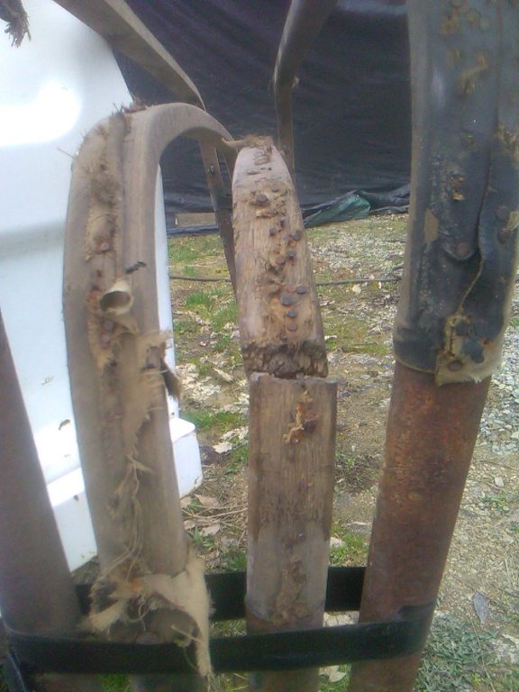

My 2nd wooden bow is broken off at the 90 degree turn for the top on my 1916 Touring, it is the only one that is broken. How do I repair it?

Photos would help...
Re: repair a bow
Would this fix work on yours?
https://mtfca.com/phpBB3/viewtopic.php?t=12830&p=96088
I can't visualize where your break is.

One method is to cut a slot in both pieces and the shave a dowl to fit the slot and glue in it in as you fit the two pieces together using more tite bound wood glue. Soak both halves with MinWax wood solution.

I think you need some new top bows. What isn't broken yet, soon will be. That bow on the left is especially bad, and in some ways, worse than the one that's broken in two. I don't believe any of them will hold tacks or staples. Sorry...
- Posts: 5281
Re: repair a bow
I gotta agree. Why put a top on a poor base?

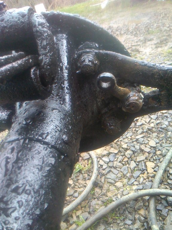

I pulled all 4 wheels to inspect the componates. I found 2 bad wheel bearings in the front that need replaced and still looking at the front. As for the rear I noticed where the emergency brake rod connects to the rear, the part that connects to the brake shoe, is very loose, has a lot of play, what parts do I need to purchase to tighten this up? How do I remove the worn parts? I looked in the service manual and cannot figure out the nane of the part or how to replace it. I have enclosed a picture, I hope my question makes scene.

You didn't mention which bearings were bad. Those in the know suggest replacing the races at the same time.
Regarding the rear brake lever - If it's just a worn bushing, this might be what you want [ Model T Hub brake cam bushing Item Number : 2559 from Lang's Old Car parts -$2.25 ea] [Brake cam lever pin, set of 2- Item Number : 2563B $0.50 pair] - The pin holds the lever on the shaft - remove the shaft and you can get at the bushing. If the lever or brake cam is bad you can replace them too.
here's a link to the brake parts page in their online catalog <https://www.modeltford.com/model-t-parts/brakes/> -------
Snyders <https://www.snydersantiqueauto.com/subg ... ?cat=41819> is another good source.

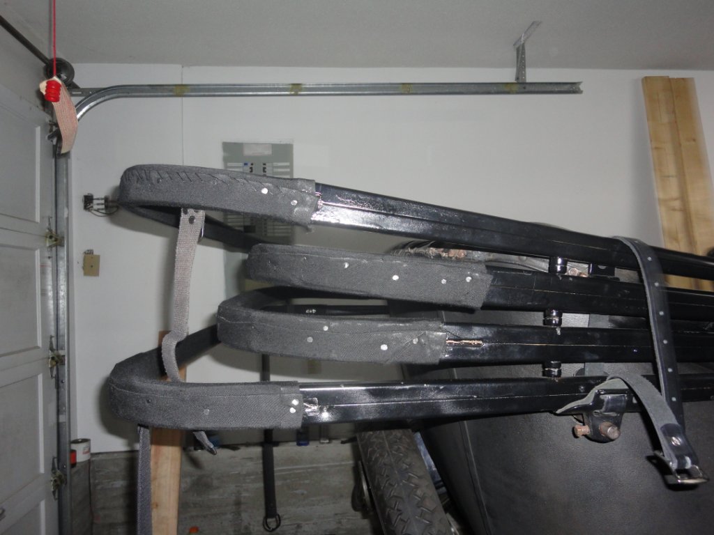

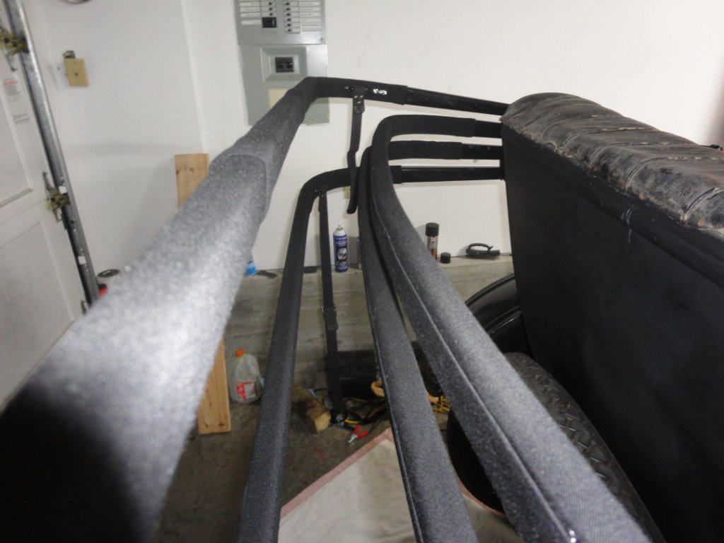

I'm just finishing-up the install of a new top on my dad's 1917 touring. It's the same as your 1916 touring except the rear curtain is three-window instead of a single "tombstone" window.
If you buy all new bows, whatever you do be sure to keep shim that is currently on the original rear bow and install it on the new rear bow. If the shim cannot be re-used, I believe Jon Anderson above sells replacements. The shim is something that is missing on many tops and, if not installed, it makes the rear bow look sway-backed
Note that the factory radiuses on the front bow differs from the second through fourth bows. Also, a factory front bow has no crown while the second through fourth bows have a slight crown. It is my understanding that the bow sets sold by the vendors all have the same radiuses regardless of bow number and that can cause some problems with top installation. I don't know if the reproduction bows have the proper crown for the second through fourth bow. I believe that Jon Anderson makes his bows per the factory drawings so the respective radiuses and crowns should be correct.
