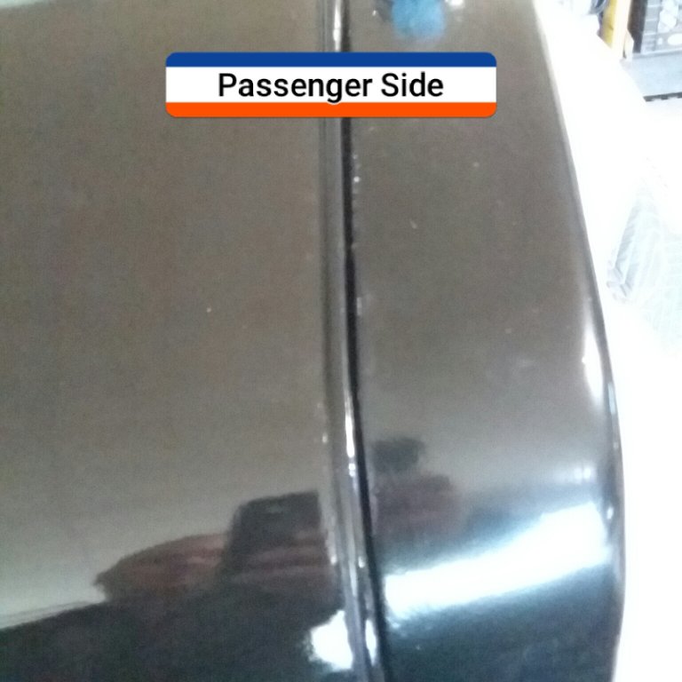

Any ideas? My hood on my '26 sits nicely on the cowl and passenger side at the radiator shell. The drivers side at the radiator shell has a big gap.
Any ideas on how to fix or improve and lessen gap?
Can't shift it at all due to hoses, support rod, and the 2 bolts at the frame still attached.

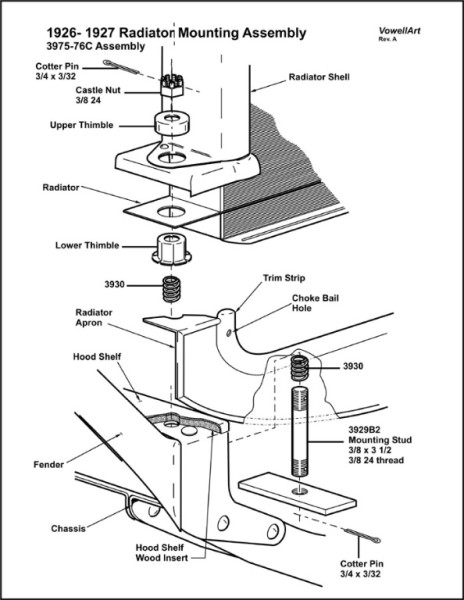

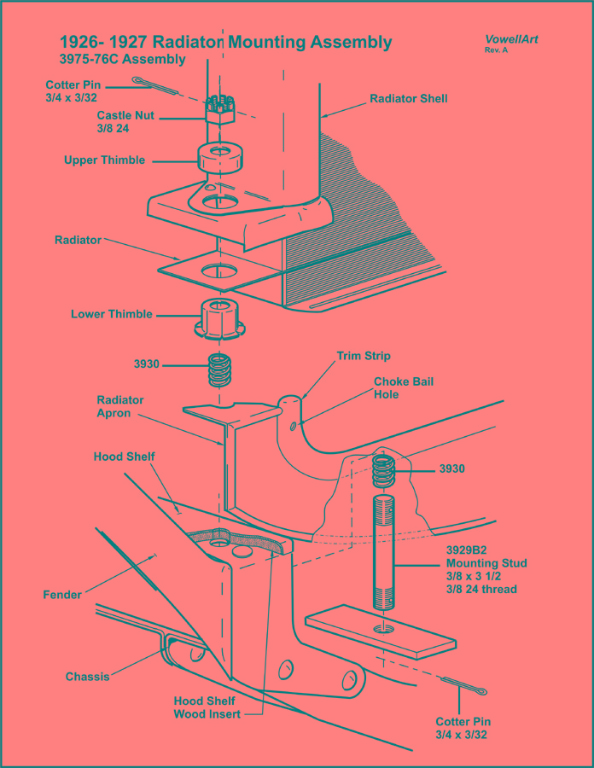

Have you tried adjusted the spring loaded studs at the base of the radiator? If you tighten on one side or loosen on the other side, you will move the center of the radiator toward the side you tighten and away from the side you loosen. after you get it centered with the cowl, you can adjust the radiator support rod or lengthen or loosen to get the top of the radiator in line. You you should loosen the hoses as you do it because they might also need to be moved in or out as well. Other possible but much harder to correct would be a bent frame. Usually the frame sags on the passenger side due to torque of the engine and also torque in same direction when braking with transmission brake. If this is minor, you can use part of an old tire casing to shim it up on whichever side the frame sags,or a thicker wood block. In more severe cases you would need to straighten the frame. If you do shim it you might also have to shim the body blocks along the sides in order to get the doors to fit right. Takes some experimenting but can be done. Other less likely cause would crooked radiator. You would need a radiator shop to fix that or replace the radiator.

Unless holes have been elongated, there is no wriggle room at the frame. The frame hole is 3/8", the hole in the thimble is 3/8", the hole in the cap on top is 3/8" and the stud is 3/8". The top hat is a neat fit in the foot on the shell, so there is nowhere for things to move, other than any slack in the lot. Things will sit where they want to.
You may be able to grab a bit of twist in the top of the shell by working with the mounting screw at the side top. This may help to negate the the twist you noticed when fitting the shell.
Be aware that getting the top nicely aligned does not guarantee the two side panels will fit. That needs to be taken into account while you are working. Adjusting the height of the radiator by loading one side more than the other will affect the alignment of the edges of the side panels.
Most times there is a need to compromise somewhere, so achieving s perfect fit is often not going to happen.

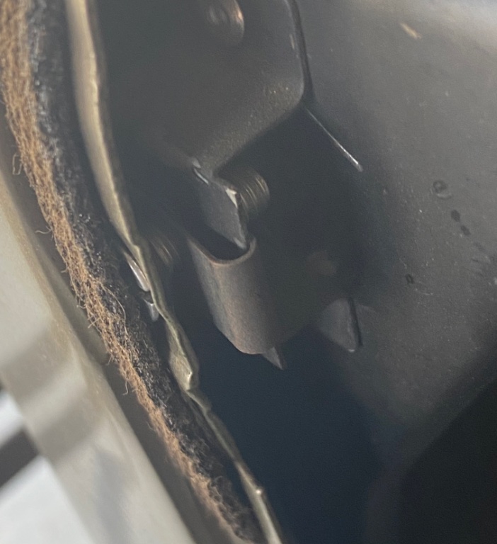

Would lack of side screws on the shell at the curve be a contributor? I can't remember if I installed them. The set, one on each side under the chafe strip. I can't recall if I put them in or not. Gotta check.

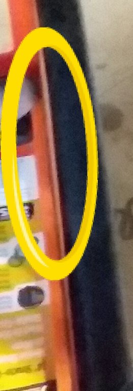

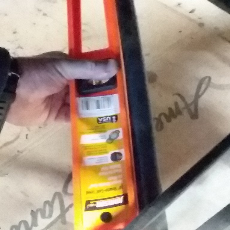

If you "gottsta know" about the square of the radiator, you could use a flat plate just larger than the radiator.(like plywood). See if the radiator contacts all 4 corners of the plate. If not, its got a twist. Verified.

I have the plywood. You've peaked my curiosity!

Dan, the lack of side screws will allow the shell to sit where it is comfortable. Given the damage to a side panel shown in your previous post, there may be some tension/misalignment in the shell. Fit the screws and check it out. You may be able to finesse the fit a little by using the screws to hold the shell in a slightly different position from front to back.

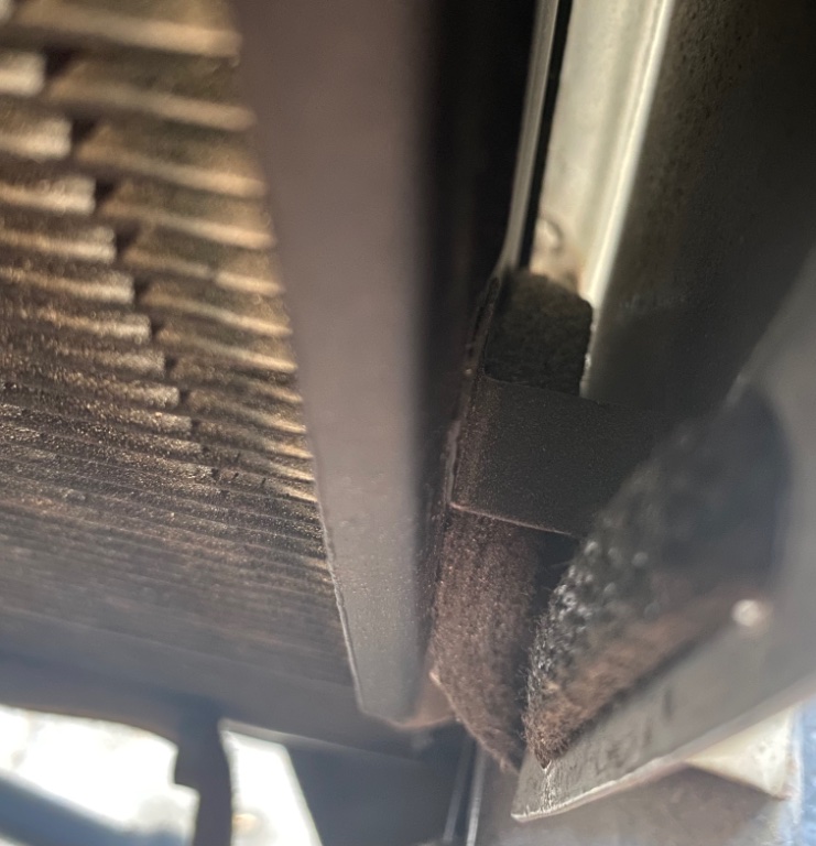

One way to temporarily hide the problem would be to put some black plastic electrical tape on the hood welt on that side. That shiny black tape would make the defect less noticeable. Then If you can find someone with the same year car who would be kind enough to loan you his hood, try it on your car and see if it fits better. Then you will know for sure whether the problem is in the hood itself and you can look for a better one at swap meets. Also the same with the radiator shell if you can find a good one.

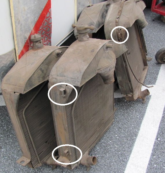

I looked for where the side screws go and don't see where they fasten thru to the BW radiator.
U guys have a picture of where they go?
And what damage to put black tape on do you refer to?

Not sure what '26 High Brass Works radiator you purchased but their photo's show a bracket on the lower portion. Berg has on the upper edge. Looks like an original had upper & lower on a highProfessor Fate wrote: ↑Tue Apr 19, 2022 9:03 amI looked for where the side screws go and don't see where they fasten thru to the BW radiator.

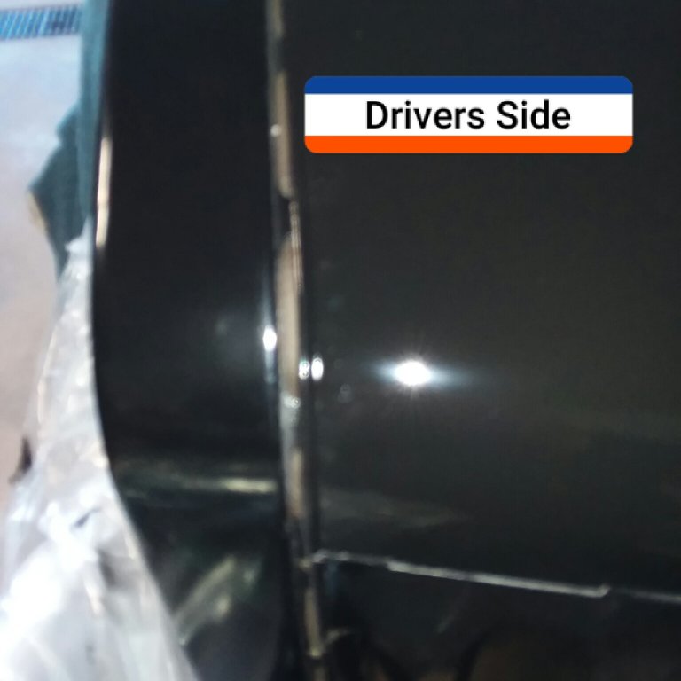

I have the same problem with one side fitting flush and a big gap on the other. I've suspected but now I'm sure my hood is a reproduction. When you completely open the sides individually and compare, the sides do not match. Solution? buy a new "well made" hood.

Dan - the BW radiator for my ‘26 came with the bottom stand-offs already soldered onto the radiator and the top ones - where the screw attaches - loose with pop rivets in the bag with the petcock.

The hood lace is the fiber material which loops through the radiator shell on which the hood rests. It is kind of a gray color. It shows through the gap which is quite obvious in your picture. Some black plastic electrical tape over that would blend in with the black paint and make it less visible. Most of the time you open the passenger side of the hood to turn on or off the gas and add oil or look at the carburetor. You only need to open the drivers side when you lube the steering bracket or check the coils, so it would not be disturbed as often on that side. Just a temporary disguise until you can solve the actual problem.

I did some measuring last night...
Drivers side frame rail or radiator sticks out ahead of passenger side by 1/16th-1/8th of an inch. Going out to further investigate... not sure which it is yet.

You might be able to get by elongating the bad hole.
Depends on your skill level & equipment.
- Posts: 7262
Re: Hood Gap
That'll do it! A mig weld will introduce less heat. It doesn't need to be well finished. I'd elongate the hole first, and add just enough weld to keep the top hat where it needs to be. This might mean just two or three welds to keep it in place. The weld does not need to be continuous.
Hope this helps.
Hope this helps.

After seeing the repro hood pics posted earlier, I think the hood I have is also. It has the tell tale bulges and warps as seen and noted in the post.
So I have multiple things at work here, making it difficult and challenging to say the least.

Am I missing something? if the large hole in the steel member through the lower section of the core is not central, the radiator cannot sit squarely. From the photo, the shell appears to have a gap down the left side. If this is the case, and the hole in the plate is off-set to the back of the plate, then there is the answer. Centralising the hole will bring that side of the radiator back, closing the gap.
I have had occasion to deliberately offset one of those large holes to get a good fit with a nickel plated brass 26-7 shell. Having the hood sit correctly on those is essential. How many such shells have been worn right through due to ill fitting hoods?

Discovery...
Late breaking investigation discovery.....
I have a bent passenger side wishbone. See pic.
Will this will pull the passenger side frame back and push the drivers side forward. U think this is at least a contributor?
Gap on wishbone bend is proud of 1/4 in.

- Posts: 2842
- First Name: Dallas
- Last Name: Landers
- Location: N.E. Indiana
Re: Hood Gap
Check the axle also. The 27 tudor I worked on had a bent wishbone and wheelbase measured 1 inch difference side to side. Axle was bent. I assume from hit on front wheel.

A bent wishbone or axle would in itself not distort the frame, however the same thing which bent them could cause a tweak in the frame by pushing back on the same side where the spring is attached. Check diagonally from one point on the front of one side of the frame to a point at the other side toward the back of the frame. Then check diagonally in the opposite direction. If one measurement is longer than the other, your frame is bent. These bends can also cause the engine to be out of line at the rear and the steering to pull to one side while going forward.

Just saw you're looking for a new wish-bone. As in this one cannot be fixed? Suit yourself, but you might want to pass it along to someone who actually has a damaged part.
A little bit of math will show that the 1/4" bow did not shorten the length of anything beyond normal tolerance, and it is not distorted or weakened to where it cannot easily be put right.

Put the car on the floor and off jackstands. Loosened the body from the frame and loosened up the radiator and rod. Moved body around and was able to reduce gap but not eliminate. But much improved. Doors close and open nicely.
Thanks for all the help.

Have you tried loosing or tightening the nuts which hold the radiator to the front of the frame? Sometimes if you increase the spring tension on one side and decrease it on the other side, it will tilt the front of the radiator to equalize the gap in the hood.
Professor Fate
Topic author - Posts: 773
- Last Name: S
- Location: Taxachusetts
Re: Hood Gap
Hi Norm. Yes I did try that. It helped a little. Was part of the sum of changes made that improved the situation.
Thank you for advice. Much appreciated.
