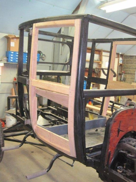

A friend has a DR's coupe. The doors sag Quite a bit, wood in the body seems to be good, will replacing the wood in the doors solve the issue? Or is it a re-wood the hole body thing?
Thanks. Craig.

Some pictures would really help showing the issue. Otherwise, any advice is a guess.

The coupe is a 22. Pics pending.
Craig.
