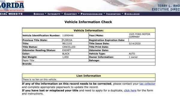

My state of FL allows lookup if you know the VIN or title #. Did that, shown below on a coupe I sold last year. No details on my name as the '1 owner'. I can promise I was not the original owner! The previous title was issued from FL, so the coupe came from the seller in FL, but I don't know, nor did he, where this T was last titled before he got it.
