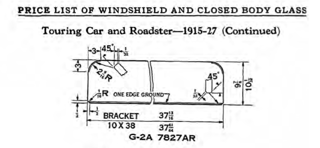

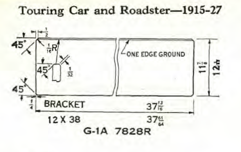

Don't waste your money. Pull the plate glass out of the frames and have a local glass shop cut safety glass to match.
From the Ford Price List of Windshield & CLosed Car Glass
