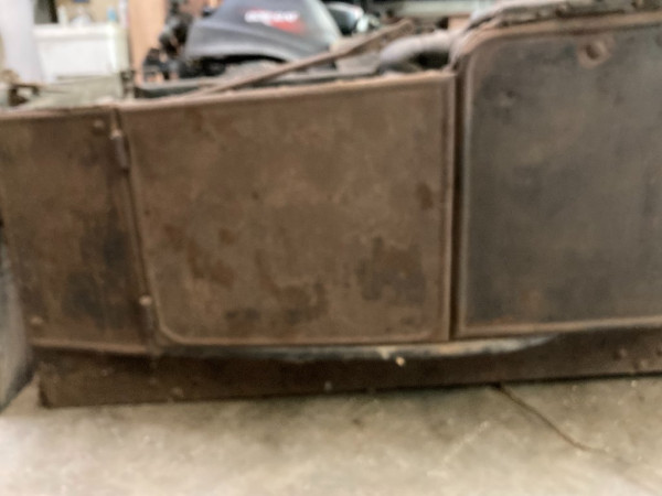

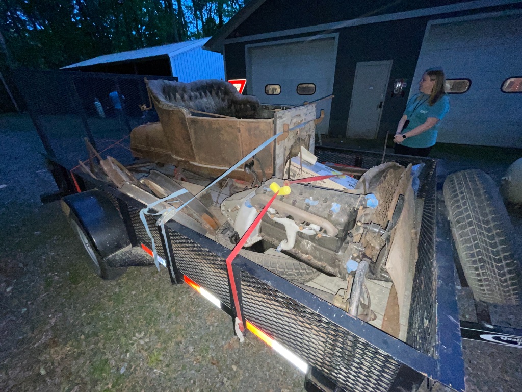

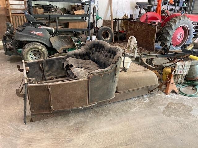

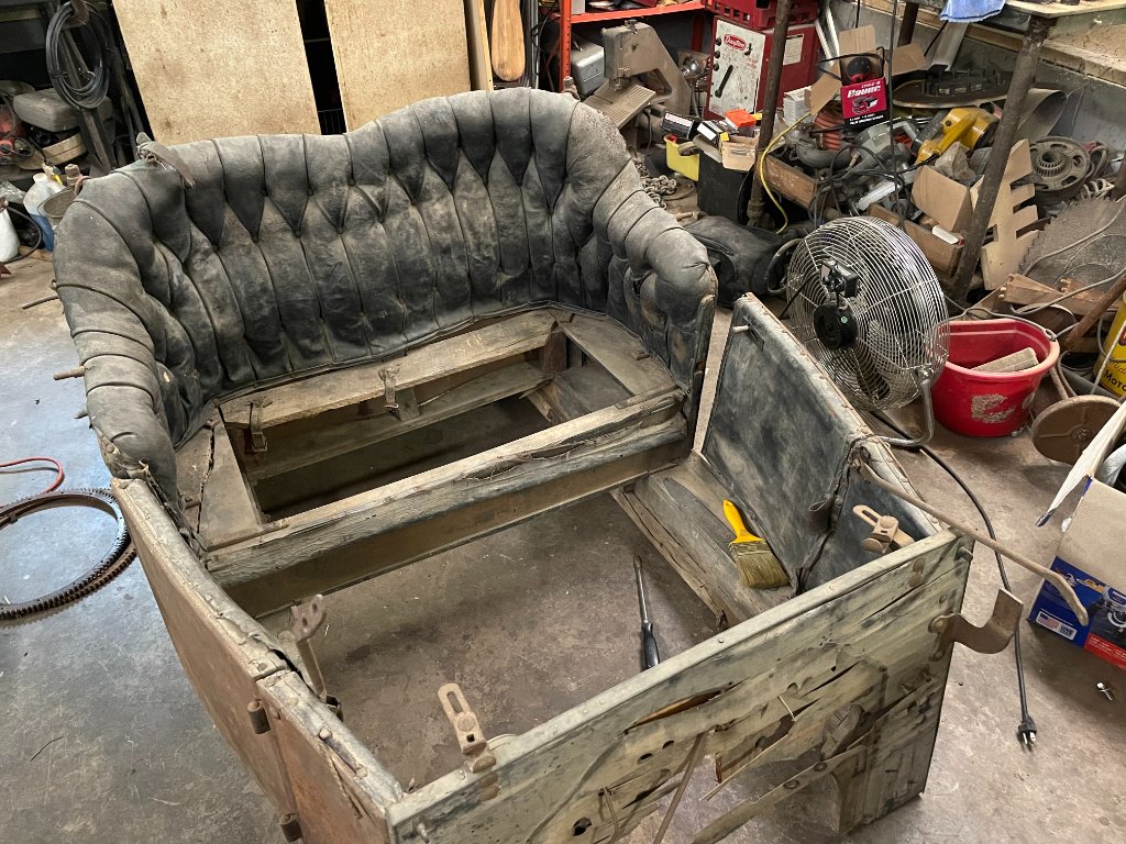

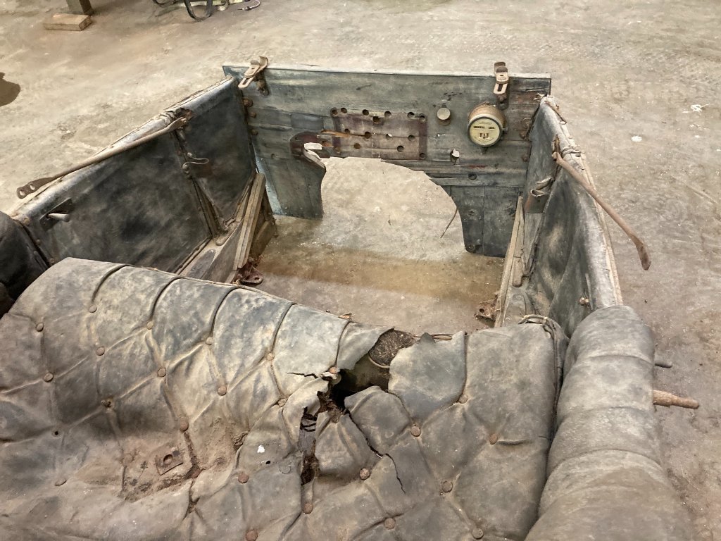

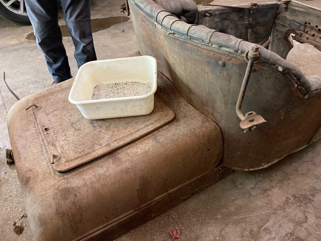

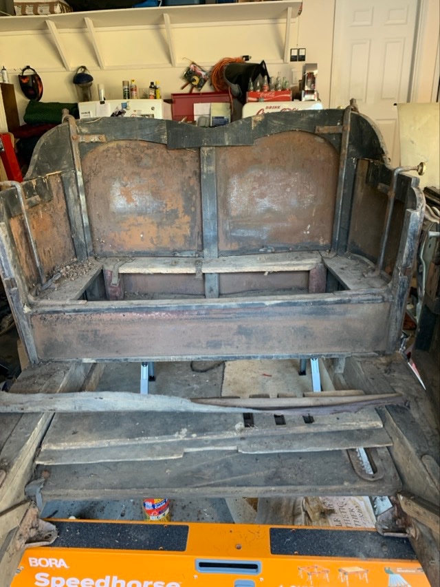

"Asking for a friend" If a fellow was to find an all original 13 runabout actual barn find what would you think the body would be worth? It has a little rust through in one corner but the wood and everything else seems solid. I'm trying to work a deal and It's taken apart. I will probably part it out. What do you guys think?
Rich P. Bingham
- Posts: 1808
- First Name: Rich
- Last Name: Bingham
- Location: Blackfoot, Idaho
Re: 1913 runabout body
"All original barn find" . . . But it's taken apart ? That is, it's a pile of wood and tin with some rust-out. Pictures would help, as usual, it's worth whatever someone is willing to pay for it. Is the turtle deck with it ?
I'm intrigued, one source claims there were no more than 1400 or so runabout bodied Ts sold for 1913, but there seem to be a lot of survivors for that low production number. I own one.
notice the shelf in the back ground and the frame behind it. It was the same story, Old man found it, wanted to restore it and died. It's all there.
I’m no expert, but it looks earlier than a ‘13 to me.
- Posts: 5591
That looks more like a '12 Torpedo body !
Serial number comes back to June 13
That is not a 13 runabout, it is a torpedo with a later turtle deck added. Great find!
Good guesses from the previous posts. The body is definitely not a '13 runabout, the turtle deck is a '14-'21 style with rounded corners.
Looks like a good, restorable body, it would be a shame to part it out. I have a little nagging feeling it might not even be Ford - comparisons with a '12 torpedo are in order. Thanks for showing it to us !!
Neither '11 or '12, nor Ford (with the exception of the turtle deck)
Rich is on the right path...
Regardless, SOMEONE is going to recognize it, and when the word gets out, SOMEONE is going to want it...

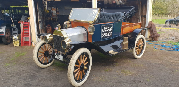

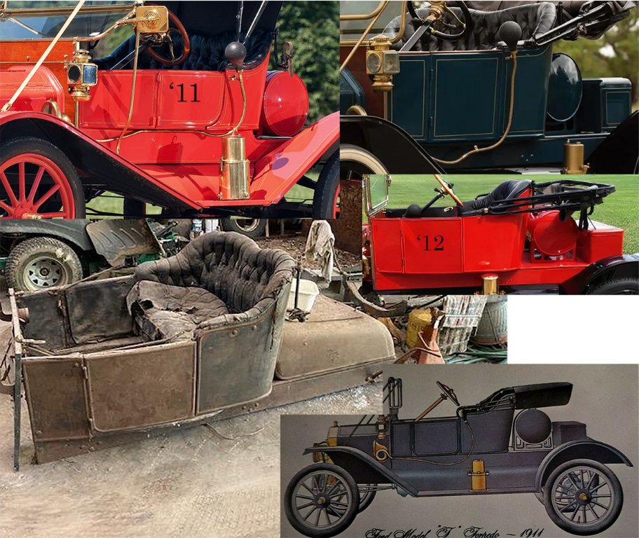

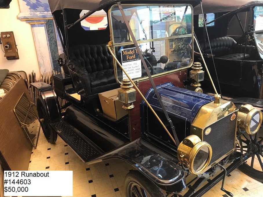

The dash and lower platform certainly look like a Ford. Could it be a prototype, '12-'13 transition or from some odd body maker? It definitely looks very old.

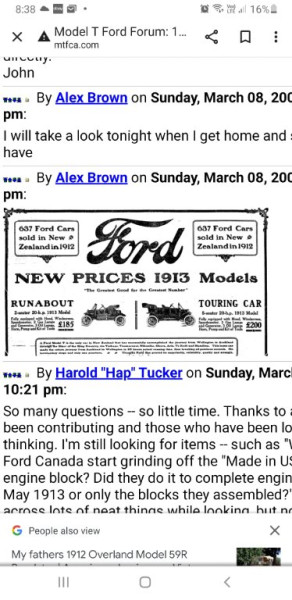

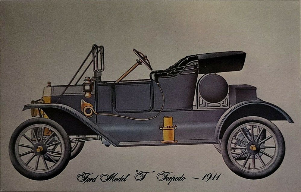

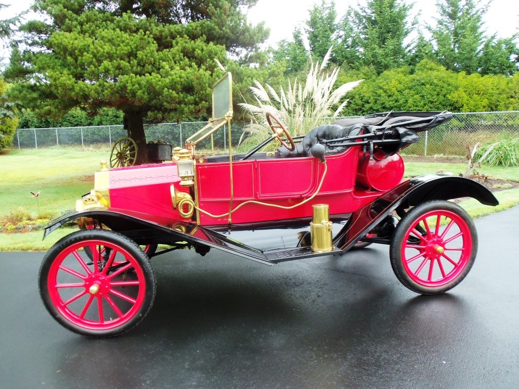

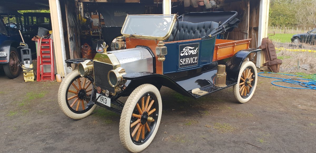

It looks a little like this illustration.

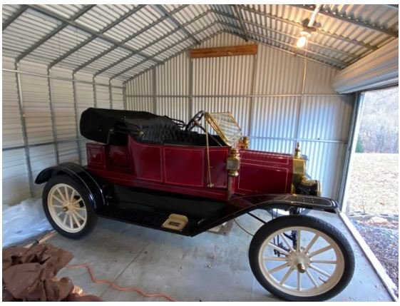

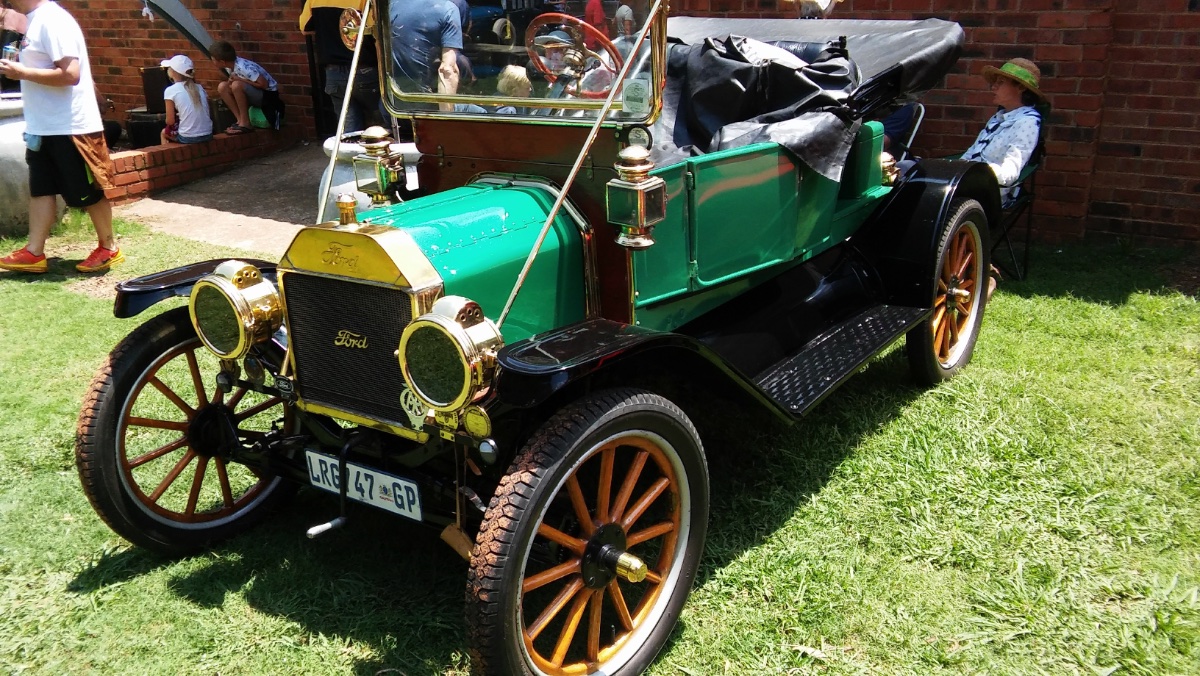

Just some views to compare with the '11 and '12 Torpedo.
1912-13 torpedo roadster, we used them here in NZ as a commercial roadster in 1913 sold new. Photo of my T as restored from an original
It's definitely model T, as body chassis bracket bolts say it all, just slightly different with curve in bottom of door, bolts at top of quarter panels are possibly for windshield support like mine. Just a thought

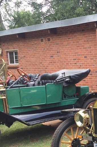

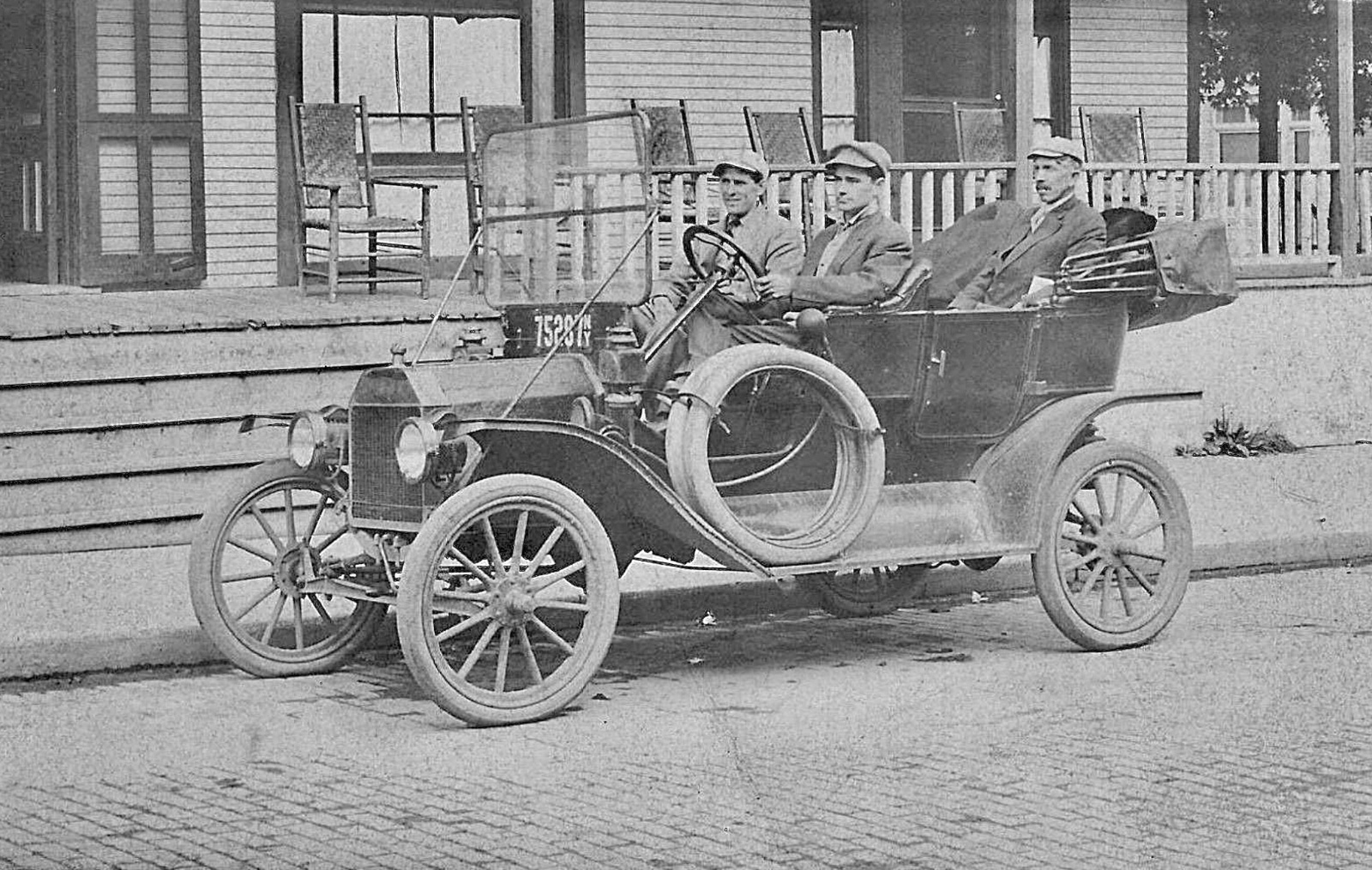

A couple good looks at original photos of 1912 T torpedo roadsters. (one has a weird trunk?)
Not sure what the OP body is? Could be as simple as one of the odd body suppliers made a few with that odd curve at the bottom of the door? Or? Not an open roadster with after-market doors, the open roadster's seat has a rounded top corner whereas this body has a straight and square front edge as most 1912 torpedo roadsters had. I just looked at about twenty era photos. These three showed the side of the seat and door best.
First, the door on the original post looks to be too tall for any torpedo. Second, there is no such thing as a '13 Torpedo either. Just '11 and '12, biggest difference in the '12 is the longer runningboard, and that they moved the seat a bit so people could REACH the pedals!!
I'm going to find out, I just made the deal. I'll post more pictures when I get it home.
- Posts: 8641
That needs put together, not parted out.
What fun !! This is really intriguing. Thanks for the pictures, everyone. More pix of the mystery body show it definitely mated with a Ford chassis. The irons laid back at the "A pillar" position speak of a 1913 type windshield. Any road, it's not in the pattern of the "standard issue" 1912 torpedo. Could another maker have produced a body that similar ? Any clues to its provenance ? Could the original owner have bought a bare chassis and commissioned a local coach maker to "build something like this, but with . . . etc." And showed him a Ford brochure ?
If it were mine, I'd restore it how it presents, but lose the later turtle deck. What about the gas tank ? Any indication of its position ?

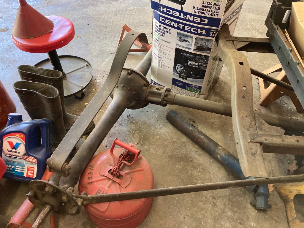

By the bye, that rear axle is much earlier than '13 - those in the know can date it.
Good luck, I hope you restore this one, or turn it complete to someone who will, whether we ever learn the full story of the "strange" body or not !!
Thanks for posting, it's stuff like this that keeps the forum lively and interesting !
Rich's color depiction of the blue "1911" Torpedo pretty much exactly copies the illustration of what Bruce McCalley refers to as the earliest catalog illustration of the 1912 Torpedo. Page 112 of his book. It would seem to me that this body is a very early '12.

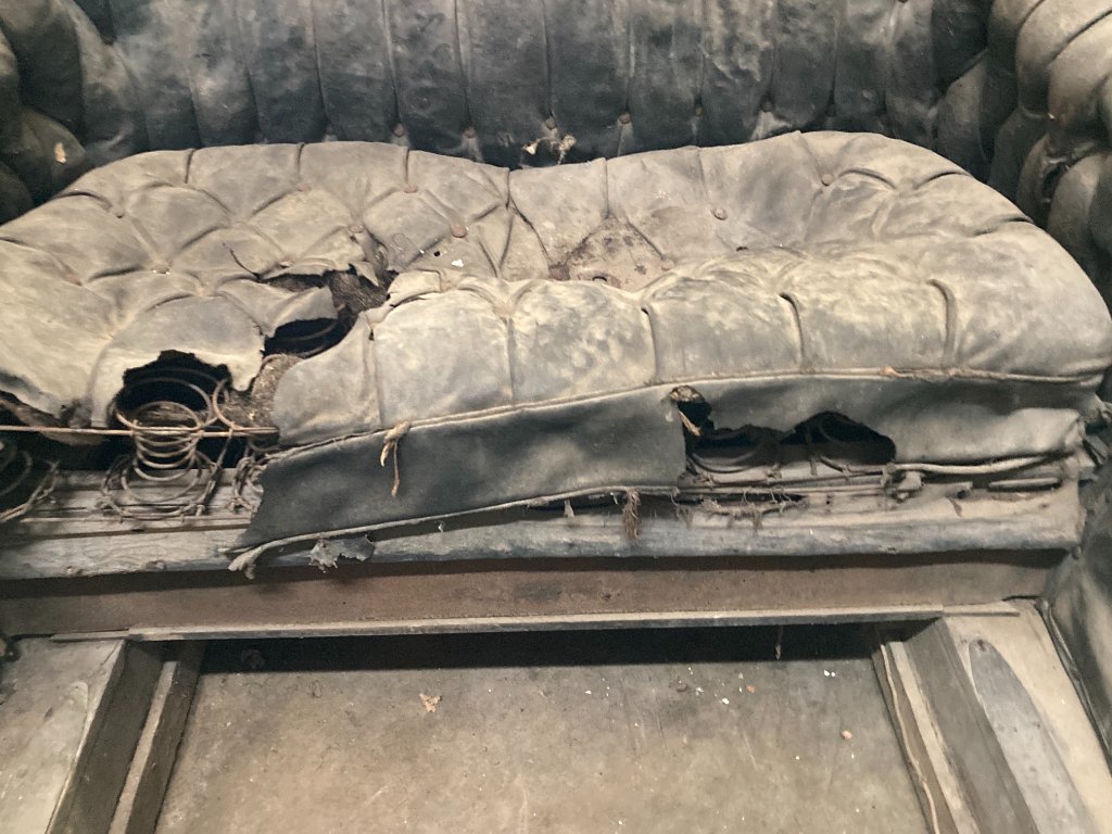

It appears to have original upholstery, and thus it most likely retains original hardware, fasteners, wood parts, etc. That's a lot more than just "parts". It looks to have very little rust for something so OLD.
FWIW the turtle deck lid handles are pre-1917. And as Rich B pointed out, looks to have '13 windshield braces. Looking a lot to be a "Frankenstein" car. Interesting nonetheless.
What about that rear crossmember?

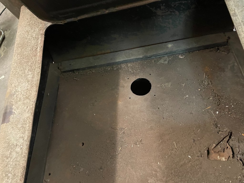

The firewall appears to be decayed plywood. Was plywood used in the early bodies? I thought plywood came into use in the 1930s/WWII era.
Don, when you get it home get that seat cushion off of the front seat frame and get some pics of the frame and the heel panel. Looking for builder initials and body number...maybe.
Pat, not plywood per se, but the dashes were laminated. As I understand it, the main cores were vertically laminated hard maple, then veneers of cherry were cross-laminated either side of the core. It's been rather problematic for restorers, as modern cabinet type plywoods are slightly different in thickness, and frankly, the modern plywoods with softwood core plies are not as robust as the originals. My '13 was an excellent restoration 20 years ago but after some 20,000 miles of touring by two former owners, the stresses from the steering column have compromised the dash. I have bolstered the column flange on the outside with a brass plate, but the dash should be replaced.

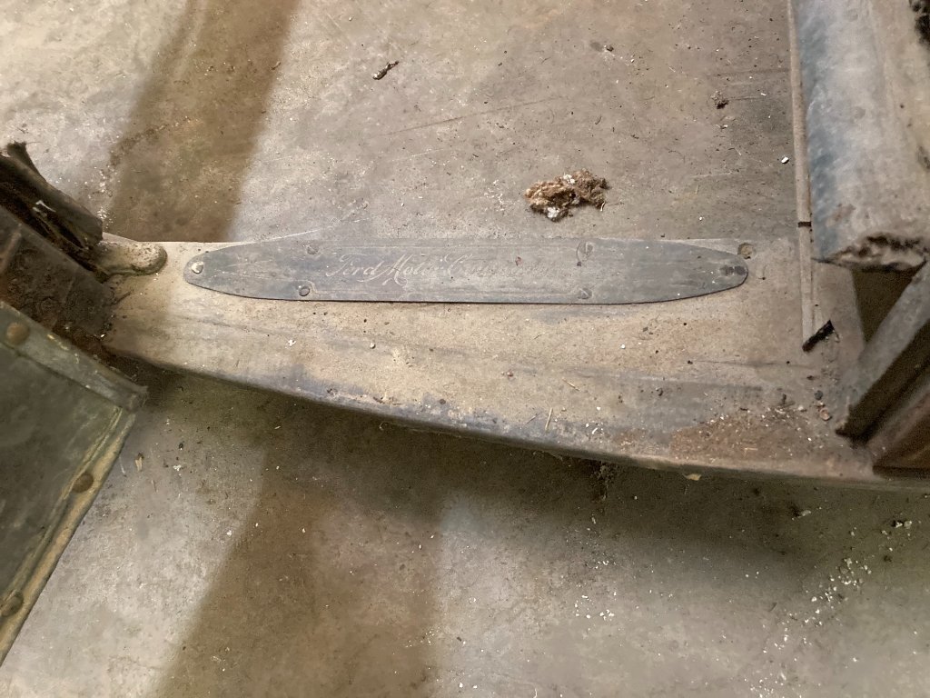

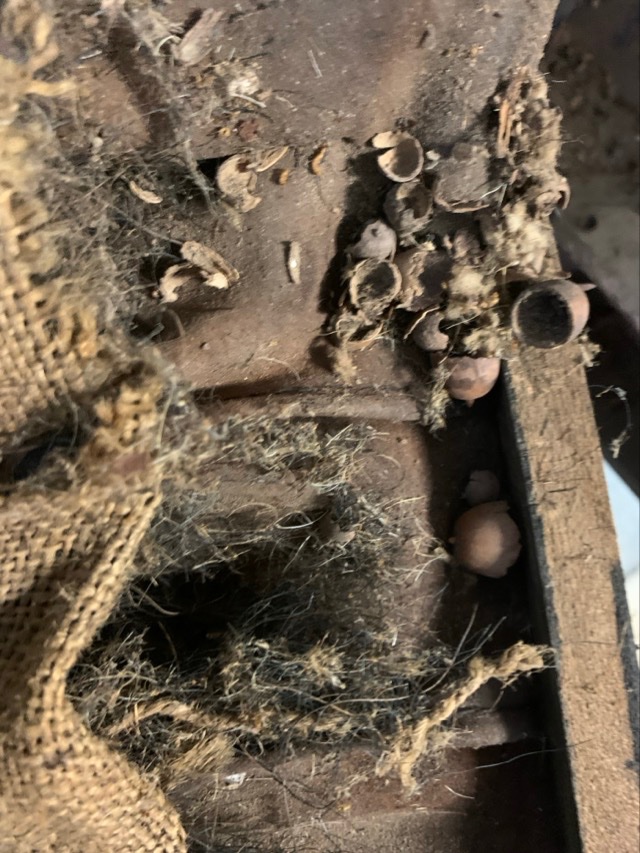

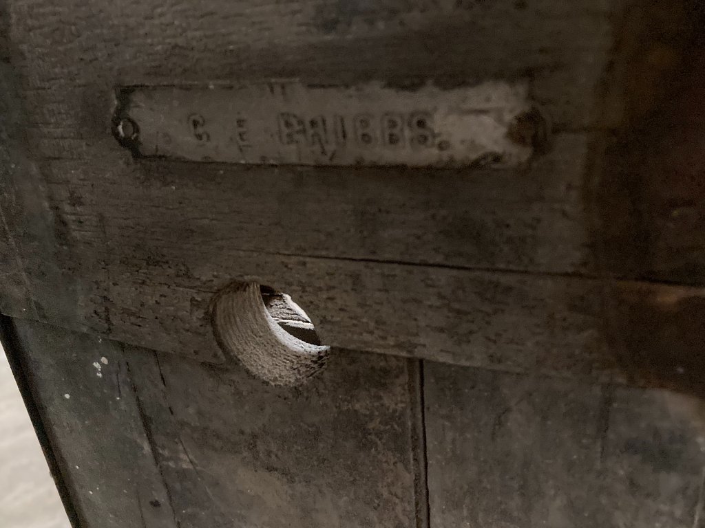

I stopped and got some more photos. I couldn't find a number under the seat or door, I had a limited amount of time and no sandpaper. The tag with a name was to the left of the steering column. It appeared to be at least dealer installed. look at the fasteners. there was also a" Torpedoish" tank on the shelf, DB front axle.
Make a list of what you need in original parts for this wonderful find. There are parts still out there and I feel that we would part with the original parts to build this find back to what it was.
Thanks for the additional pix Don ! It's a treat to see this critter ! Interesting how they coped the later turtle deck to that body.
The frame rear crossmember is correct according to Bruce, this is a June build and that crossmember started in May.
quote " Longer rear cross-member, beginning about 271,425 (May 1913), eliminating the forged body brackets." This body number starts with 289
I see a Clam shell rear end. Those rear ends were not used in 13.
Don, the number you are referencing as a body number "289xxx" is that an engine number or some other plate or tag on the body? Sorry for all of our questions but I think we are all kind of excited about your find and want to help.
It is the serial number on the fire wall
from what I can tell this is a Ford body. everything matches up to the frame and has not been altered. The one detail I have not matched to a torpedo is the shape of the rolled bead at the bottom of the door. It seems the others are square in the photos and this one is curved. I also have a gas tank on the shelf that seems to resemble a torpedo tank. I can't wait to get it o the house to figure it out.
- Posts: 5591

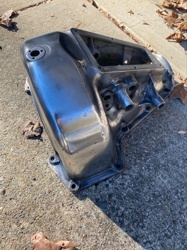

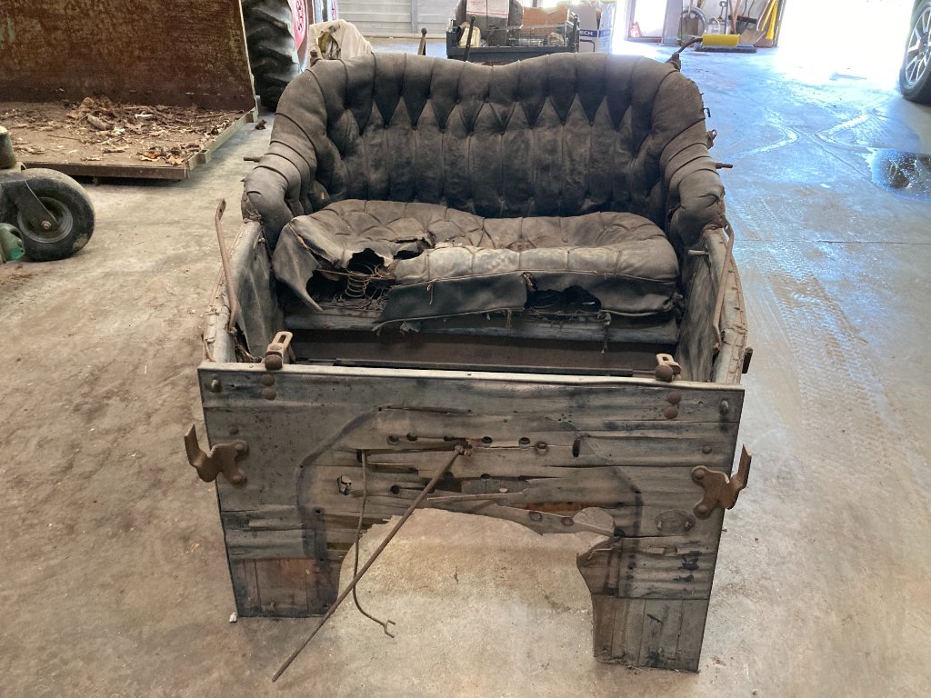

Yes - that's a Torpedo tank ! Nice score !!!
- Posts: 8641
I'd want to check the area very carefully for any and all stray parts for that vehicle.
The 1912 Torpedo tank was similar to the 1911, but it was mounted on a stand on each end. There were some oblong vertical holes in them.
- Posts: 6799
Well, I guess I need to turn in my opinion license. It does indeed appear to be Ford.
Lots of interesting things, foremost being the odd door, followed by the firewall cutout which if done by the factory, dates it to 1912 or later. The accessory windscreen adjusters on the top of the firewall are neat, too. Sill plates are '11-12...certainly not '13.
I have not even noticed the windscreen brackets, I'm starting to think 11 torpedo body put on a 13 chassis. The door matches this, even if it does look like a drawing.
- Posts: 4408
There is practically NO chance that the body and frame were original to each other. The body appears to be clearly PRE 1913, whereas the the frame is mid 1913 or later. The twelve rivet clamshell rear end is a 1912 item, so it for all practical purposes cannot be original to the frame either. The firewall could be original to either or neither the body or frame? An early 1912 would have had the lower firewall with a filler board under the windshield. However, the higher firewall showed up about New Year for 1912, and most 1912 model cars had the higher firewall. If the firewall number roughly fits June of 1913, it is very likely the firewall is not original to the body.
Remember, the number on the firewall is not the official serial number, which was at that time specified to be the engine's serial number. By 1912, engine and car numbers had drifted apart somewhat. Nearly all Fords in the early brass model T years had four serial numbers! The radiator had a serial number, the body had a body supplier's serial number, and the firewall had a serial number. Those all in addition to the engine's serial number. In the earliest production, the numbers started out close together (car-seat/firewall and the engine number often/usually matched). Then they began drifting apart. In calendar 1915, Ford stopped the firewall and radiator serial numbers, ending the confusion those numbers were causing.
The body is still odd, with the curved lower corner. A closer look might help figure it out? Maybe the door was changed? Altered? Replaced? Possible the entire body was custom made? Not likely if it has the Ford Motor Company door sill plates? Again, MAYBE it was supplied by one of the small companies Ford got bodies from for awhile when the regular suppliers were booked up to capacity. I am not an expert on who all the suppliers were, but I know there were at least five companies supplying Ford at that time. Plus several others that only did partial work such as painting and trimming.
One of the photos shared appears to be the body supplier's serial number. It appears to have a letter or two? But I can't make it it out in the photo, and don't recognize it myself.
I know people today like everything tied up nice and neat with a ribbon and a bow. But that is not how it was done originally! Henry Ford was a superman! What he did was impossible by any standards of the day before 1908! How he managed to pull it all together and pull it off boggles the mind! Every day brought problems nobody could have envisioned. Henry and the people he commanded were solving problems on the fly, every day!
The model T Ford is the ultimate icon of mass production! Fifteen million cars, all alike! No two exactly alike? Especially true in the brass era models. (Okay, it is a bit of "literary license" to say NO "two" exactly alike? But the point is?)
We may never find all the answers to this body's story. Maybe we should burn it so to not cause undue stress and confusion to people today? We really cannot restore it back to exactly how it left the factory. It has been too messed up by people over the past hundred plus years for us to ever know exactly how it was when it left the factory?
However, regardless of some oddities, it is an original era torpedo body. It appears to be in condition well worthy of restoration. I think (for whatever THAT is worth?) it should be restored. Place it on a proper 1912 frame, with a proper 1912 rear end (the one under it looks good for a start?), and use as many other 1912 parts as deemed appropriate. Definitely, replace with a proper torpedo gasoline tank! Sell off other later pieces (the mid 1913 and later frame, as well as the turtle deck/trunk).
That turtle deck/trunk isn't worth much. Funny thing to me. For my 1915 runabout, I bought a rough but solid turtle deck, figuring to spend some time to straighten it out and restore it (had to save dollars). I liked that the metal was solid, no serious rust , no thin spots. I got it to looking pretty good, and began to install it. That was when I discovered mine had been altered to fit something later. It wasn't so obvious on mine, that the lower front sides had been cut back a bit, leaving a significant gap between the front of the turtle deck and the back of the runabout seat. So I got to ruin some of my paint and extend the sides forward, then retrim to fit the back of the seat. Just a couple more hours of work. It looks great now. And at least I didn't have to reconstruct the front top edge on mine!

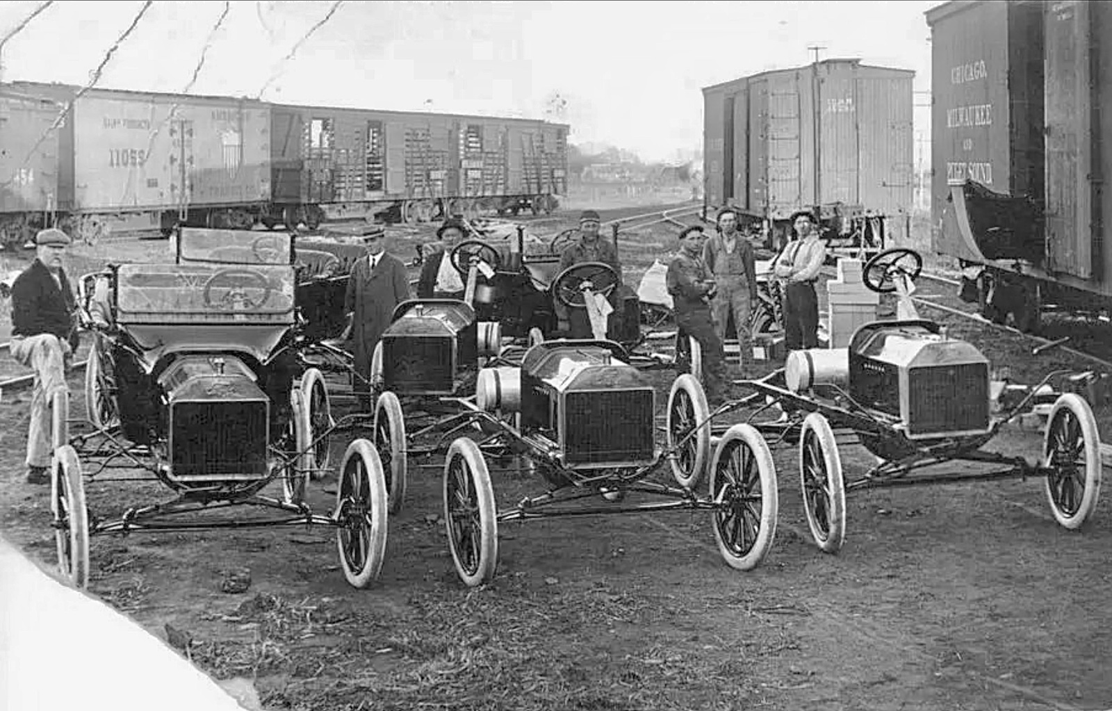

1912 Torpedo

That door matches, if that's an original 12 body I would say that's it.
Wayne I think we all agree the body didn't come with this chassis, The chassis is a mid 13. The rear axle is not and it seems the body is probably a 12 torpedo. But it is fun to try and figure out, not trying to wad up anybody's panties.

Ford used the term Torpedo well past the actual production of the true torpedos, for the roadster. Page 4 of the 1923 body parts book says Torpedo, page 7 calls it a Roadster.
- Posts: 5591
It's NOT an '11 - the front panel forward of the door is short - a true '11 panel was near as wide as the door. I have an '11 - '12 commercial runabout body under my wife's '14 Fire Chief's rig and the rear of the front seat is straight across not "dipped" which is a trademark sign for the Torpedo.
- Posts: 4408

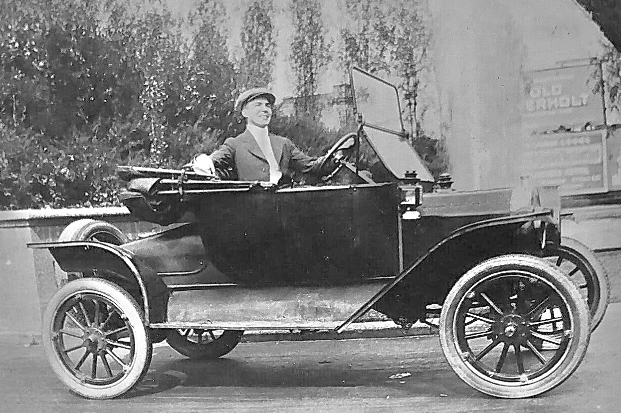

I am really pleased to see that green South African torpedo! I hadn't mentioned it earlier, but something in my brain says there was a discussion a few years ago about an era photograph showing a 1912 torpedo with that curve (trim?) on the door. I spent a bit of time looking through the era photos I have harvested from past discussions, but could not find it. I really do need to organize all that stuff. A Canadian variant is a good probability.
Regardless, I would love to see someone restore that car!
And as Steve T says. Definitely not a 1911. Everything about the 1911 is different. The seat is different, shorter in height. The door appears longer, and may be (I never had some to check the measurements?). The door clearly is much shorter in height also. The 1911 sill and platform is very different, with offsets and a much higher appearing seat platform (hence the seat that is shorter in height?). And the longer appearing front piece with more pronounced offsets from the sills.

I zoomed in on the photo and saw that the speedometer appears to be a Stewart Warner Model C which according to Russ Furstnow's Speedometer handbook, was used in 1913 production.
Interesting and potentially rare body.

Interesting to see the sediment bulb on the tank is the conventional, rather than the torpedo, type. My mid '12 production US torpedo has the same setup. I had thought mine may have been changed as a later repair, but perhaps not. I would be curious to see the door jambs and under seat compartment of this body.
Interesting project. Is the firewall drilled for a '12 or '13 style steering column? I assume the column is not present?

Would not an '11 Torpedo roadster have butterfly rear fender iorns on it? The original photo appears to me to have a single rod for the fender support.
I vote 1912.
I vote 1912.

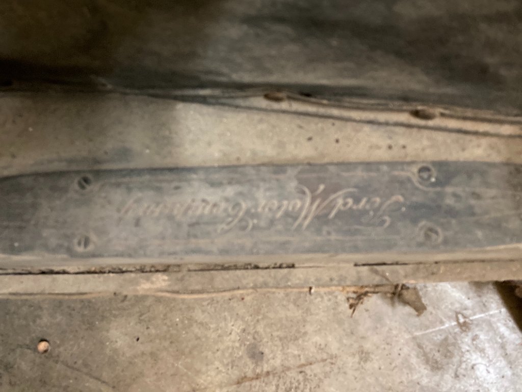

I believe that the sill plates are the style mostly associated with the 1911 model year. I willodify my vote to an early 12 or late 11.

A great find! Without question the body is a 1912 torpedo. Sill plates are correct and the dash is also likely original to this body.It looks like the patent plate is still in place above the steering column hole so the car number might be there for you. This will not match the engine number but the offset can be extrapolated from other surviving 1912 cars. During the cars active life an aftermarket windshield brace arrangement was added to delete the cumbersome forward mounted brace rods in favor of rear leaning type and universal fit dash brackets. The tank and tool box were cast off and replaced with a 1914 or later trunk. The tank with the car is correct for 1912 torpedo but could not have been used with the later turtle deck so a custom tank must have been fabricated to fit inside the turtle since a torpedo body has no room for a tank below the seat. What i dont see is the 1912 only tool box and tank brackets. They are out there but tough to find. The tool box uses two brass locks with grip handles built into them. I would not expect that speedometer on a car of this era. Worth a look beneath it to see if other holes for a model 24 are there. You have the 1912 rear axle which is also very hard to find. The frame shown is not a match for 1912 and the rear fender irons shown are also later style. 1912 torpedo used a unique rear fender iron and an unusual curved rear fender not seen on the other 1912 models. Well worth the effort to bring this car back if you can find the motor for it.

Herb I think you’re right though I keep looking at the space between the seat and the firewall which looks more like an 11 torpedo than a 12 plus look at the distance from the door jam to the curve in the back, it’s longer than a 12. Wasn’t the seat higher on the 12 too. From the pictures that seat is low. Wonder how long the column is? Does it have Bakelite knobs or flatten handles on spark & throttle. I’m not sure but a regular 12 column would be too short as it appears to me. I wonder how long the hood is. The 12 rivet clam shell was used in late 11 around July. Also if you zoom in on the fuel Tank you can make out another tank that has the 11 style strap, my eyes may be playing tricks on me though. What a great project. I’ve got a spare 12 engine if someone decides to tackle a light restoration.

The steering column has the cast base with the offset lower bolt hole it also has the flattened ends not knobs. I see it on the shelf but I have t pulled it down. I saw a hole in the deck for the fuel supply pipe too. I sure hope the tank stands are on the shelf, we’ll see Monday. The patent plate comes back to July 13 build date, the engine has a mid 13 casting date also, I couldn’t get the stamped number.

Picked it up tonight, haven’t had time to really inventory everything. Here’s a few pictures.

The story I got from a friend of the man who last owned this is he got it from someone that had restored another and this was the left over pieces. The last owner basically bought it as seen in the photos. I sure would like to see what he built if he let these parts go. This is a Torpedo tank, the stands are missing. A very nice 12 to early 13 steering column, the engine has been professionally rebuilt, BD front end,11-12 rear axle, original sheet metal-rough shape, two windshields, original engine pans, and lots more. I'll show a frame repair in another post. Here's a few photos, this stuff is still out there!

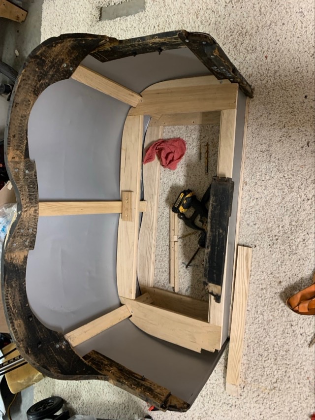

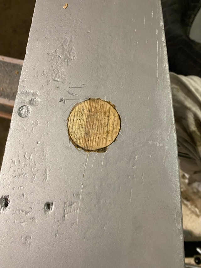

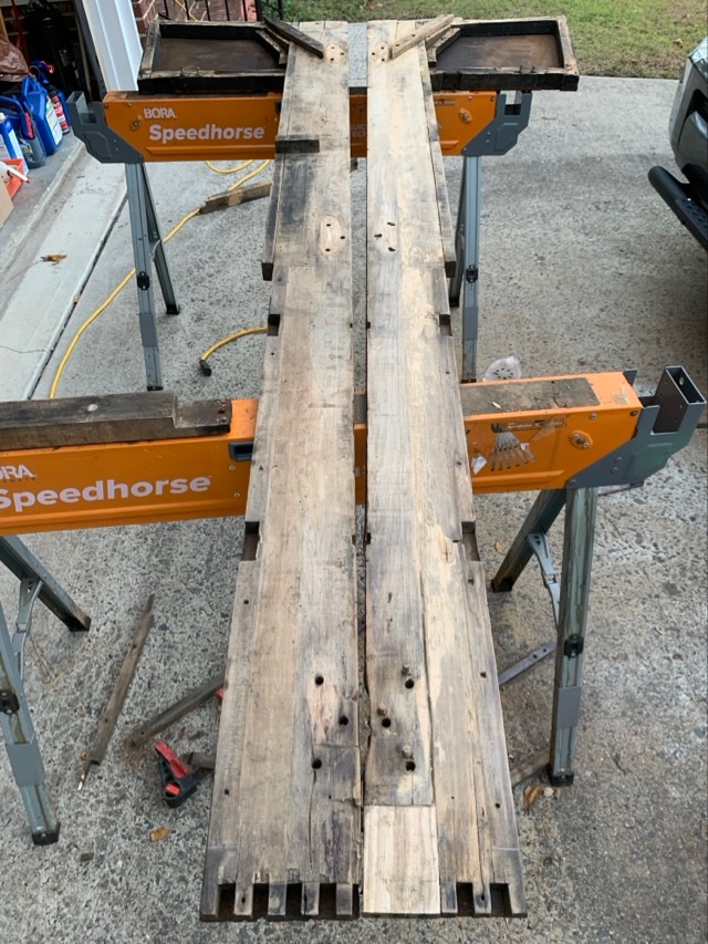

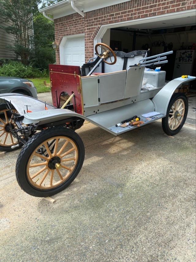

I purchases this from Don probably around Nov. 2022.
I tore it down to almost bare wood. Told the furry varmint to scat Then tried to tackle the rot. Lots of rot! I would advise
Not to power wash old wood…
it will remove the wood
Very quickly!
The bottom 2”’s of the seat sheet metal needed replaced and the wood frame was in very bad shape!
It’s taken me 3 years to get everything i need for this vehicle and i’m still lacking one front fender iron for it. And, people have been very generous with helping me get it all together.
Progress isnt instantaneous even if you throw money at it!
I’ve searched for parts in country and out of country to get to this point.
Very quickly!

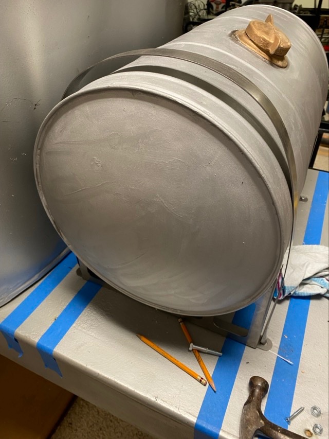

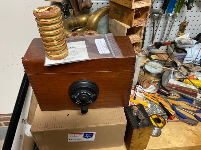

I’ve restored the coil box and coils.
I’ve polished brass and sat on the shelf or in
A box for the future. I bought 8 side step irons just to get 4 good ones…
And, no those arent the four good ones. I’ve soldered , welded, primed just about everything. And even purchased some rare items for it.

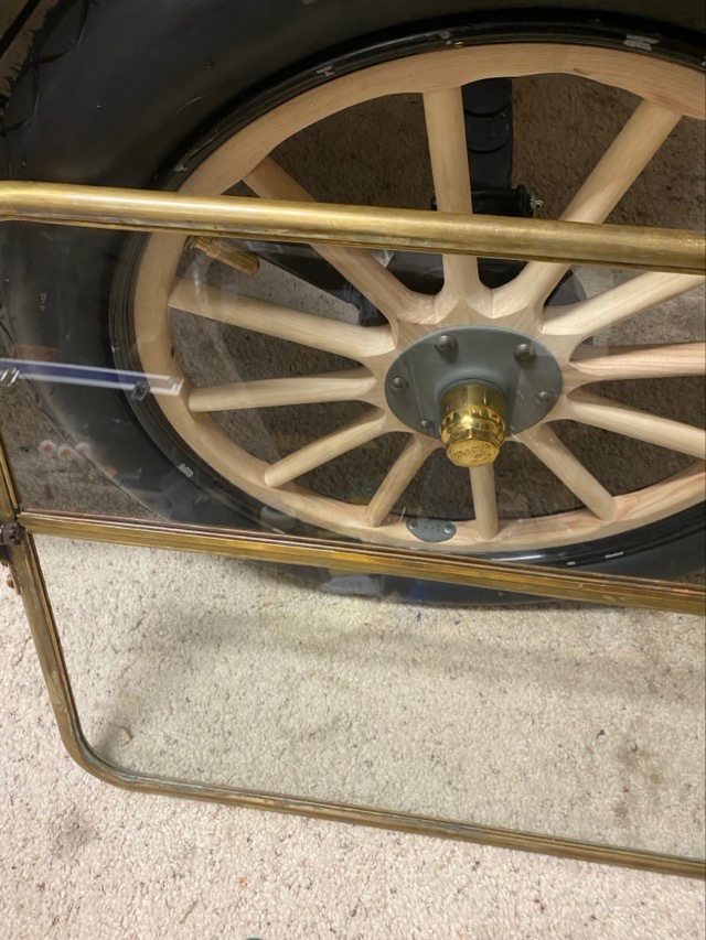

I took that back to the glass shop and said NOPE! They
Did fix it!
All Vendors have been extremely helpful.
I’ve gotten worthless parts, good parts, great parts,
And a whole lot more…
But one thing that is consistent is all the people who have tried to help me get to this point!
Did fix it!
And, so im getting very close… but still lots more to do!
michaelb2296
- Posts: 264
- Joined: Tue Sep 13, 2022 4:01 pm
- First Name: Michael
- Last Name: Bunner
- * REQUIRED* Type and Year of Model Ts owned: 1912 Torpedo Roadster 1917 Smith Form-a-Truck
- Location: Cary, NC

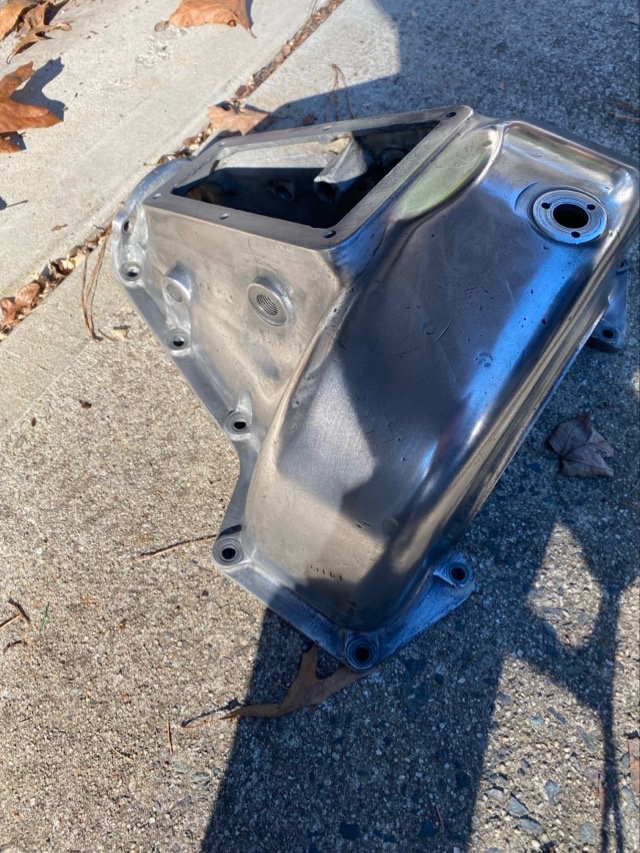

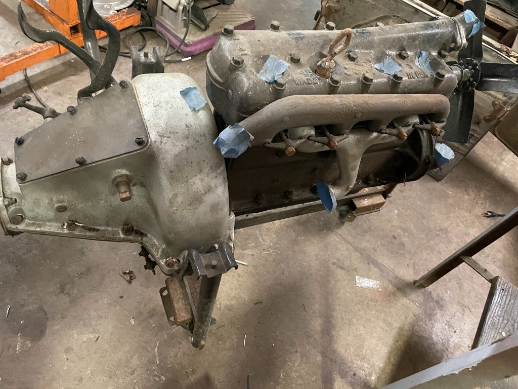

I originally thought this was a typical 1912 until i put the
Firewall on. I found out quickly that this wasnt a later
1912 but rather a late 1911. So, i purchased a Dec 1911 motor for it. Bought a scat crank and am in the process of rebuilding it. A good man from Colorado repoured the mains and the rods and now it’s just a matter of time! Speaking of which, Time-Saver????? Nope. Hours and hours of take it apart, clean, add oil time-saver, tighten back up then redo over and over…. Not saving much time…
Good grief !! You’ve done a lot in only 3 years. I must’ve missed this string of 3 years ago and just spent a half hour of reading it and having fun with all the opinions. What windshield style will you incorporate and will you continue with those rear fenders ? You’re definitely a multi capable restorer Michael. Thanks for continuing the story.
- Posts: 8641

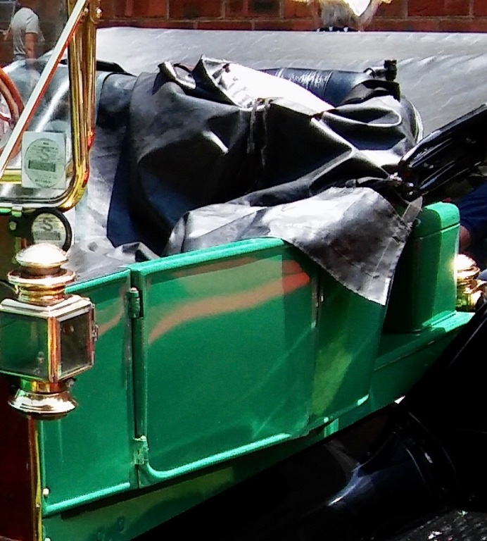

The item pictured in big2bird's Aug. 10th post, titled "Coupe Gizmo?", looks a lot like the metal items on the upper outer corners of the wood dash.

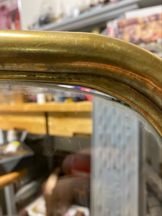

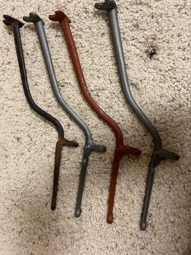

Absolutely George! I will continue with those fenders which were available in 1912. And as a man in SC said he likes the round ones for his commercial roadster, i like these for my Torpedo!
Pat, The gizmo’s in Dons’ earlier post were windshield adjusters, if that is what you are referring to? I had them powder coated just in case i drive it and find it too hot on a sunny day without some air movement. I havent installed them yet. If you’re referring to the brass sidelamp brackets, well i had 3 types to choose from and liked them the most! The more brass the merrier!

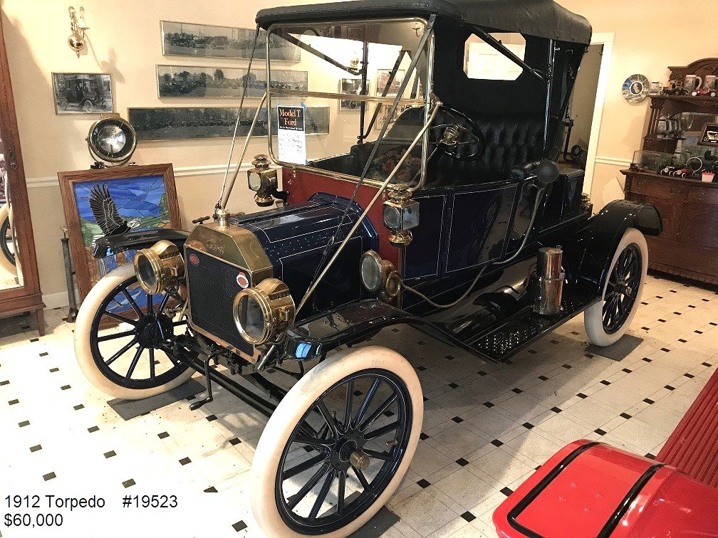

Here are two fully restored Model T's available for the price shown in the picture. Both are award winners. Budget your find to bring its restoration in par with these. The subtract from the ones for sale to determine what the find is worth.
Headlights $2,000 ?
Sidelights $ ?
Radiator $1,800
Tires $2,000 - $4,500
Fenders $1.700
Carbide Generator & parts $2,000
Paint per gallon $
Wood Spoke wheels & Rims $
Brass Windshield/parts $1,000
Top Bows & Material $
Engine Rebuild $
Seat Restoration $
etc

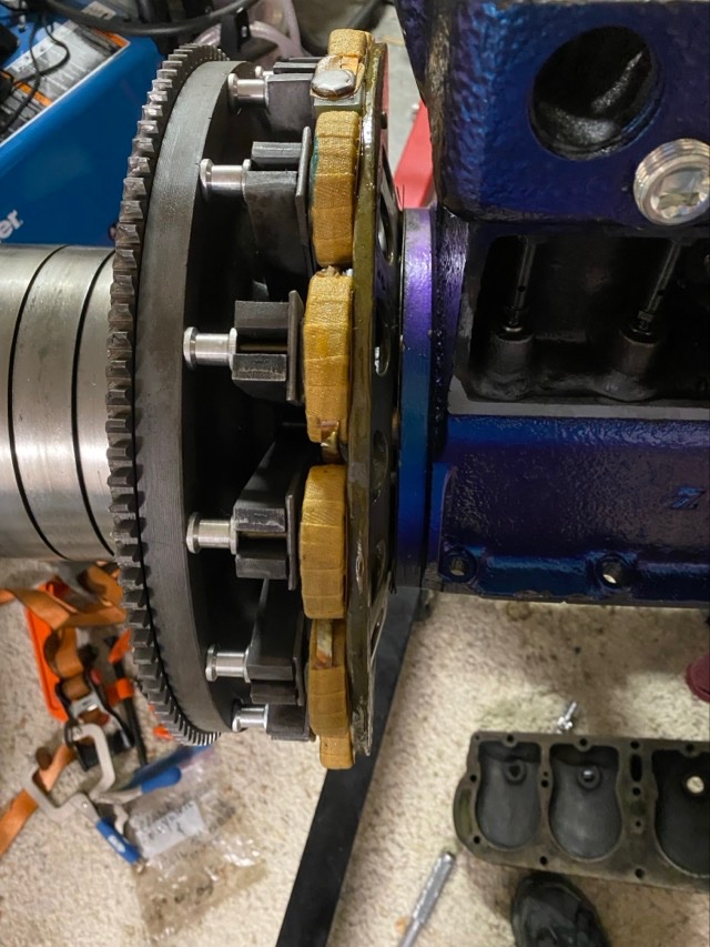

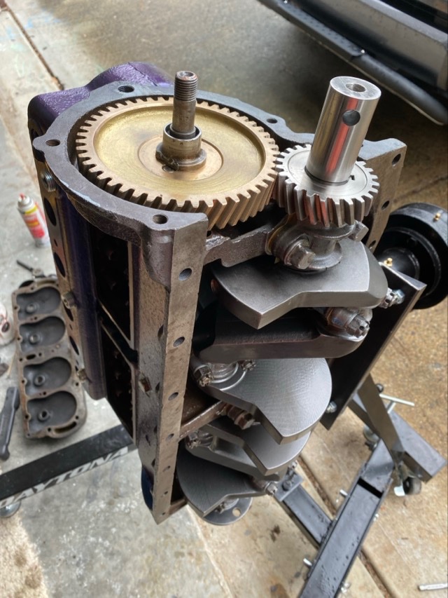

Finishing up the “timesaver”engine build…. Everything is GREAT until you torque it all down!
This is most gratifying, to see what has become of that intriguing relic “find” from three years ago !
It’s wonderful to see a unique T come back to life. Beautiful job, please keep us up to date with your progress, and many thanks for sharing !!

Who was C.E. Phibbs? Doctor Phibbs, perhaps?
michaelb2296
- Posts: 264
- Last Name: Bunner
I wouldnt know. I tried doing a google search but came up with timelines outside the index.
Since it has gotten cold here in the south i repaired a putty filled hole that popped and cracked the epoxy primer. It just goes to show that even modern putties cant handle the cold! Im glad it did this before i painted it!
I am also working on the valves after getting the magnet gaps situated.
New stems are exact and need cut down by 0.020 to have some gap.

Since the subject here is 1913 Runabout, I have and extremely original 1913 Runabout that I restored not long ago. Every piece of wood in this car was put in at the factory, except the firewall. I bought an exact copy from Jon Anderson not long ago, but have not installed it.

Continuous improvements:
Better:
Better:
