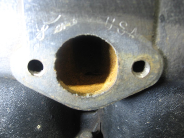

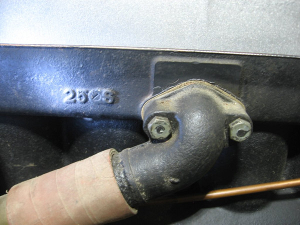

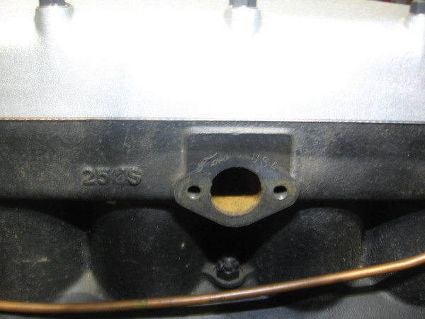

FYI, I have a Model T engine with a 25S cast date that has no serial number on the boss but does have the Ford Script and USA that is halfway on the boss and covered by the water outlet. (See photos below)

FYI, I have a Model T engine with a 25S cast date that has no serial number on the boss but does have the Ford Script and USA that is halfway on the boss and covered by the water outlet. (See photos below) IMG_1369.JPG IMG_1377.JPGIMG_1386.JPG
Dom
Your block is genuine Ford. Was a 'block only" and sold to dealers or agents for engine replacement part.
The boss for the serial pad is the later type, extends 3/8" under the block surface, and has straight sides to the water outlet, corners of the boss with radius. The Record of Change date is 8-27-23 for that boss size.
So your block was made after Aug 1923, and the Script and USA are factory stamped below the area for the mechanic to stamp the existing engine number there, obvious that wasn't done! The script and USA added to assure the part is Ford, and was made by Ford, as the company did try to mark parts with script after 1919.

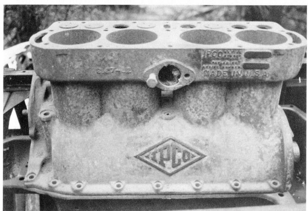

Here is one aftermarket block, by IPCO, lots of different features and even the blank boss for engine serial number to be added is in different place than a Ford block. Would assume all the other aftermarket blocks being very different from a Ford block./b]
Image 1-21-21 at 9.28 PM.jpeg (61.45 KiB) Viewed 3609 times

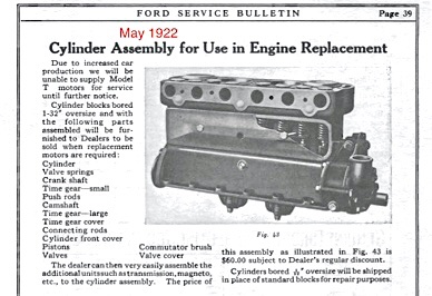

It was common for Ford to sell only the cylinder (block) for service use, these bare blocks were un-stamped.
Only finished complete power plants were serial number stamped after factory assembly and testing.
Your pre ‘26 block was likely a replacement used to rebuild an owners engine, hence no number on the serial boss.
This bulletin was notice that the factory was helping out in high demand to offer dealers new blocks and pieces to built an entire short block too.
