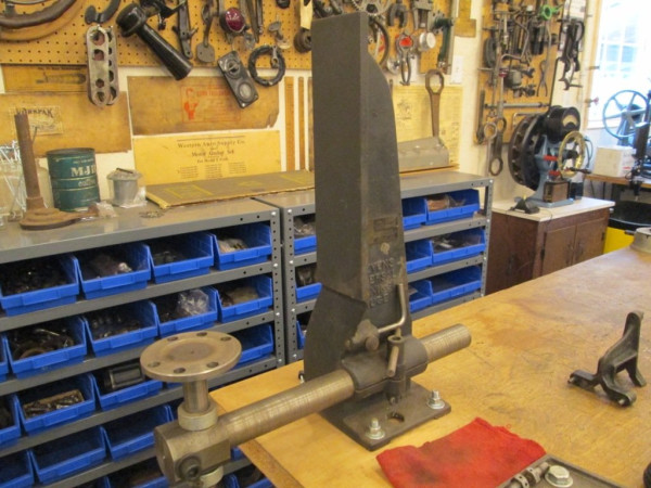

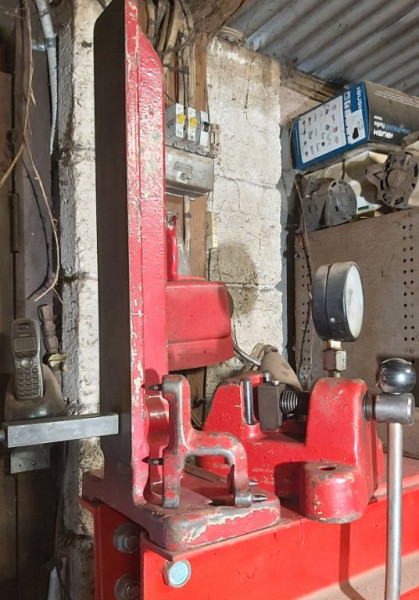

This is my Australian made device. Instead of multiple round mandrels to suit a variety of different rods, this one has just 3 square mandrels. T rods use the smallest one. Most cars fit the second. The largest one is for big truck and tractor diesels. Your sea lion could be used on this device.
Next to it is the matching heavy duty vice used to fix bent rods. It took me years to find it

Steve, is there a need for the rod to be centred? I am not sure what that means in terms of rod alignment. The square mandrels in my fixture are precision machined for accuracy and each size is bolted in place with a flat surface on top. Any size rod can be rested on the chamfered corners of the mandrel. T and A rods would be checked on the same small mandrel, and it doesn't matter if they are various under sized bearings. It makes the device just that easy to use.
I guess the same could be done on the KRW device if a little used round mandrel was machined into square like the ones I use.

Now it makes sense Donnie. Because my tool is used on a multitude of rods, it is designed to facilitate this. The very substantial vice is used to straighten bent rods, including hefty truck and tractor diesel items. On T rods, I pass another rod through the wrist pin to correct twist.The rod is returned to the square mandrel for checking with the sea lion. It tales a couple of goes with T rods, more so with anything heavier, but I never have occasion to do this.

Kerry, that's where the square mandrels come into their own.
