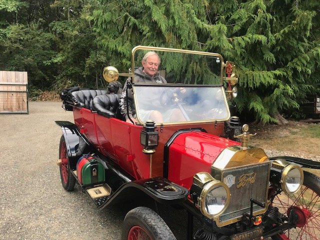

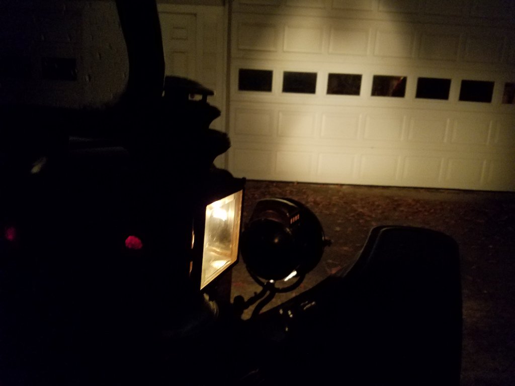

Post by RajoRacer » Sat Apr 23, 2022 10:14 pm
My friend installed the available reflector & Halogen bulb kit from Restoration Supply in his '13 - they are super bright but do draw major amperage - I installed the same kit in our '14 - they're crazy bright !

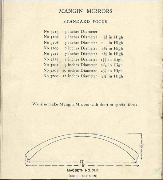

Mark,
Not to change the OP question but you asked about headlamp size....
Ford used 6" Mangin mirrors in the supplied headlamps, John Brown, E&J and Victor.
I have John Brown 16's and they will not take a larger diameter. They are measured
across the maximum diameter as shown in the MacBeth chart below.
Fords would use the MacBeth No. 3209.
I searched for a while on the usual sites until I came up with some good mirrors and
have a pair of Lancasters on the car in their original silver. They came out of other brands
of acetylene headlamps I bought just to get the mirrors. Just be sure to have a pad behind
the mirrors and snug up the 3 mirror mounting screws (John Brown) every once in a while.

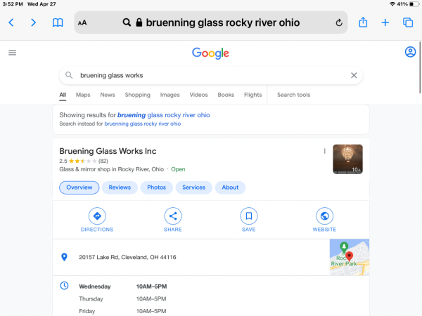

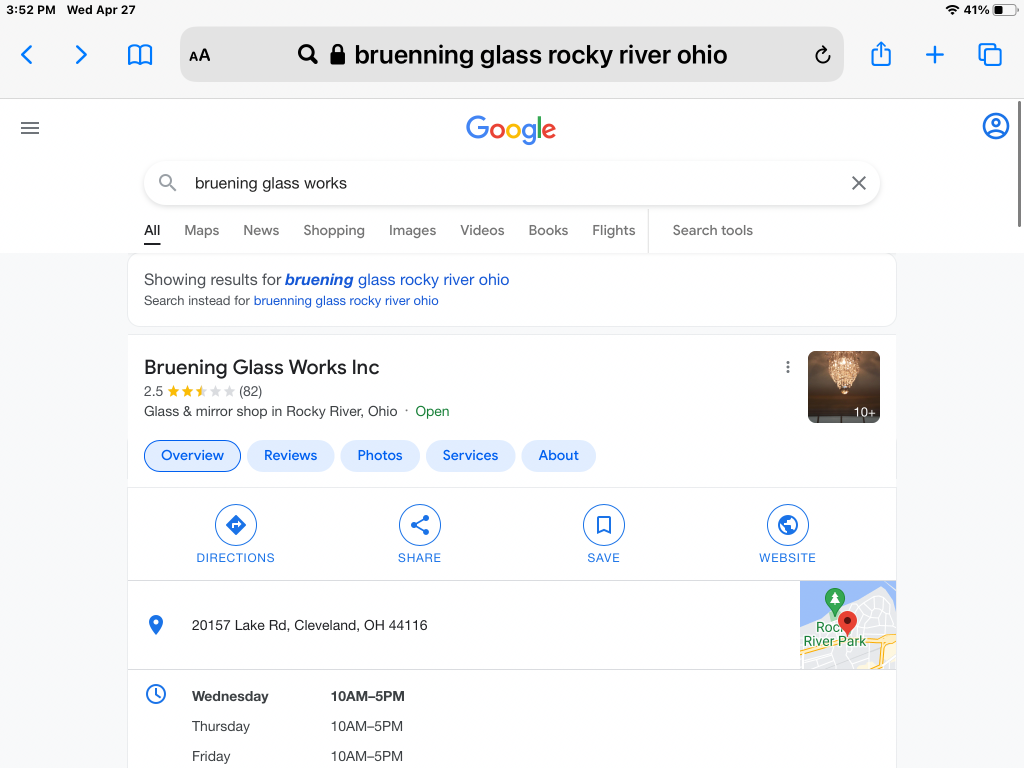

Posts: 4496
Re: New mirrors for acetylene lamps
Post by Jerry VanOoteghem » Wed Apr 27, 2022 2:34 pm
schwabd1
Posts: 282
Joined: Sun Jan 06, 2019 7:26 pm
First Name: David
Last Name: Schwab
Location: Northwest Ohio
Post by schwabd1 » Wed Apr 27, 2022 3:01 pm
"I think Craig Riker, in Ohio will re-silver mirrors"
Craig does plating of reflectors, he doesn't resilver glass. He does do a great job of getting your reflectors in top notch condition, or anything else you need to have nickle or chrome plated.
Dropacent
Posts: 3384
Last Name: Morsher
Location: Norwalk Ohio
Post by Dropacent » Wed Apr 27, 2022 3:51 pm
There is a lot more science than just putting something shiny and reflective behind a light source. …….as a very slight drift, if you do have original mirrors to get resilvered, you can save by prepping them yourself. A good paint remover to take off the protective paint layer. Then a good grade of toilet bowl cleaner will remove the silver. Takes patience and possibly a couple applications but it works well, and important to use gloves and a scratch proof method of agitating both the paint stripper and toilet bowl cleaner. ………. There is a place in northern Ohio , Rocky River , Ohio , called Bruenning Glass. There is one in north western Ohio , Bigelow glass. They both do silvering ( they may not advertise it, but I’ve used them both and can highly recommend both) . Worth a call to find out.
