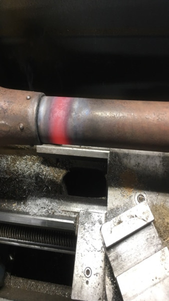

Building a couple rear ends for people. It’s amazing how many of them are bent. Like oil pans. I have never put one on my KRW jig that didn’t need some correction.

Heating the tubes doesn’t bother the Ford steel tubes. I will straighten housings if you get them here. It’s $50 a pair.

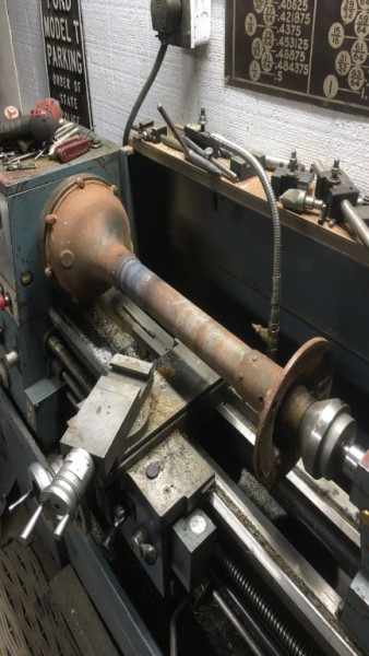

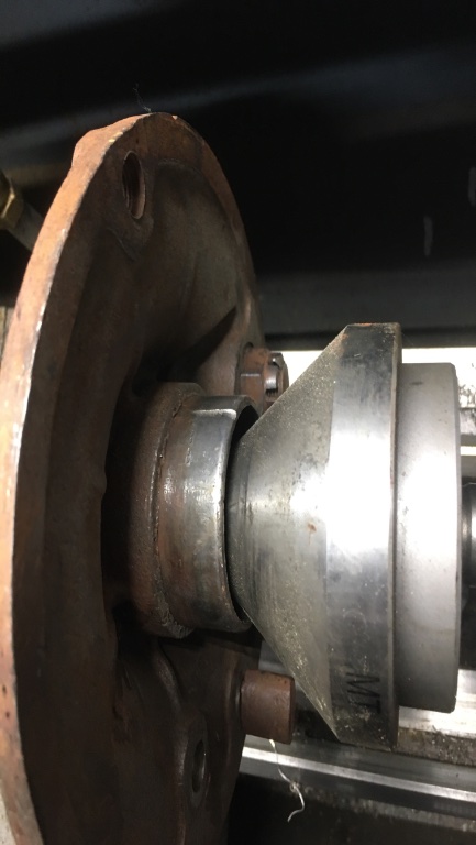

Bending the tube to align with the center casting bolt surface only works if the tube itself is sprung and you are straightening the bend. If the problem is the center section is sprung or was not riveted to the tube correctly, bending the tube will cause the roller bearings to be misaligned
One attempt to address this concern is to mount a large plug to the fixture which is held in the lathe to which the housing is bolted. The plug fits snugly into the inner bearing when the housing is bolted up.
The idea is to keep the bearing hole horizontal so that bending the tube won't misalign the bearing holes .
If the bolt surface of the housing does not bolt up evenly on the fixture with the plug inserted, the problem is a misaligned center casting and that should be addressed. I'll try to post a photo of the fixture later.
