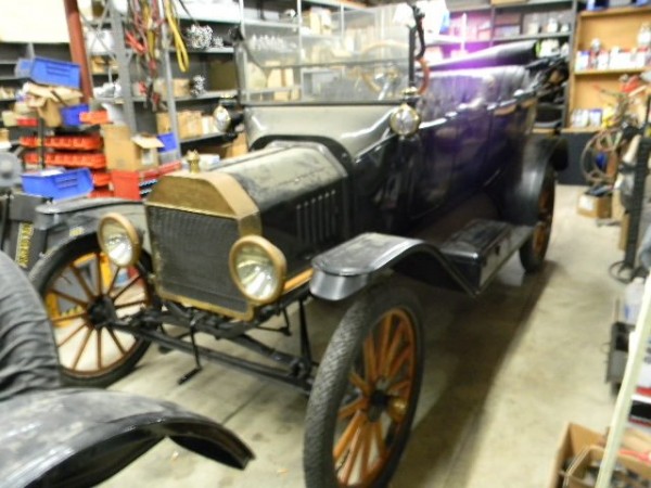

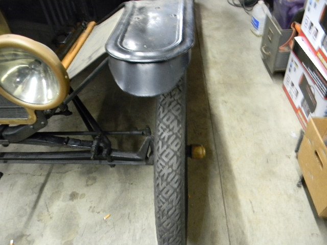

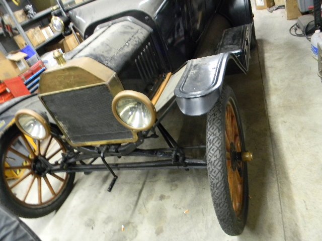

The old non skids seem to keep up good as on this very original 1915 touring that is going up for sale, Bob
