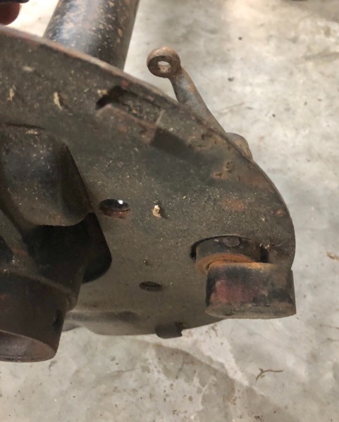

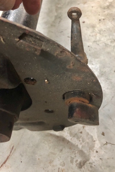

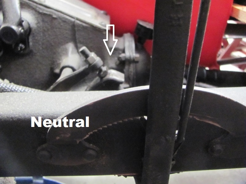

Maybe these photos will help to envision the brake cam, how it expands the shoes, the position of the cam lever at rest and when shoes are expanded.
The rods are adjusted with the hand lever is first placed so the 'neutral' is just met. (you can roll the T by hand) (i.e.) The hand lever adj. bolt lifts the clutch lever arm enough to put the trans. in 'neutral', that spot varies some, but most times on the high leading edge of the cross shaft arm cam. The hand lever most times is shy of true vertical.
Once you have the hand lever there, then adj. the rods to fit. The rear brake cam lever should be in that happy 'free' zone, where the cam isn't really expanding the shoes. Keep that cam lever in that spot as you lengthen or shorten the clevis at the end of the brake rod at the cross shaft lever.

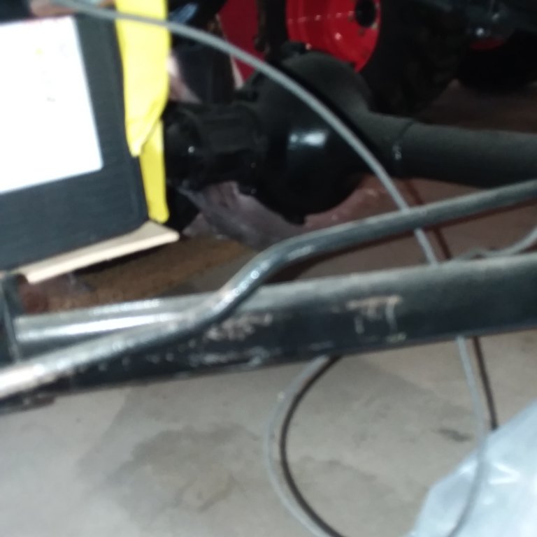

Post by Professor Fate » Mon Apr 25, 2022 1:35 pm

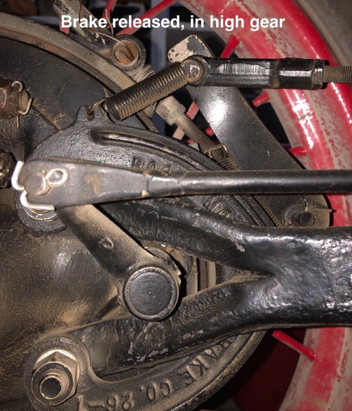

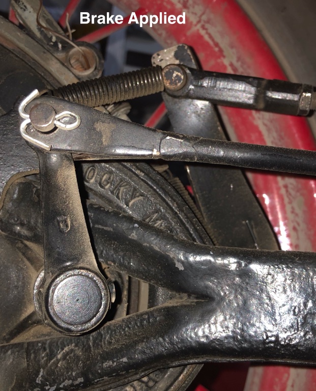

Pic of my '26 brake rod in place. Note bend in rod from manufacture.
Are your rods straight all the way? Correct for 26-27 rear axle or the axle on your car? Brake back plate should be 11 inches for improved car.

Posts: 5245
First Name: john
Last Name: karvaly
Location: orange, ca
Re: Brake Rods
Post by speedytinc » Mon Apr 25, 2022 1:53 pm
Original??
26-7 rods are straight. Small drum rods have a u bend to clear the radius rods. See Langs catalog.

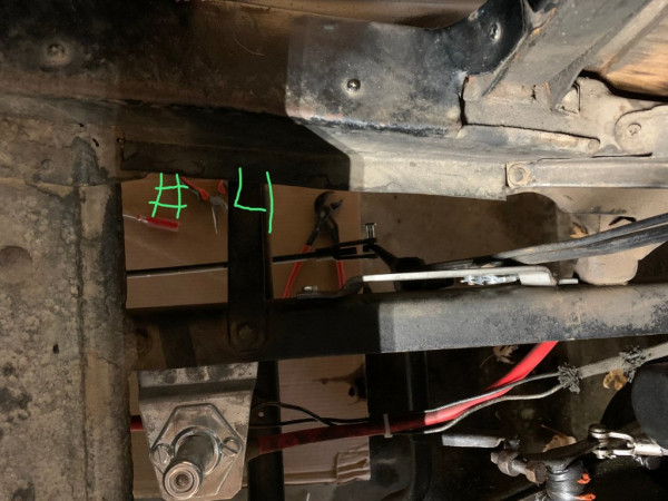

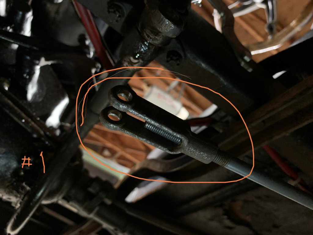

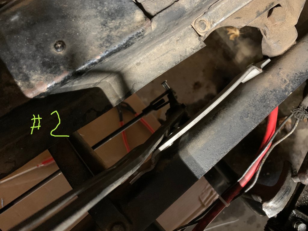

Post by CatGuy » Mon Apr 25, 2022 3:08 pm

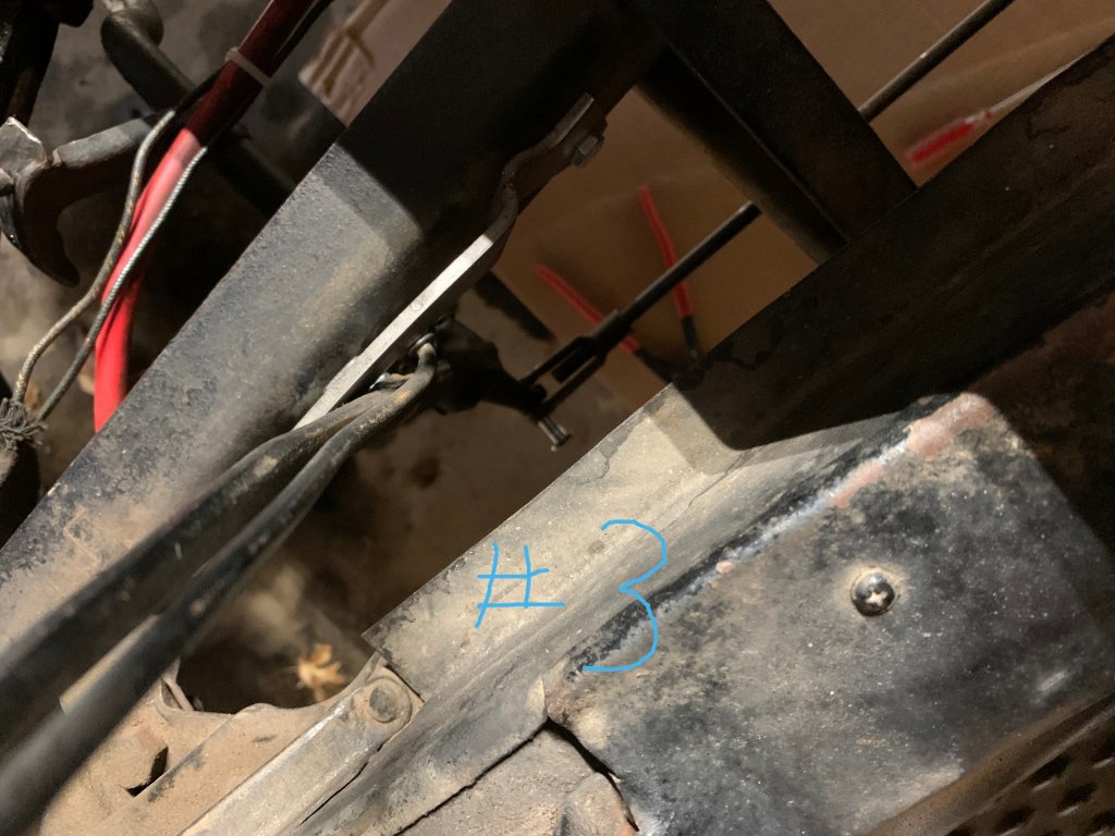

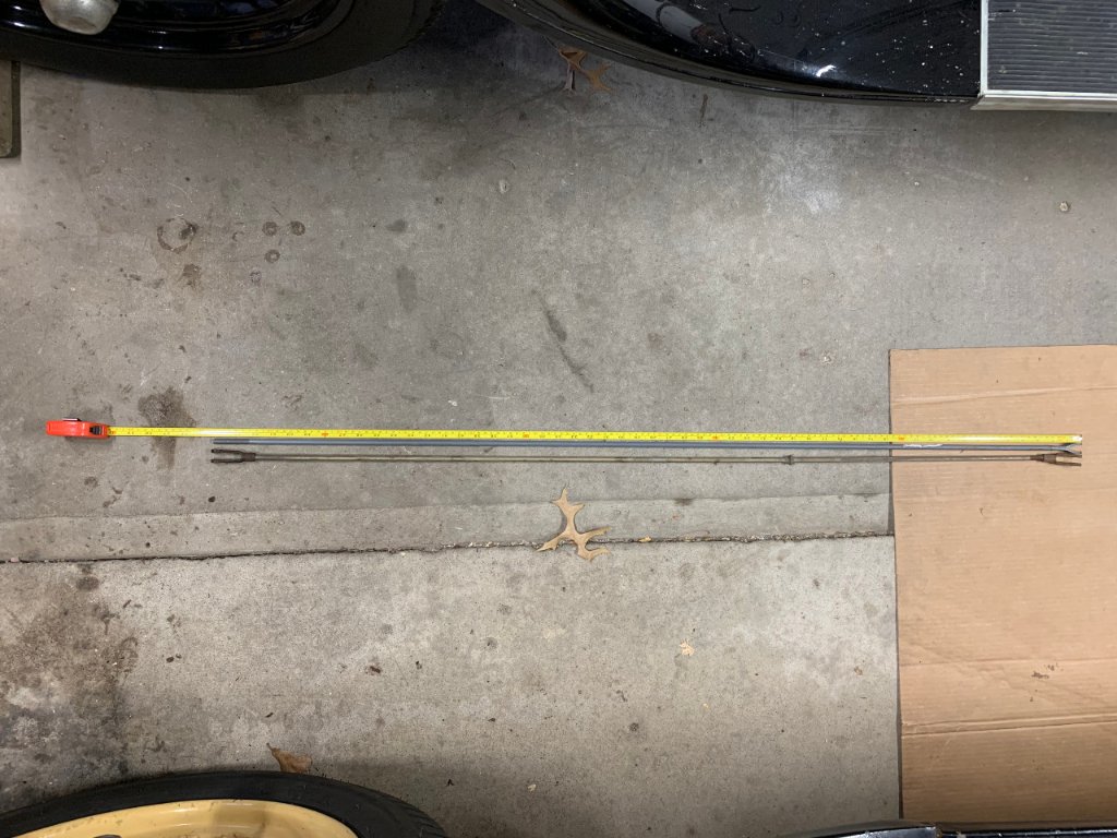

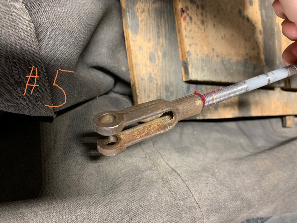

Here are some pictures. #1 The clevis the car came with. I don't think it's correct. It's all I can do to thread them on the rod. #2 Is with the brake on. #3 Is with it in neutral (vertical). #4 is with the brake off and the rod flexing or bending inward as I hold it. #5 Is another picture of the clevis.
Posts: 4454
Re: Brake Rods
Post by Jerry VanOoteghem » Mon Apr 25, 2022 4:17 pm
A side note. The clevises should have nuts behind them. Once you get the adjustment right, the nuts are tightened against the clevises so that the rods don't vibrate within the clevises and wear away the threads.
Those rods do not look like original ones. Not knowing their source or how correct they are, it may not be a bad thing to trim their length once you're certain everything is working as it should.
Look at Dan's photos above. Compare them to what's happening on your car. Maybe post photos of your car, showing the same views that Dan did, with the same brake lever positions.

I'm seriously considering buying all new rods, clevis, nuts, pins. I can't get these clevis to turn on these rods unless I use pliers in both hands and even then the pliers just slip. Weird. Is it possible that the threads don't match? I'm either going to get them from Snyder's or Langs. Thoughts?

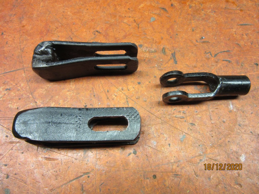

They are the wrong clevises. T model ones are much shorter, so in effect those are making your rods longer than they should be. On a 1926, the clevises should be made of rolled steel with a join along the under side. Only the early cars had forged clevises like yours, but they are still much shorter.
Your idea to replace the lot with new parts has merit.
