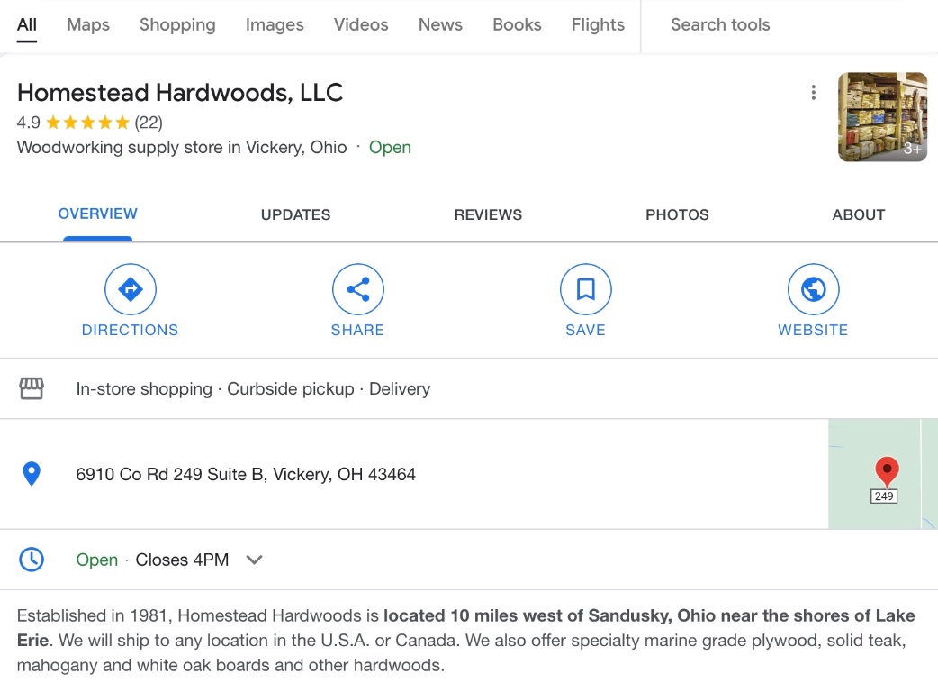

Mike, I’ve bought 8/4 and thicker ash from these guys. Close to me, small enough to care, great to deal with.
