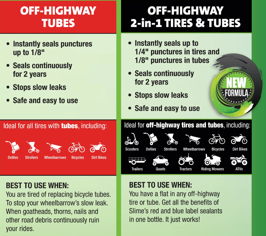

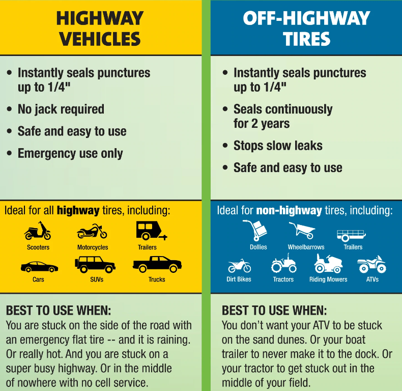

Slime comes in four formulations. RED & BLACK for Tube type tires and neither is recommended for tube or tubeless tires traveling over 45mph
RED https://slime.com/collections/sealant-f ... dirt-bikes
Instruction video https://youtu.be/82pMuI2bk0k
How much to use calculator (thinking Dirt Bike is more applicable to a Model T tire than Today's Car) https://slime.com/pages/slime-calculator
