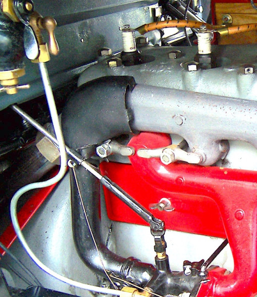

Refer to the third photo in KBorket's April 11 post in "What Have You Done to Your Model T in April". In this photo, there is a shut valve in the gas line between the sediment bowel and carb. Why is this needed when the gas can be shut off at the sediment bowel?

It is common to install the valve near the carburetor so it can be operated without having to crawl under the car. If it is elsewhere in the line, I would suspect the original valve was leaking into the line. On the 26-27 the tank is in the cowl and the valve is under the hood so you don't need the extra valve.

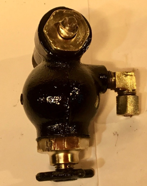

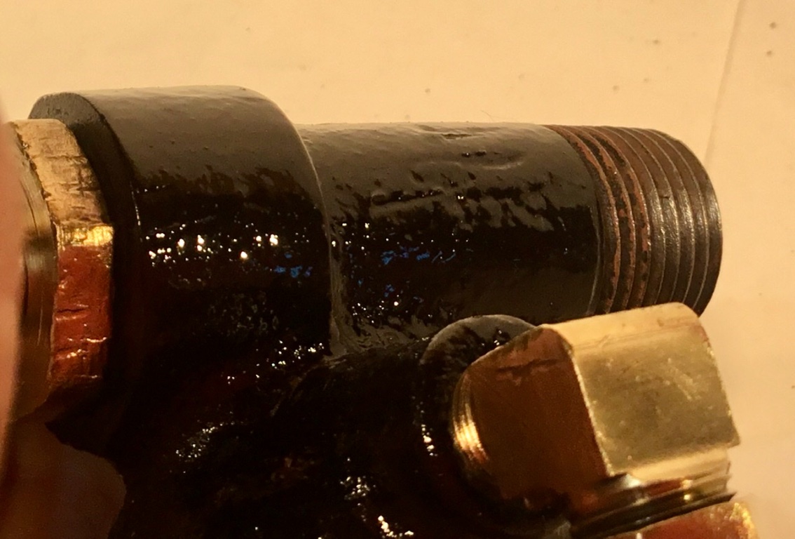

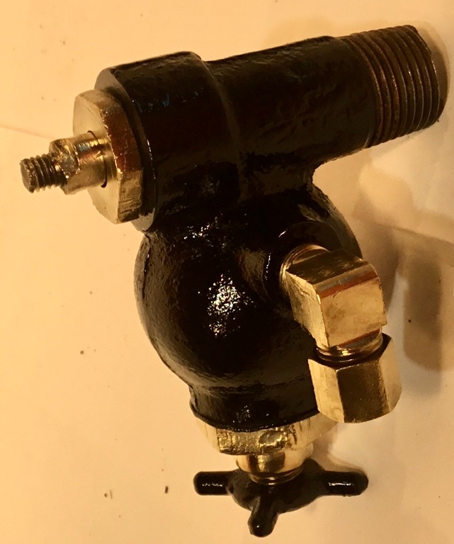

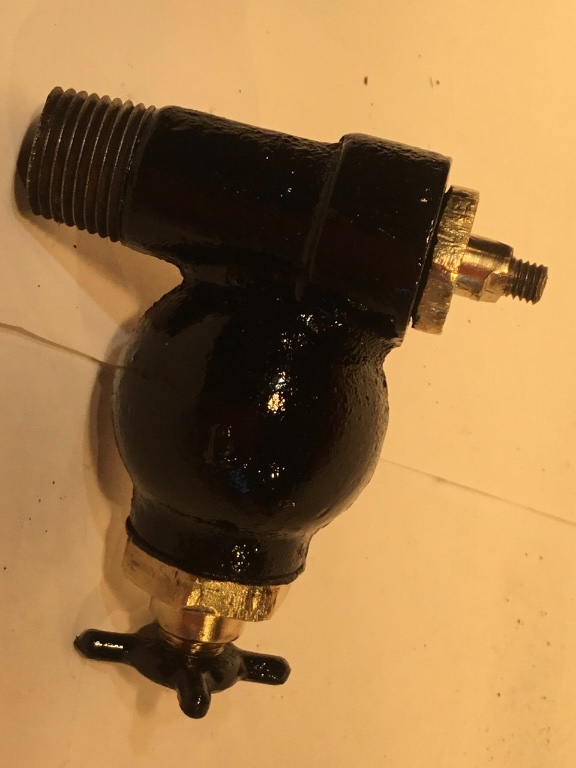

This is the type of gasoline filter/shutoff valve you should have on your Coupe. This one is missing the shutoff handle. You can see the handle in Dan Treace’s above photo. Jim Patrick
