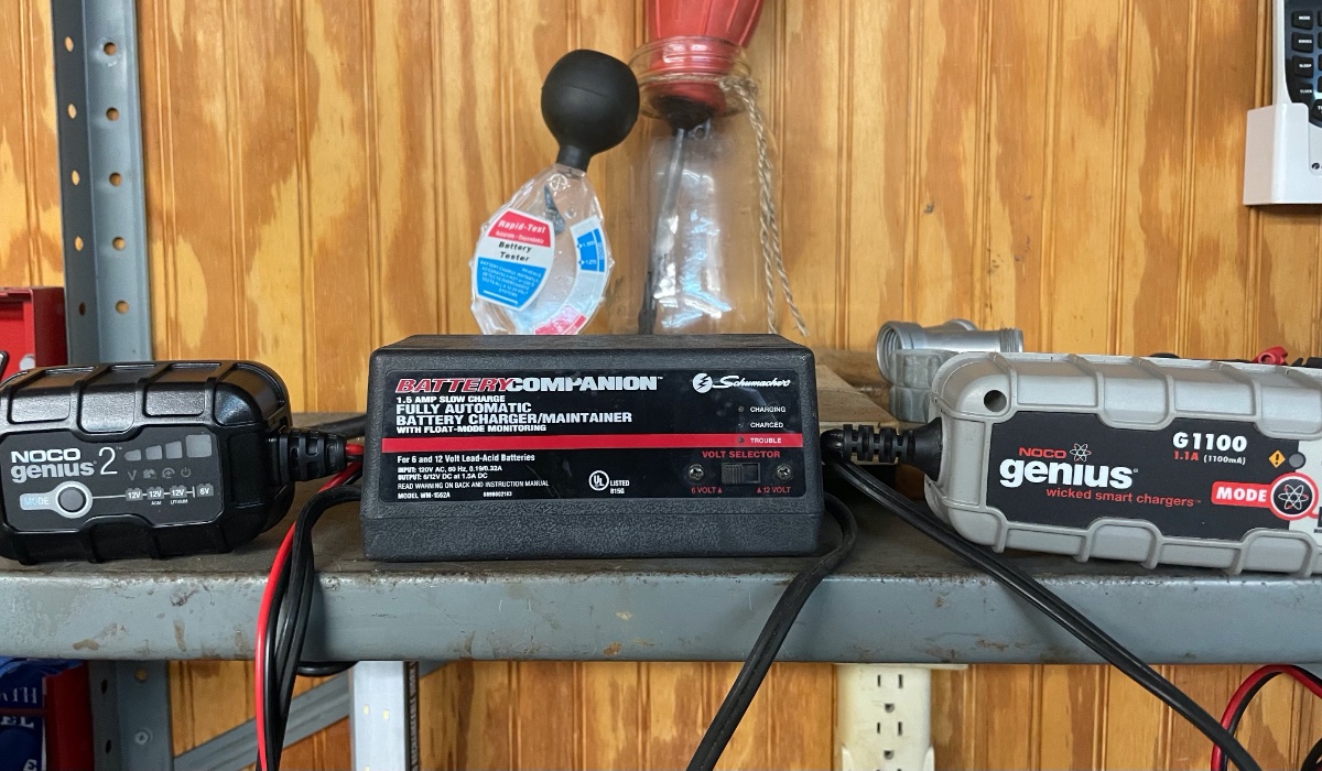

- Posts: 4090
Re: A really useful Battery Charger?
Same here, the NOCO little one on the left is supposed to work on 6v, but never has.
I mostly use the center one, works great!
The unit on the right is sold for the Optima Red Tops, and I like it too, works good. All are 6v-12v switchable.
BTY, I don't leave them on the battery for extended times, un-attended. Place them on the batteries every few weeks for just a day, then shut them down overnight, when leaving the garage.
Just in case!
