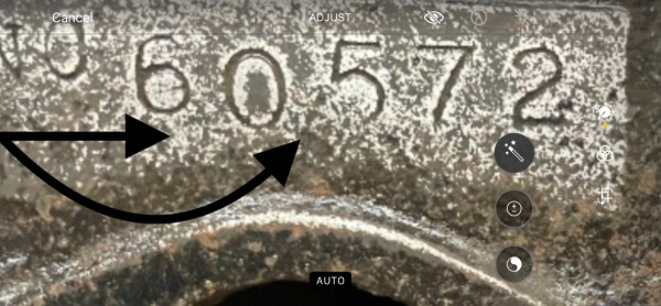

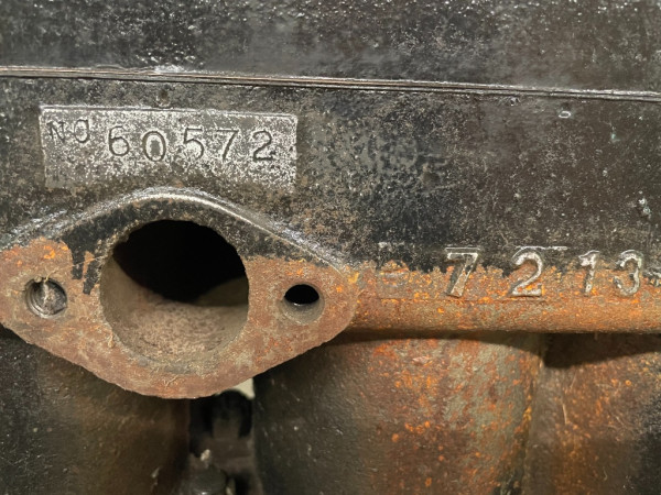

This is the engine number off the barn car I just picked up,. I have no idea about this one. Has anyone ever seen this before?

I enlarged the picture & think I am seeing shadows of numbers between the more pronounced numbers.

Replacement block stamped with the number of the ruined one it replaced. It would have been stamped in some shop, not the factory, where the "NO" was added. That could have happened in some other car before it ended up in the present one.

Is it just me, or does the "NO" really appear to be "NC"??? See the little "hook" in the 1 o'clock position of the C/O?

Note how the water inlet appears to be higher than the number boss. On all of my 1913 engines, the water inlet and the number boss are the same height, as if they were machined at the same height. My guess is this is a replacement block and the number is an original stamping, not a restamp. Just my thoughts. Russ Furstnow
Jerry
To me, that is indeed a 'C' . Just a guess, but perhaps the mechanic who exchanged that later '13 block for the busted serial of an '11 made those letter notations along with the old serial number.
Could be NC for a North Carolina requirement needed the state attorney or could be NC for Number Change.
In any event, that is original '13 block, and serial pad was blank, as Russ pointed out, and then the odd letters and old serial added.

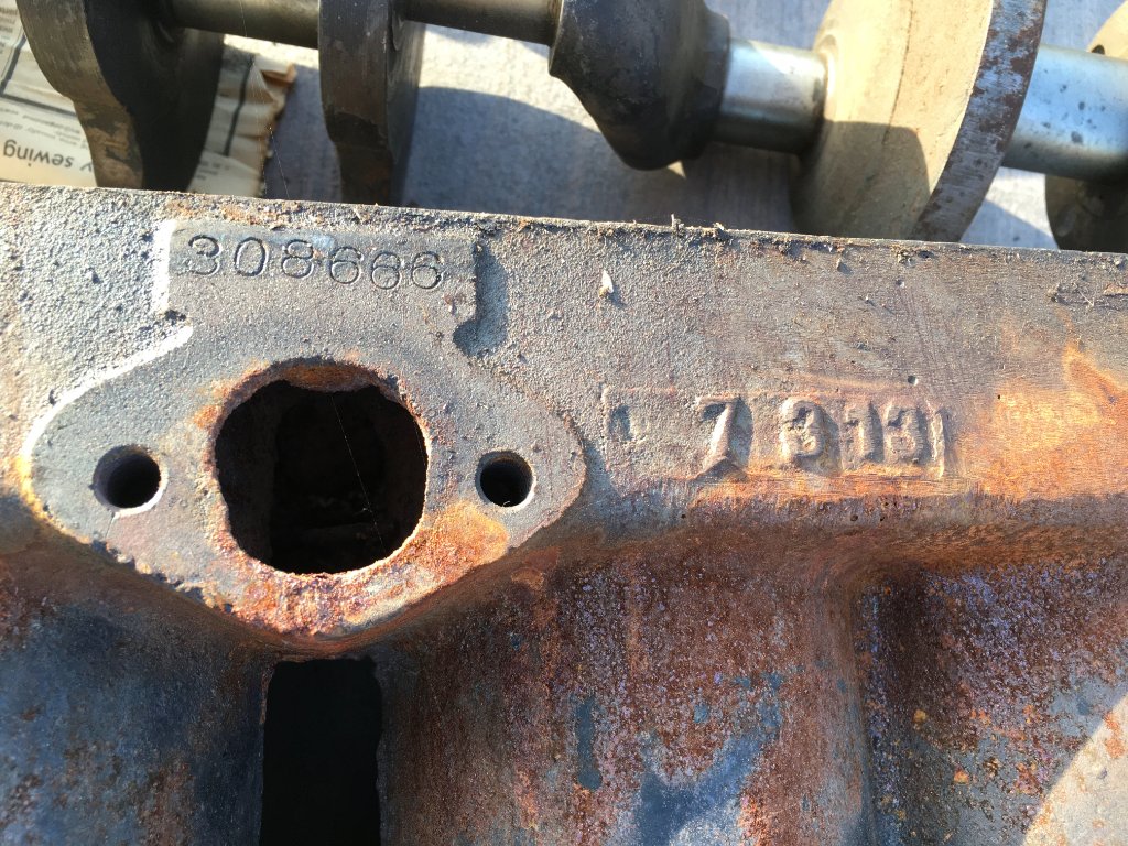

Interestingly, this 1913 block was for sale at Tulare this past weekend. Given that the casting date is one day after the block featured in this thread, it should be a valid example of what the Ford factory was producing at that time.

Well Rich that picture pretty much confirms Russ’s thought about the numbers boss being cut down.
