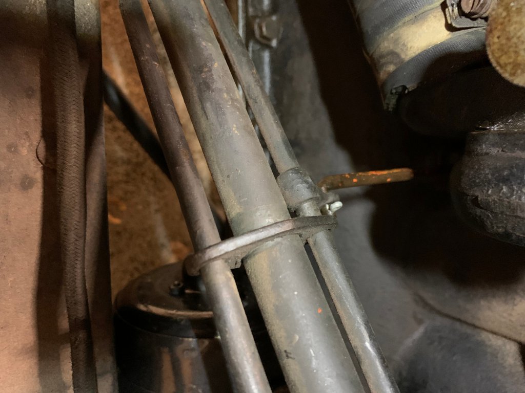

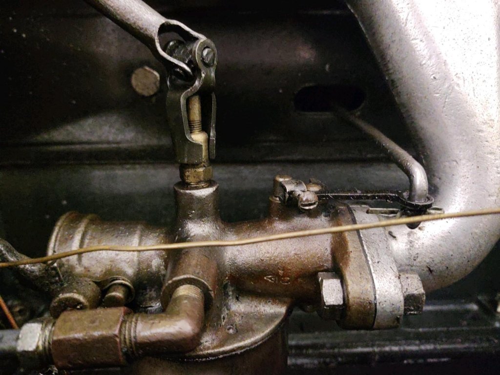

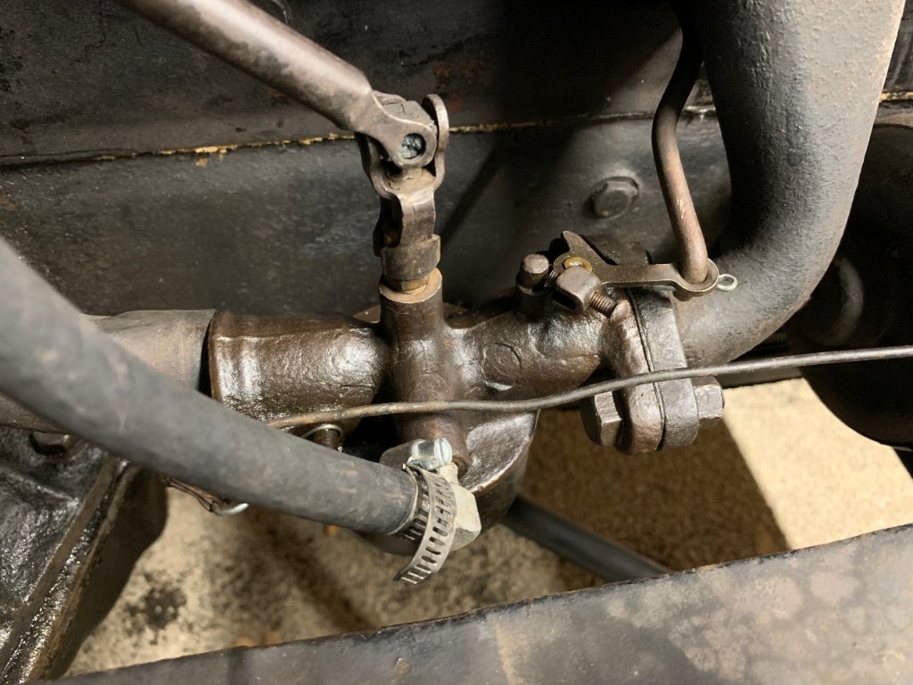

Here are a couple pictures of the set-up I have. Does it look correct? This is for my '26.

Post by Humblej » Tue May 03, 2022 8:32 am
Scott,
Looks like you may need to bend the rod to make it a little longer so the screw will engage the stop.

Post by CatGuy » Tue May 03, 2022 8:36 am
Scott,
I thought that I needed to turn the screw 'out' to slow the idle and 'in' to increase it? Currently it's all the way 'out'. I can turn it 'in' to increase the speed.

Re: Idle Speed Adjustment
Post by Moxie26 » Tue May 03, 2022 9:24 am
Looks like the valve cover has to be removed, turned 180 degrees and reinstalled . Get yourself another throttle rod.

Post by JTT3 » Tue May 03, 2022 9:27 am
Perhaps my suggestion was unclear, I’ll try again. If you remove the throttle rod off of the carb and use your hand to move the carburetor’s throttle arm can you move it towards you, further toward you than when the rod is in the carburetor’s throttle arm? If so the above advice concerning length of the throttle rod may help. By doing this with the engine running you will be able to confirm if there is a change in engine speed. Without physically removing the carb you can’t tell if the throttle shaft & flap are tight and moving in sync with the arm. Sometimes the arm & shaft are loose because the peening of the brass shaft where the arm is attach has given way. This is an easy fix though. If you do take the carb off, can you move the arm to close the flap completely? Place a mark where the throttle arm is when fully closed. I use a sharpie so I can tell where fully closed is when attached to the intake. That will help you visually when determining how much more length you may need when adjusting the rod length. I did notice the hole where the rod goes in the arm looks really good. It doesn’t appear there is much wear at all.

Post by Moxie26 » Tue May 03, 2022 10:13 am
The bend in the rod at the throttle in essence shortened the length of the rod therefore prohibited the closing of the throttle to reduce idle speed. I have a picture and I'm trying to post with no success. Any tips would be appreciated.

Post by Norman Kling » Tue May 03, 2022 10:28 am
After reading Moxie's post, I agree with him that the valve cover should be rotated 180 degrees. The hole should be opposite the arm on the carburetor. I also think the throttle rod is backward. The bend should be on the side toward the steering column.

Was able to attach carburetor photo, but I got posted with my previous post above.

Post by JTT3 » Tue May 03, 2022 11:01 am
Scott, LOL. I assume, based on the picture where the rod is attached to the steering column, the person that put the rod on didn’t realize you can tap the stabilizer support around the spark, column & throttle up to put the throttle rod in the right orientation. It appears that the support was to close to put the rod in correctly so they turned it 180 out. Some really good observations by all. Amazing, maybe pictures do speak a thousand words. This really is what the forum was designed to do, helping others succeed!

Post by CatGuy » Tue May 03, 2022 11:20 am
I can't get the pictures to be any bigger. This is an interesting twist. I wonder how long the last guy had it that way? Now, I know that the car is only 20hp, but to me it seemed like it couldn't get past 28mph.....on the flat. Could be then it's not getting the range it needs? I'd like to see some more pictures of the way the linkage and valve cover should be. I've got some homework....

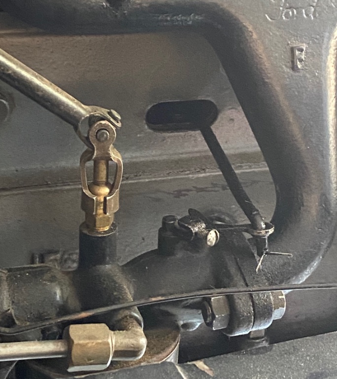

Post by Chuck Regan » Tue May 03, 2022 12:19 pm
Scott - picture of my ‘26.

Post by Jerry VanOoteghem » Tue May 03, 2022 1:19 pm
- Remove the throttle rod.
- Remove the 2 bolts holding the tappet cover on.
- Remove the tappet cover. It may be tricky to fish it out. Removing the generator may help.
- Remove the old gasket and clean both the cover and the block where the gasket sat.
- Replace the cover, flipping it around end-for-end from its previous orientation. Use a new gasket and/or appropriate sealant. The hole where the throttle rod passes through should now sit below the centerline of the 2 mounting bolts.
- Intstall the 2 bolts. Get them snug but not "tight", as this will distort and warp the cover.

That looks like a Holly NH with the swivel on the adjustment rod. Correct for a 26. You should be able to get the valve cover off. Might be a bit tight behind the generator, but it can be done without removing the manifold.

Scott, I agree with the others... That is a correct carburetor for a 26 Model T Ford.

Scott and Chuck have the correct carb, with all correct features for a '26
Jablonski, technically, does not. His has the (earlier) long throttle lever and (later) friction swivel for mixture control. It is a marriage. Probably a shotgun one at that. Mixing and matching of NH parts is a very common thing, and there is no reason to believe that the marriage will not last.

Scott... I do have an NH carburetor and yes it is an earlier type straight through bore that was only used for a few years before the later NH changed to the hump back bore. ...... The mixture need needle assembly, (needle and mixture adjuster ), is true to the '26-'27 NH. Conger failed to identify the aluminum intake manifold that was used on the early teens Model T engines, also lack of the intake hot air heater . Good luck fixing your T. Keep us informed of your progress !!!

Scott... Please post another picture of the driver side of your engine Thanks

Robert a little thread drift, is that a high volume intake? With the straight through NH coupled with the intake do you really see an improvement in performance? Does the combination increase fuel consumption vs the humpback NH?

John... You have a good eye. Yes that is a 1913 aluminum intake matched up with the straight through NH carb, and yes I do notice improved all around engine performance.
