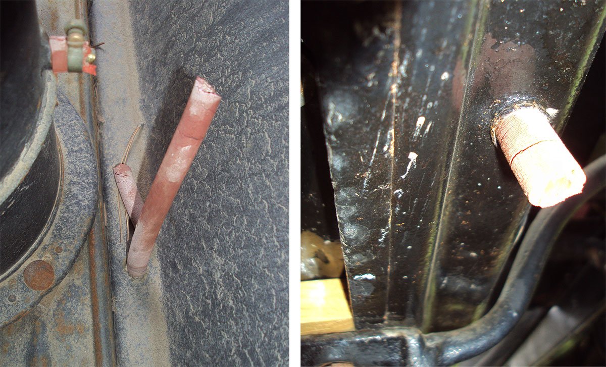

Tim, I am not wanting a nice clean hole. I want to duplicate the punched hole with the rounded triangles on the bottom side as in this picture. Art

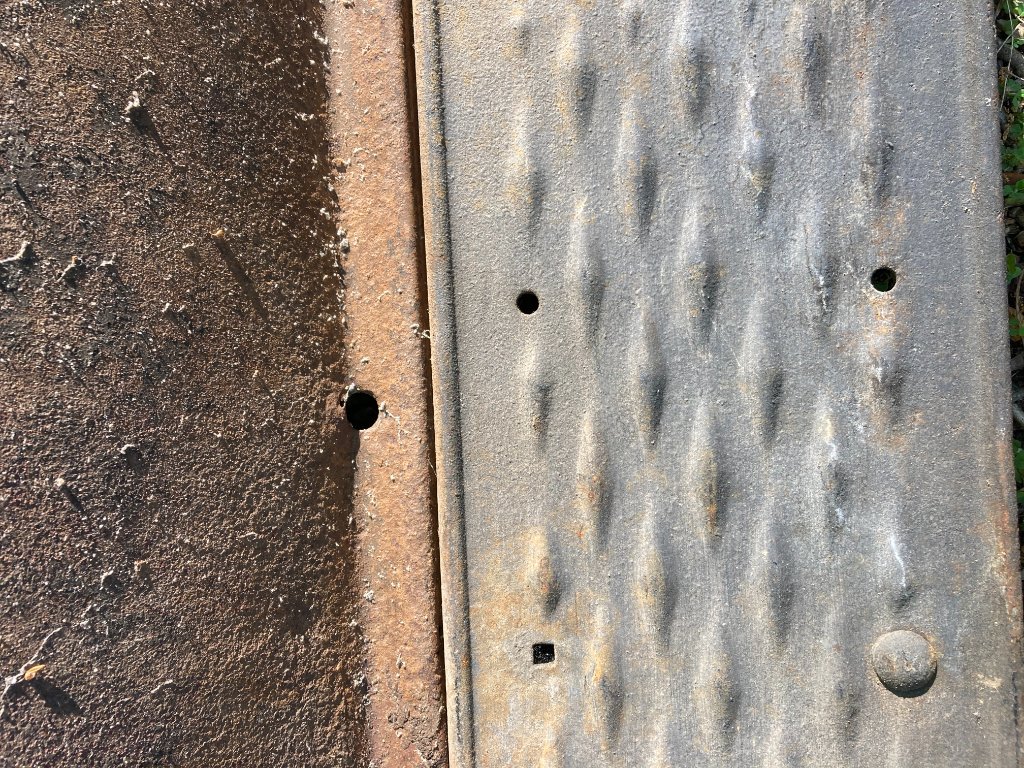

Where should the hole in the running board be made (position9?

I do want it to look correct and the rounded edges on the hole was to protect the rubber hose. Art

This is what I ended up with. I will roll the points up a little. Art
