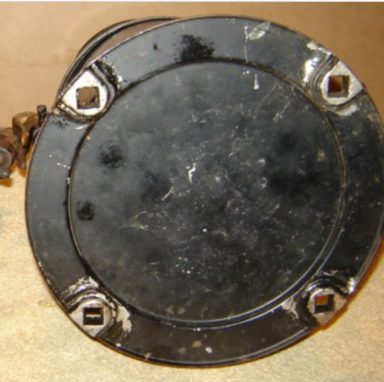

I will assume you have a generator with a "four hole" base plate (see below),
if you do:
Beginning about June 1912, Ford began using the two front running board support holes for the front two bolts on the acetylene generator.
They are spaced 5" apart and match the two holes on the four hole generators used.
You already have those two holes in the running boards you have mounted.
Just set the generator holes over those two and the two rear holes will be located for you.
They will be 5-1/4" down the running board and spaced the same as the front.
Also, when you mount the generator, orient the gas outlet toward the splash shield.
The 1/2" gas hose hole is in the center of the "flat" area of the splash shield next to the running board in line with the two front running
board holes you already have.
BOTTOM OF ACETYLENE GENERATOR

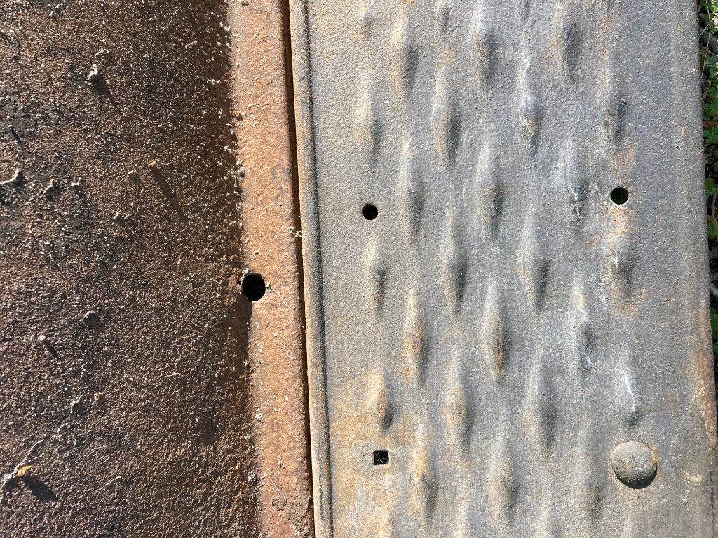

Here you go, Michael
see the picture regarding holes/location as posted on http://www.mtfca.com/discus/messages/50 ... 1421797605 1/20/15 1:10

A huge thankyou to Mike Walker for the post of the correct running board! Most restored examples have been changed. As I mentioned above, compare the Ford script to that on a later example, and you will see the difference. If your running board has been changed, as mentioned above, simply place your generator above the running board holes, and that will locate the rear holes for you. If your right hand running board is original to the car, it will be as the example that Mike posted.

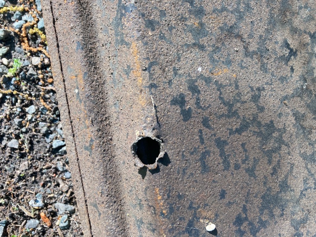

In Mike Walkers photo of factory punched running boards noted above, I have put
a red dot on the splash shield where the 1/2" gas hose hole was punched beginning
about June of 1912 and probably to the end of factory acetylene gas headlamp use.
It is in the center of the "flat space" adjacent to the running board and in
line with the two gas generator mounting holes punched in the original running boards.

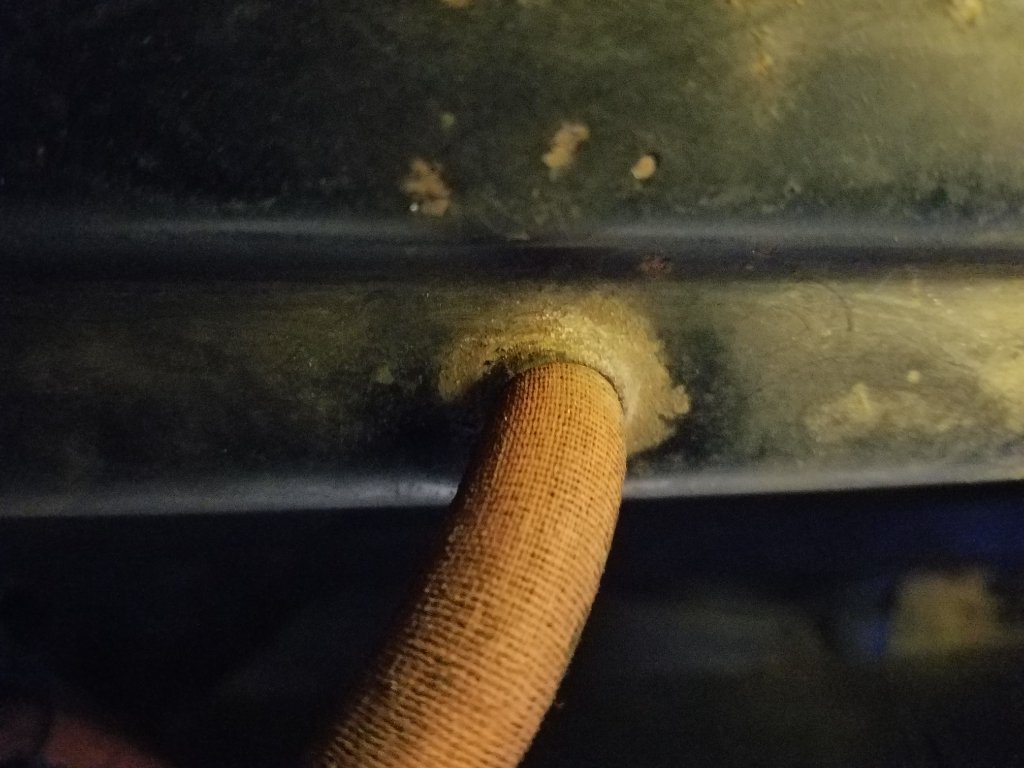

The second photo is from under the splash shield and shows the 1/8" smooth
rim factory punch on a July 1913 car. The smooth rim protects the hose.

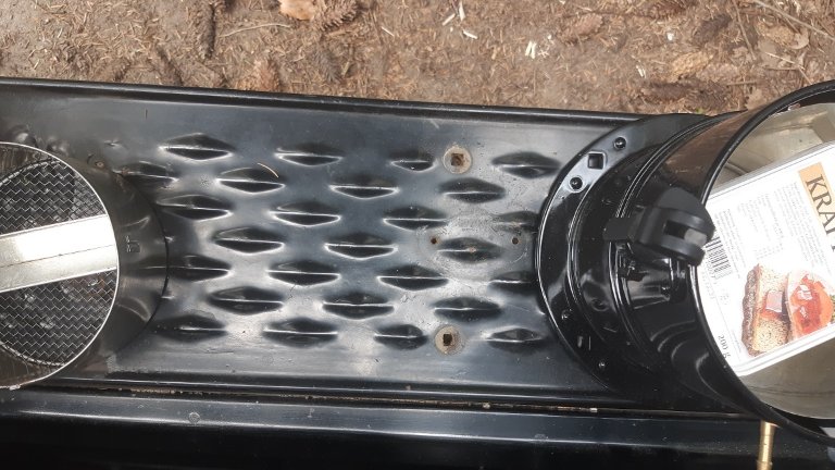

Runningboard bolts removed:

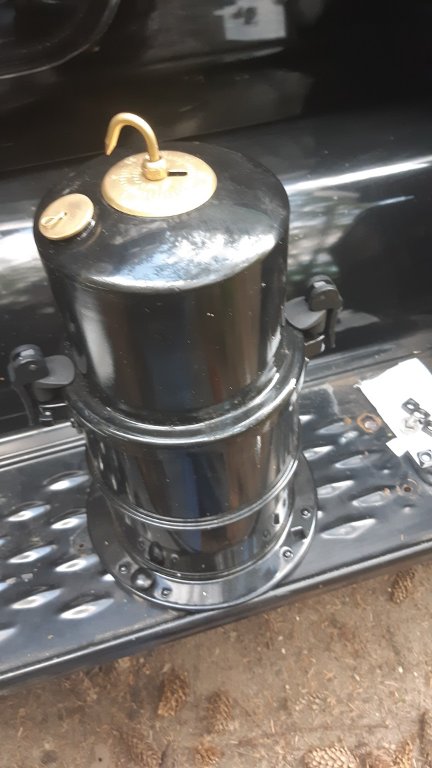

Post by dykker5502 » Wed Apr 27, 2022 5:51 pm
Final position. Now to the tube hole and there have been good advice above and in another thread.
