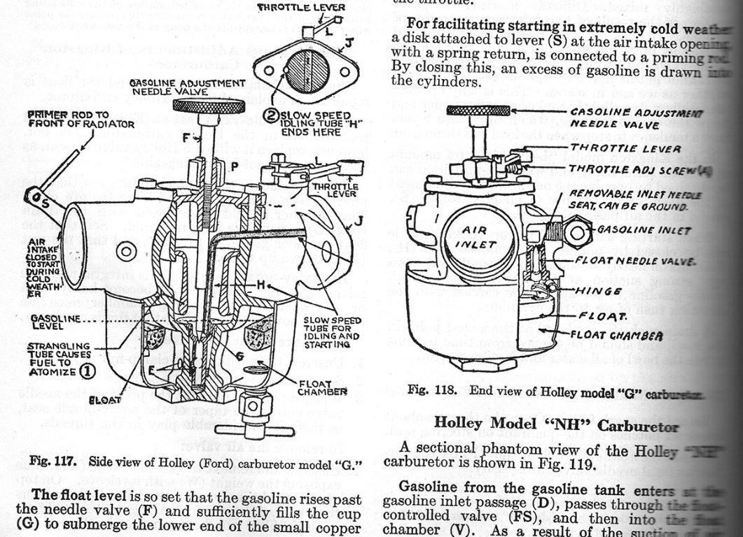

Exploded view: app.php/gallery/image/53
Rich, do you know what publication that is?
Re: Holley G carburetor
That was in the Dyke's sixteenth addition Steve.
(1934 but probably in several earlier additions.)

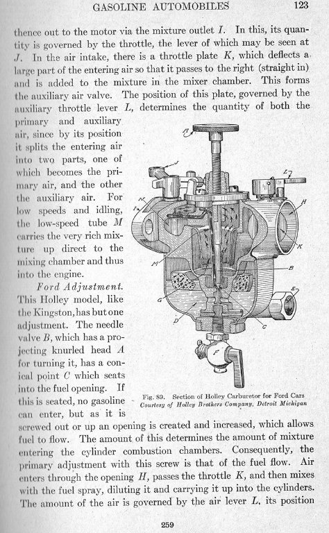

This was from Automobile Engineering (1920).
http://www.mtfca.com/discus/messages/50893/74187.jpg

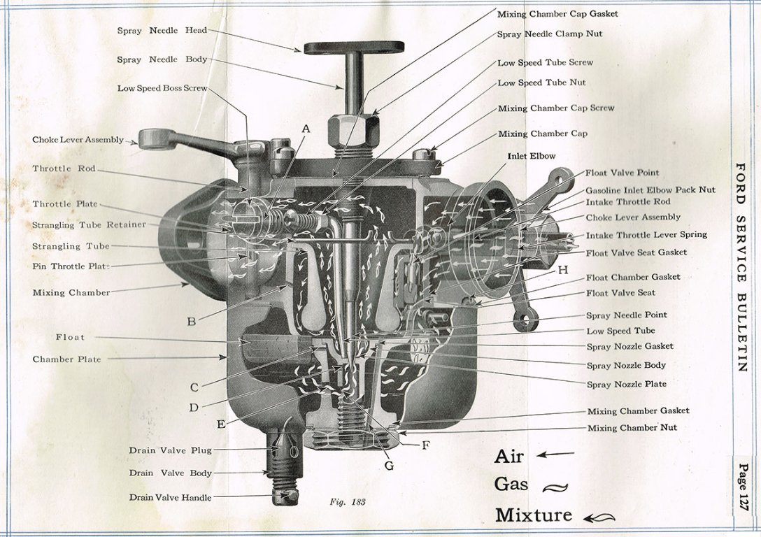

This is a bit clearer from the ford Service Bulletin, Nov 15th 1919.
Perhaps this is easier to see the early vs. the late.

Thank you all so much for your replies. Helps me greatly. I have a '14 G with a one arm choke lever and will install a G two arm choke lever so I can choke from inside the cab. From your replies and comparing the pictures, I have all the component parts except the venturi retaining spring. I can make a spring.
