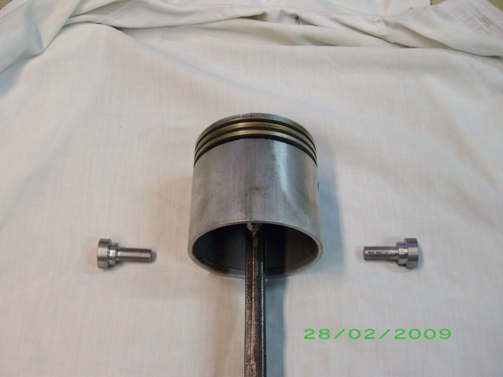

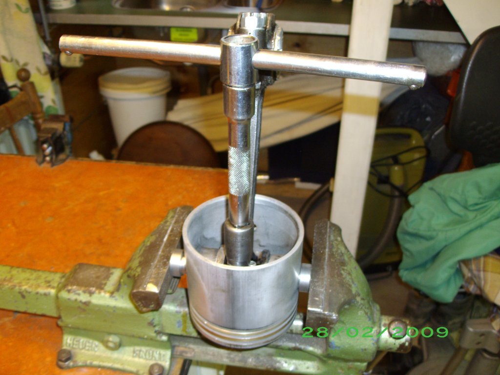

I use this ;
Toon
Posts: 7127
Re: How much torque?
Post by Allan » Fri Apr 29, 2022 5:56 am
Just like mine Toon. They hold the pin tightly with no slop at all.
