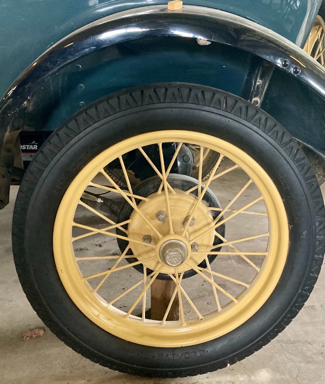

Allow me to second Scott’s powder coating advice. This is a picture of my ‘straw’ powder coated wheels on my ‘26 Tudor. Not only is powder coating much more durable than paint; years from now they’ll stay ‘shiny’ while paint fades.

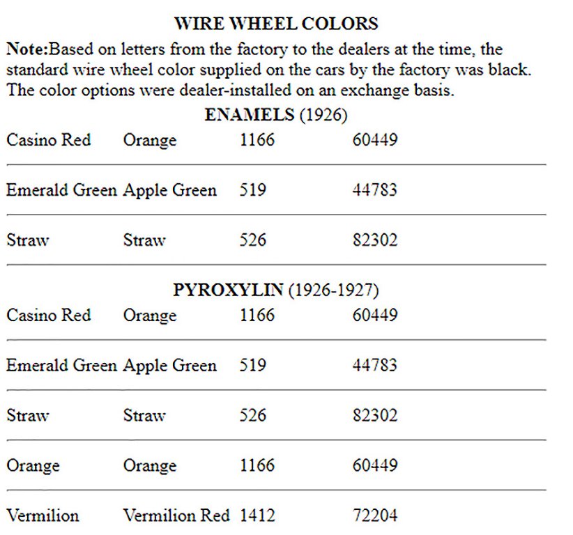

I'm not sure how close it is to the model A color discussed here.
http://www.mtfca.com/discus/messages/11 ... 1292020911 "The old Ditzler DAR (acrylic enamel) number for Straw is 82302"
Steve Jelf, Parkerfield KS on Monday, December 21, 2015 - 10:37 pm:
"For other years, the encyclopedia has the scoop." And from the MTFCA Encyclopedia (last resort

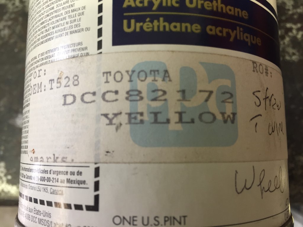

Several years ago I requested the Ditzler archives people to provide a modern cross reference for the straw wheat color. This is what they recommended:
The important code is the Toyota color code. There could be a problem getting a current formula, since this color is for a 1974 to 1978 Toyota. The Toyota paint code is 528.
http://paintref.com/cgi-bin/colorcodedi ... 2&rows=200

The 82302 paint code referred to in the encyclopedia is for a 1977 to 1980 Fiat
http://paintref.com/cgi-bin/colorcodedi ... 02&rows=50
