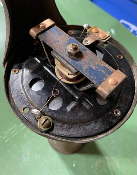

Since I’m not too bright on things like this….
Is this a Mag horn or a DC horn? The coil thingy has me thinking it may be AC??
Thanks in advance….

Battery horn.

Looks like a battery horn to me. The coil thingy is the electro magnet. Should test with a 6v battery charger.
