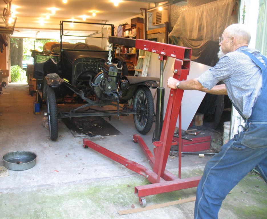

If a person of the elderly persuasion can do it solo, I bet you can too.

Re: Removing clutch peddle before engine removal.
Yes, so much easier today than when my Dad was doing it. He had a block and tackle tied to a tree branch, working in sand, alone, usually at night after work using a single globe light!
Engine lifts, concrete floor, led lights and help these days is a breeze he reckons!
Alan in Western Australia
