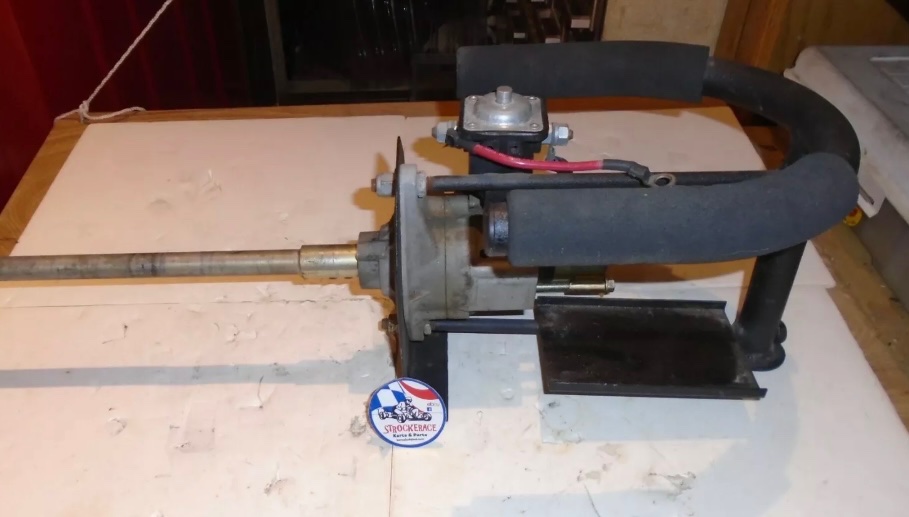

I’ve looked at Indy car type starters for my Mack, but they’re too light duty for the torque needed for it.
Might be a possibility for a T though as it takes way less to turn it.
Something like this -
These starters are very light if you leave the battery on th floor, or cabled off to the side. And you only need a couple revs to usually get them to fire.
Just need to figure out how much torque is needed to turn the T engine. (I might have to work on one of these - not getting any younger

Maybe something like this could be the start of what the OP is looking for.
https://www.jegs.com/i/JR+Race+Car/574/ ... sPEALw_wcB

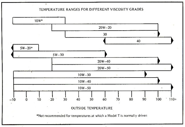

Using a 5W-20 synthetic oil can be helpful.
I wouldn't. (I did.) I assumed wrongly that it's equivalent to the 20W Ford recommended. It isn't. I suspect it contributed to my bad rod and ruined crankshaft.
- Posts: 8706
Re: External starter for early cars
My car is a former Montana 500 car. The former owner used 0W20 full synthetic oil in the engine. I've run the car several thousand miles, much of it at 40-45 MPH at temperatures up to 100 F and have had no mechanical issues with the engine. I ran about 1500 miles on the fresh 0W20 that came with it, and have run 10W30 full synthetic since, with no evident change in performance. The engine is clean inside and tight, uses little or no oil, and leaks very little. This car turned in an average speed of around 54 MPH during a recent Montana 500 mile race. All that indicates to me that multi-grade full synthetic oil is entirely suited for use in a stock Model T engine that is in good shape. Most of my driving has been done in temperatures above 70F, and much of it in temperatures of 85-90 F and up. The car shows no sign of overheating. A modern temperature gauge at the water outlet shows running temperatures from 190F to about 210 F. I think the engine actually runs a little cooler than the gauge shows. 1927 car, Berg radiator, green anti-freeze @50/50 , no water pump, 4 blade steel fan with flat belt. Ford recommended a "medium-light" gas engine oil with a LOW COLD TEST. Had any been available then, I'm pretty sure Ford would have recommend something like a 10W20 oil. Some early day manufacterers recommended adding 10% kerosene to crankcase oil during very cold weather.

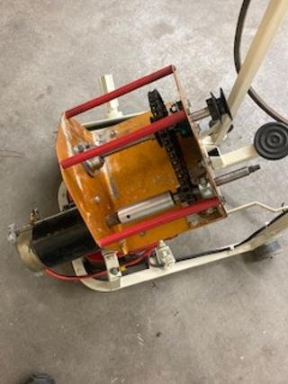

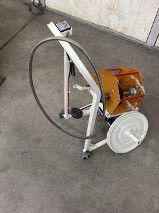

I built this for a friends 1900 Gasmobile. ( Automobile Company Of America) The car is a single cylinder, the crank is chest high and turns CCW with falling key disengagement. Bites you hard & often. It's made from a old race kart starter. The big pulley goes on the square drive for the hand crank.
Craig.
Craig.
Craig.
Craig.
