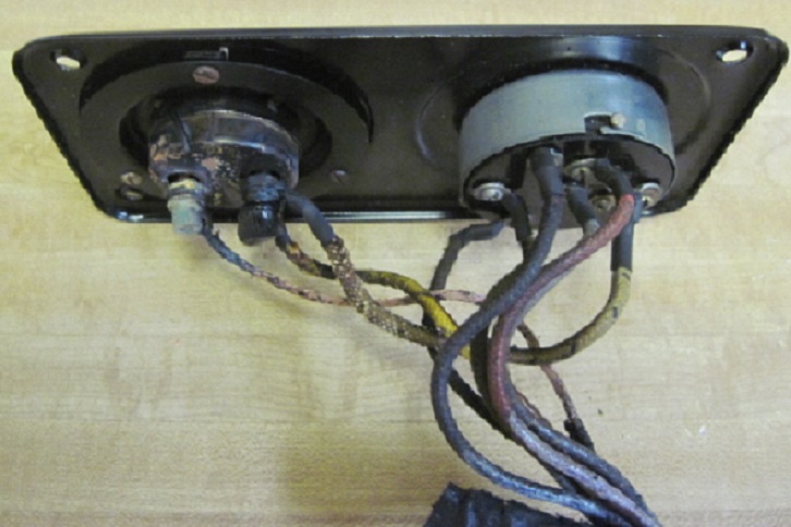

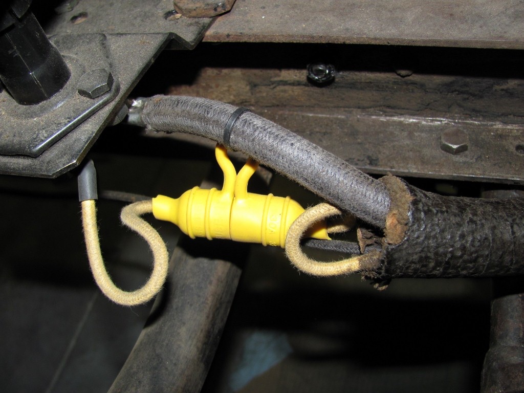

The 'best' is likely nearest the battery voltage source, so put it on the yellow wire coming off the foot button starter switch.
Or the 'best' for handy use is on that big yellow wire, but at the terminal block. That way you can just take apart the fuse holder, don't have to remove the fuse, just separate it, and all power to the dash is voided.

Post by DHort » Mon May 02, 2022 11:37 pm
Mine is under the hood like in picture #3. Easily accessible. I have 25amp and 30 amp fuses in the box, but if Ron said 25 amp, that is what I have.

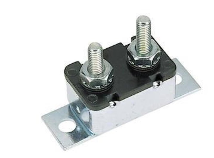

Post by Oldav8tor » Tue May 03, 2022 2:31 pm
I've been playing with electronics since I was a kid, had a Ham license for over 50 years. Fuses are installed to protect wires carrying substantial current. For my T, I chose to install an automotive circuit breaker in the equivalent of the "yellow" wire mentioned previously. Maybe Ford chose not to use them, but as someone who has seen the results of a melted wire, I see no issue with using one. My '17 never had an electrical system per se... I've installed a starter, electric LED headlights, sidelights and tail lights, so I've felt free to design an electrical system that suits my needs.

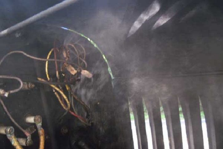

Pulled these photos off the forum in the past. And I've experienced the amp wire burning in my first T, as teen. No fun to see smoke coming from behind the dash! :shock:

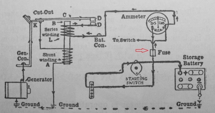

And, the original F.A system for battery start included a FUSE in that Yellow wire!
Don't know why it wasn't kept in the circuit for later Ts. Guess Henry wanted to save a few pennies, or else felt anyone who wanted a battery in his magneto Ford to fend for themselves :lol:
