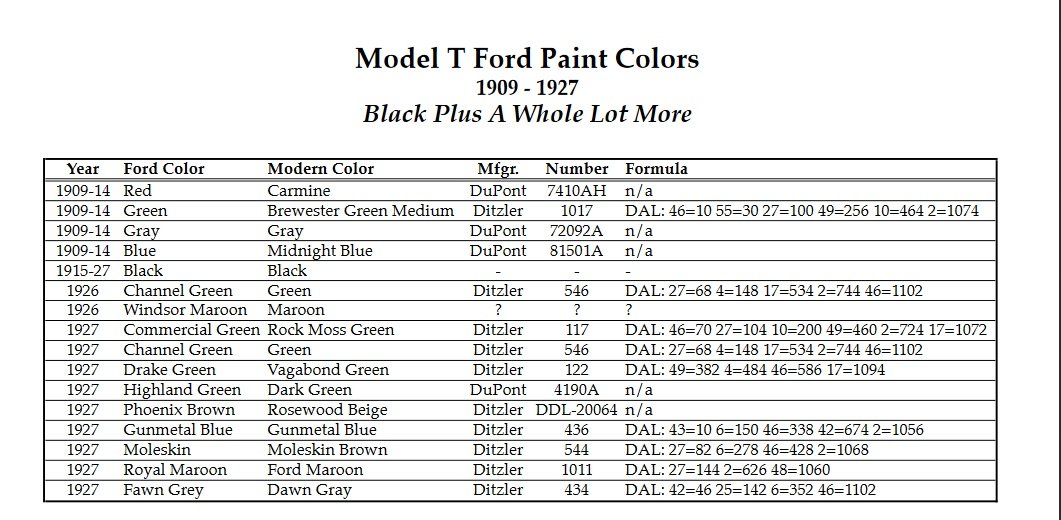

Which maroon?

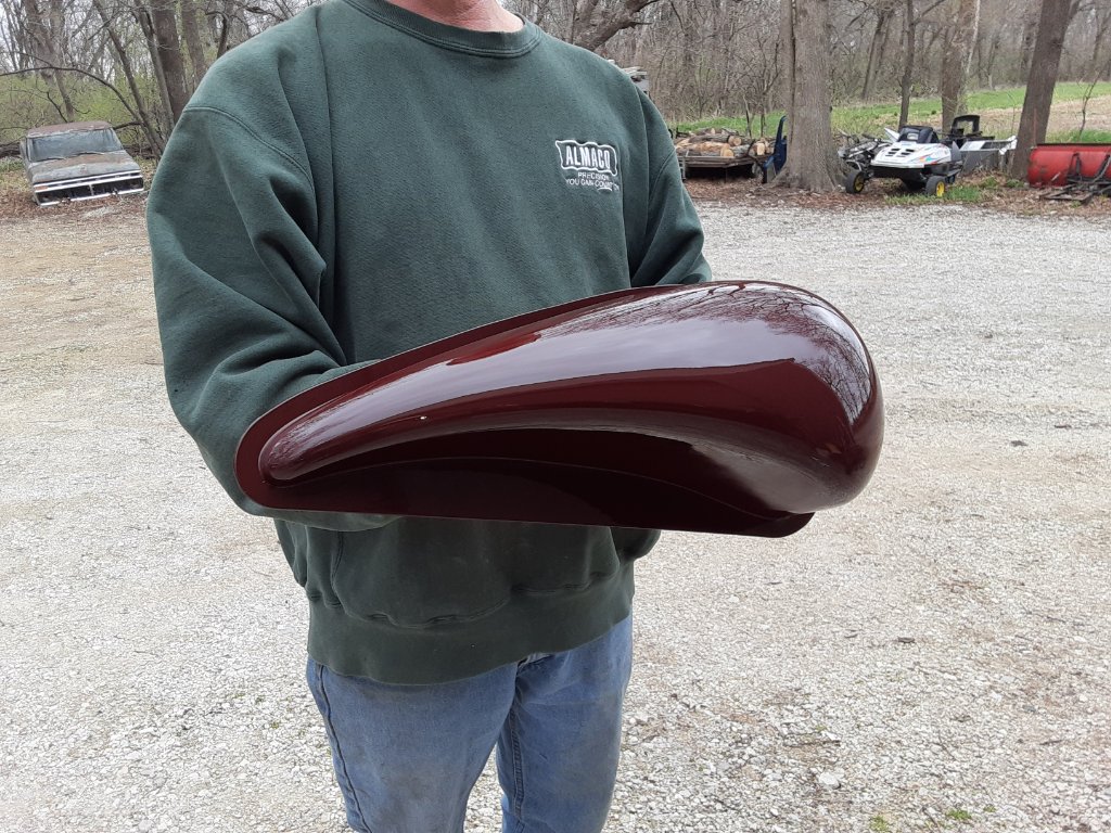

I have decided to paint my coupe marron. Here is the test sample. The fenders, splash panels and running boards will be black.
A good MTFCA member gave me the formula. We added a little black to it.

Bruce, you have done exactly what I have done in the past. The little colour chips in the books are way too small for me to get an idea of the overall effect, so I look for a car with the colour I'd like to use. Your fuel tank does the same thing. On my last two restorations I was able to access areas of the original colour in behind the rear fenders. Otherwise all the colours I have used have been factory colours from more modern cars. That gets more difficult these days with so many metallic/pearl finishes.
