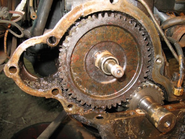

I believe this one was installed in the seventies or before. As you can see, it was in a generator engine. Would I ever install one? No way, Jose. I'm not expert enough to tell a good one from a bad one, and prefer not to gamble on this. Oh, but they're so quiet! Yeah, this one sure is. Actually, when I drove my touring into town yesterday I noted that it's pretty quiet for a Model T. It has a McEachern aluminum gear.
