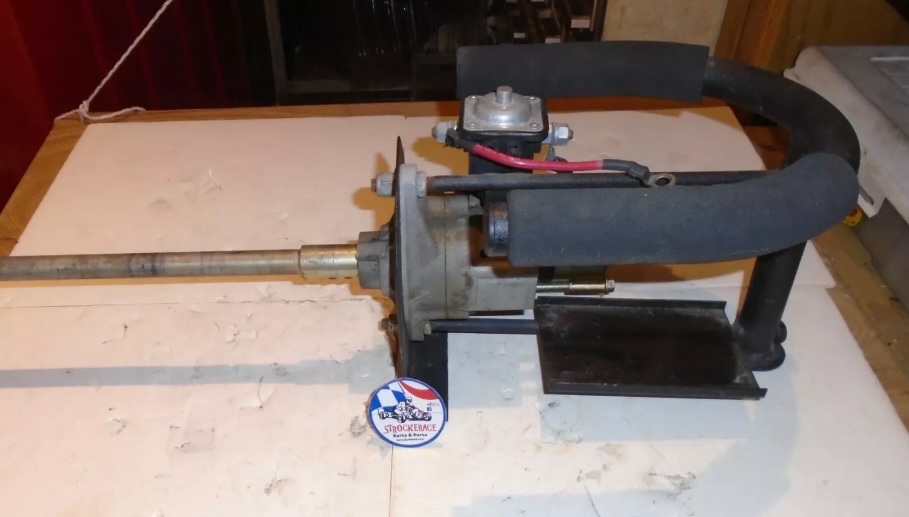

I’ve looked at Indy car type starters for my Mack, but they’re too light duty for the torque needed for it.
Might be a possibility for a T though as it takes way less to turn it.
Something like this -
These starters are very light if you leave the battery on th floor, or cabled off to the side. And you only need a couple revs to usually get them to fire.
Just need to figure out how much torque is needed to turn the T engine. (I might have to work on one of these - not getting any younger 🤔)

Maybe something like this could be the start of what the OP is looking for.
https://www.jegs.com/i/JR+Race+Car/574/ ... sPEALw_wcB

Some way of warming the engine might be the most practical solution. Any hand held starter device is going to be somewhat hazardous to use, and probably heavy. Using a 5W-20 synthetic oil can be helpful. Making sure the clutch and clutch linkage adjustments are dead-on will help. Using non-ethanol fuel will give a slight advantage.

I'm not a mechanical engineer or physicist but it seems to me that any hand-held starting device like the two shown are going to take the same amount of force and muscle as actually lifting the crank with two arms, perhaps even more because the short handles on those starters probably don't give the operator much leverage. You would need some sort of bracket installed on the front of the car that the temporary starter could slide onto and rest upon so you wouldn't need to rely on your muscles to provide leverage.
Just thinking out loud.
