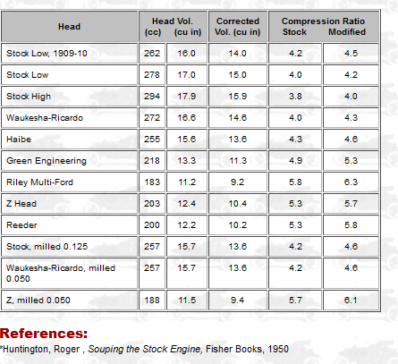

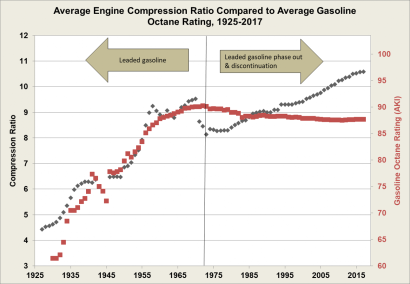

I believe the term "High Compression Head" is somewhat of an exaggeration. A better term would be "Higher Compression than Stock". It should be noted that modifications using a Higher Compression Head have also had other mod's to improve performance. Yes they improve performance but is it all of what you need. And when your done, you'll only need regular gas.
https://www.energy.gov/eere/vehicles/ar ... ane-rating

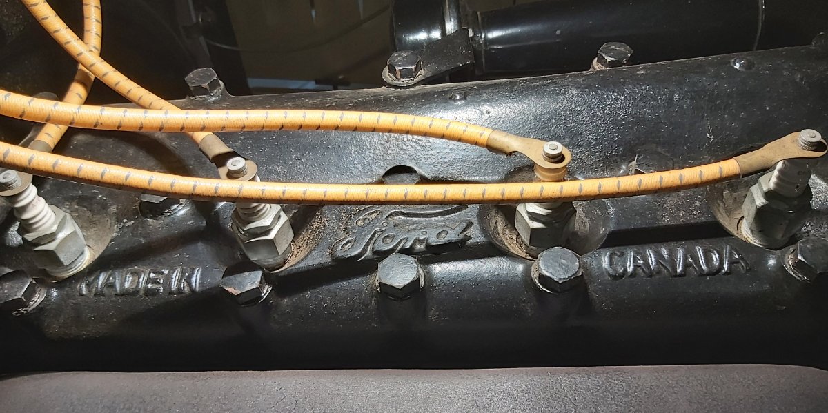

I suspect you might have a stock "low" head.
I have a 22 Roadster, which is a light car compared with a tudor. The previous owner installed 3-1 ring and pinion. It also has Ruckstell. Although that car goes a little faster on level and downhill, it is slower going uphill. we have a 6% grade leading to our town On that grade I can climb in high if I can keep it around 30 mph, but the T's with standard gearing can go about 22-25 mph, and when on a tour, I have to use Ruckstell.
So you will need to keep your speed up and if it begins to lug shift down to low. You would do much better with Ruckstell or other auxiliary transmission.

Les and Allan. How do you solve the problem of the lack of Ford script?
I have what may be the last cast iron head Prus made on my 26 Tudor.

As far as I know, all T heads will interchange, but they are not all the same. Early model heads have more compression than later ones, and there is a difference in appearance and top to bottom dimensions (?) between early "low" heads and later "high" heads. All heads I have seen match the block fairly closely. Changing from a "low" head to a "high" head might require changing head bolts. Very late heads may not have the Ford script. Gasket listings I have seen show the same gasket used for all years. All use the same spark plug.

Dale, here is my alloy Prus head, now complete with Ford script and MADE IN CANADA. I built a little dam with modelling clay for each word. The dams were filled with Devcon. When set, the lettering was marked out and hand carved with an Exacto knife and a Dremel tool. I even added a number and casting marks just like the original it on head from the motor.

Thank you Allan. I'll have to try that.
