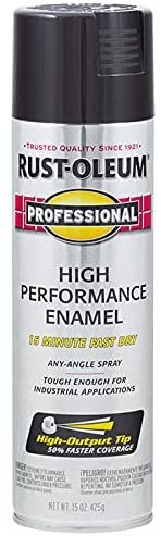

I used this on the body of my '26 project for final color coat. Dries quickly and covers amazingly well. High volume spray with a wide area of coverage. This is not your normal rattle can paint.
And is very easy to do repairs with to. I used their gray auto primer or their etching primer under the gloss black.
Warning: their Red primer and their sandable primer reacted under this paint. You'll be fine if you stay away from these.
Easy to repair chips with a dab of paint on a toothpick or q tip. Primer as noted performs very well.
