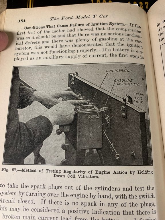

I tried holding down on the points like in the picture. I couldn’t get any negative response from the car. I got a little buzz in my fingers. I tried the screwdriver to the spark plugs. No negative effects except one time when I shorted #3 the engine died. I switched #3 & #4 coils, but couldn’t get the same response. I’m thinking that I might not have a coil issue? I know the plugs are pretty fouled. I suppose that could cause the missing and skipping?

Possibly, but I am little curious when you say you got no negative response from the car when earthing the points or the plugs with the screw driver trick. That is odd as a running car should immediately die a little when each cylinder is earthed out because it is suddenly running on 3 instead of 4 cylinders. The earthing trick is sometimes better done at a fast idle.

It did the one time, but wouldn’t again. The RPMs seemed to decrease just a bit, but it kept running.A Whiteman wrote: ↑Tue May 10, 2022 2:08 amPossibly, but I am little curious when you say you got no negative response from the car when earthing the points or the plugs with the screw driver trick. That is odd as a running car should immediately die a little when each cylinder is earthed out because it is suddenly running on 3 instead of 4 cylinders. The earthing trick is sometimes better done at a fast idle.

The best way to find the bad cylinder is to take the top off the coil box, run at a slightly fast idle, then stop cyls 2 and 3 by stopping the points on the two centre coils with your fingers, then do the same but with 1 and 4 - the outer coils.
If all's well, you hear a 2-cylinder engine on each test. If a cylinder's gone, you only get one left.

I just stepped outside and gave that a try. No big difference at all. Does that mean my coils are good, then? Coming into work today I was able to top out at 25mph, but that's it. In low gear I got it up to 13mph and it wasn't going for anymore.Chris Barker wrote: ↑Tue May 10, 2022 7:01 amThe best way to find the bad cylinder is to take the top off the coil box, run at a slightly fast idle, then stop cyls 2 and 3 by stopping the points on the two centre coils with your fingers, then do the same but with 1 and 4 - the outer coils.

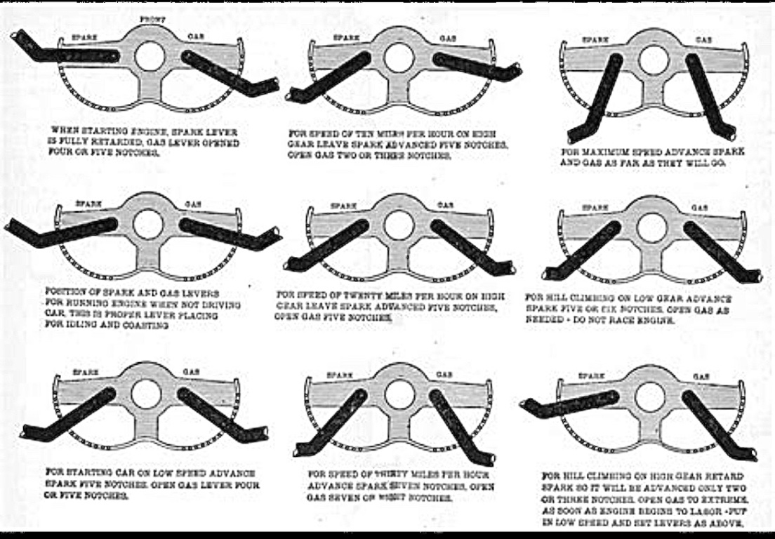

Scott (catguy) I suggest you not wind the engine up in low to 13 mph that’s not needed and not good on the engine overtime. Curious do you reduce throttle as you dump low for high? So based on what you said about the coils in response to grounding them. I wonder if the reason your not hearing or feeling a change in the engine is because certain coil/coils is/are not working at all. Do you have access to a coil tester? One that can actually tell you what the performance of the coil is? If no, then, (please no Cat Calls) while it’s not the best by any means but something that can help a little without great expense is to build one. It’s really easy for what it is & does. Basically the only thing it will tell you is if your coil will through a 1/4 spark consistently to another contact. You can make one with a meter or without just to find out if the coil will actually spark without the meter and with the meter the guesstimated strength of the spark. Very poor tool but it’s what a lot of old timers had and used for years. Best thing though is to send them off to be reworked by one of the members that rebuild them. I’ve use Mr Patterson but have used two others in a pinch. the difference in having them “tuned” LOL by yourself and having them done by someone that does it professionally often, is night & day performance. YOU WILL BE SENDING THEM OFF EVENTUALLY, if you are into your T long term. Might as well get a potential major issue out of the way early to concentrate on other T related things that you can do while waiting for them to be rebuilt. JMHO. Best

One other thought; do you advance your timing after starting, and is it set so that it sparks just ATDC when the lever is 'up'?
And are you running it on magneto?
If running on 6v battery, you need a lot of advance.

Last year I bought a Model A as I had always wanted one so you could say I'm using that driving technique in regards to the spark control. I wonder if that also could be my issue? I do run the car on the magneto after starting. That doesn't appear to make a difference.Chris Barker wrote: ↑Tue May 10, 2022 1:15 pmOne other thought; do you advance your timing after starting, and is it set so that it sparks just ATDC when the lever is 'up'?
- Posts: 1967
- Last Name: Tannehill
- Location: Hot Coffee, MS
- Board Member Since: 2002
Re: 'Skipping Cylinder' or 'Is This Safe?'
Model A & T are a bit different with the spark/ advance. Steve Jelf on his website, https://dauntlessgeezer.com/DG52.html
has a diagram of advance & throttle I believe, you may find it of interest along with other tips for DIY info.
