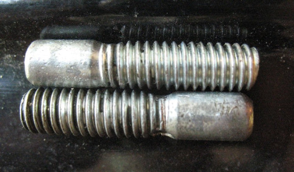

Re: oil pan
If you do this job, reinstalling the horseshoes and inspection cover can be difficult. You cannot see the horseshoes while holding the pan in place. How do you install the bolts?
I made alignment studs to ease the assembly. I cut the heads off of four 5/16-18 bolts and cut a slit on the cut end for a screwdriver. I put the horseshoes in place and put two studs into each of them. Then the inspection pan slipped over the studs and all bolt holes were lined up. Add your bolts, replace studs with bolts and the job is done. You will need to use sealant washers to hold back leaks. I used neoprene but others have made washers from rubber fuel hoses.

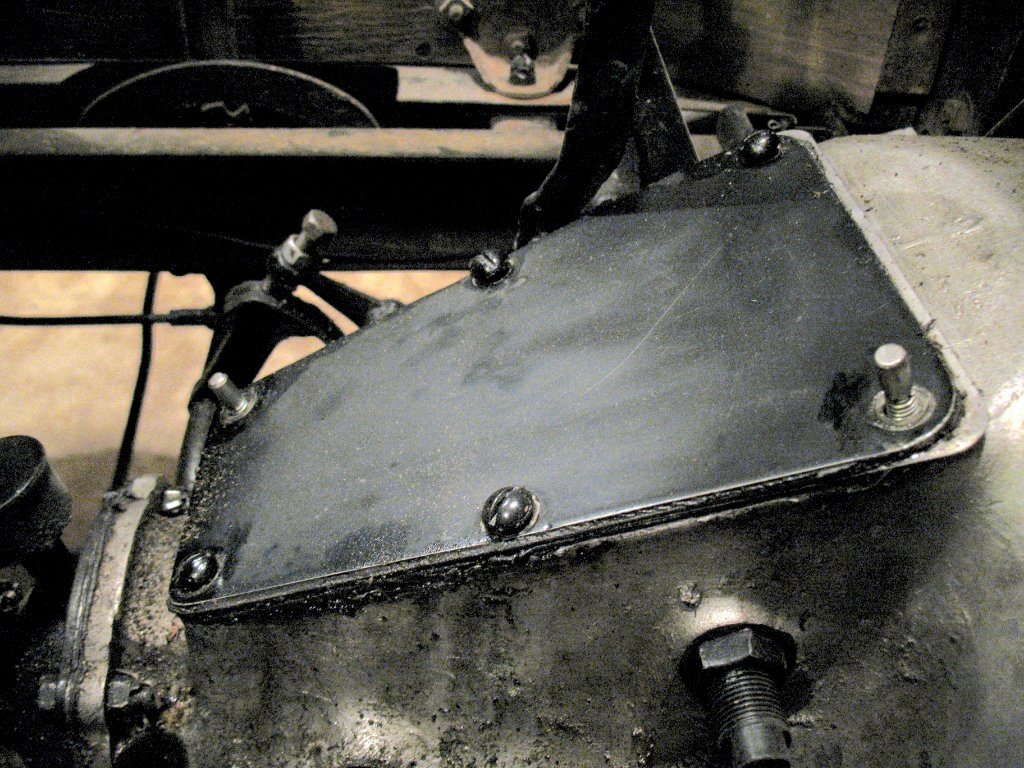

- Posts: 7411
Re: oil pan
What Mark said.
You can also use them for the transmission cover. There you only need two. Install them before you remove the cover and take them out after you replace it, so there's no chance of dropping one into the Black Hole of Misery.
