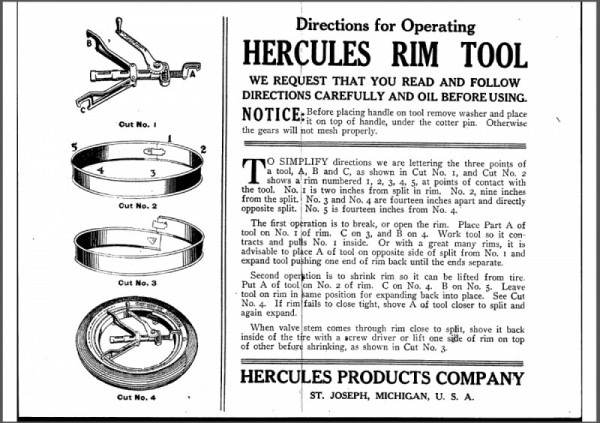

Would this help ? Split rims are the easiest to work with.
- Attachments
- A8CC55C1-6BD6-4856-AEBE-ACCB92208E92.jpeg (120.54 KiB) Viewed 2163 times

My experience is limited to just two 23" Chev split rims I am running on my 1924 tourer. I know about swapping the tool around from the opening position to the closing position once the tyre is fitted. I would appreciate some instructions for this. The posted Hercules material is too small for me to read, and doesn't appear to show the refitting position of the tool arms.

Thanks all and thank you George the instructions do clarify how to use the tool. Allan if you make the posted instructions the background photo on your desktop they are readable. Hummm? the instructions only show how to remove the rim not how to install the rim in a new tire.
