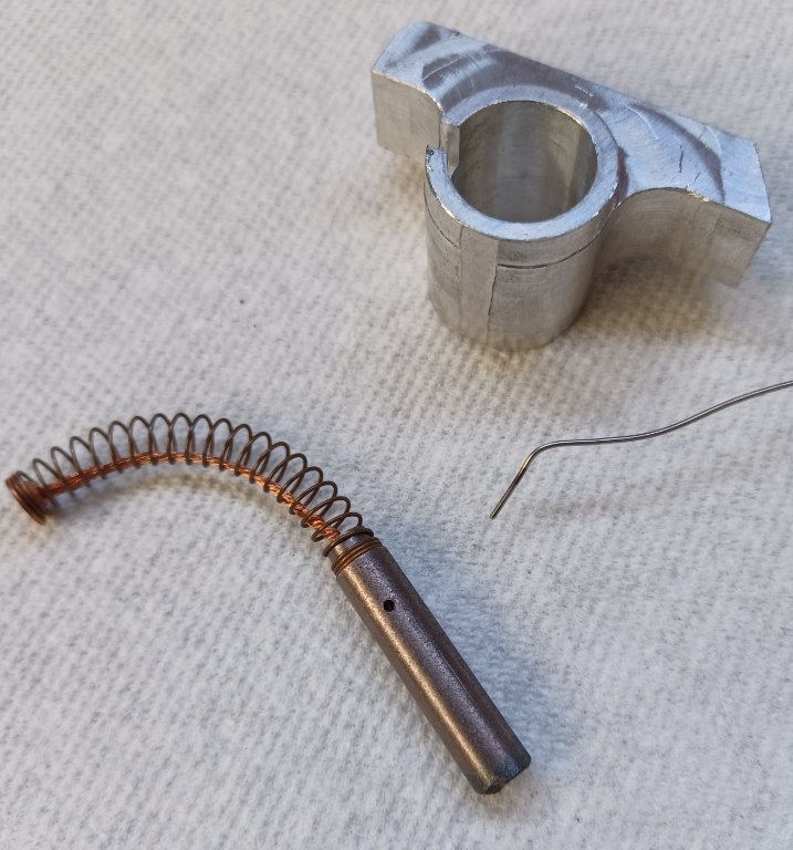

If you post a photo of the brush, I just may have one. I purchased a collection of timer brushes a year or so ago. While many are the standard brass or steel stock Ford ones, I also have several unique accessory ones.
Andy
Posts: 3743
Last Name: Wrenn
Re: TW timer 1/4” round brush
Post by TWrenn » Thu May 12, 2022 9:23 am
Hope this helps.

Thanks Ron for this info. I just brought up their website, they can even attempt custom production. So these people just may be a source to keep this otherwise fantastic timer that Tony (RIP) developed. As I've said multiple times, I have these (rectangular brush model) on 2 of my stock ignition cars ( torpedo came with T.F.), and they couldn't run any better. Luckily, I have a couple rectangular brushes for my "fleet". I may put the round one on the Torpedo this year. But good to know just maybe these folks can help us out if need be.
For anyone interested, it's https://www.stmaryscarbon.com and their phone number is 814-781-7333

You can email St Mary's along with your photo above and I 'll bet they could ID that brush and the source.

Looks around an 1 inch long. Found several sources online. I’ll get one ordered and if it works I’ll post it.
