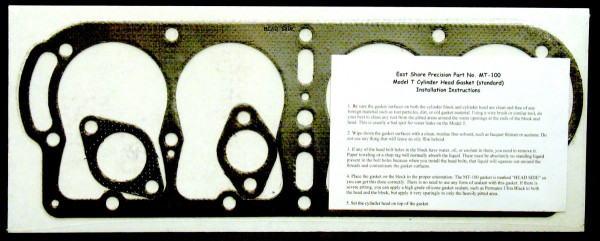

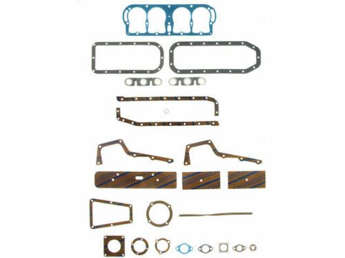

Maybe you have to buy a full gasket set to get one? Are the full sets unavailable also?

I am selling a lot of Model T parts on eBay and a couple of months ago I listed a hard to get copper Model T head gasket, still in its plastic packaging, with a starting bid of $30.00 and after 32 bids, it sold for $157.50. Needless to say, it was unexpected. The starting bid was $30.00. The bidders determined the selling price, so I was not taking advantage of the unfortunate situation. Jim Patrick

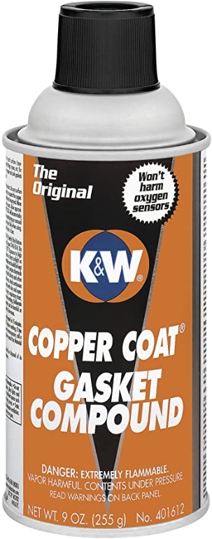

A head gasket is almost impossible to remove without damage if K&W spray-on copper gasket sealer was used. Is there anyway to soften the gasket sealer to make salvage of the head gasket more likely? …such as running the car until hot and then attempt to remove the gasket. Being hot, might soften the gasket sealant making it easier to remove. Jim Patrick

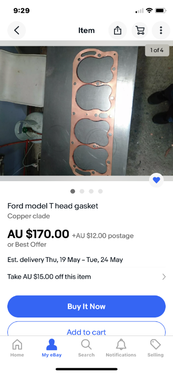

Re: Headgaskets: Everybody is Out of Them
eBay AU if any interest UD dollar maybe attractive to bulk order. Just a thought

I always use Felpro gasket sets on engines rebuilt in the shop when available because they are the best on the market. The last T set used came with a copper gasket, although their set for T available now, part number: FS 7012 B it is shown in blue and may still be copper? If not anything that Felpro sells works well and if you can live without copper if it is some type of a composite, I wouldn't hesitate to try one. Your locate parts store or engine parts warehouse should be able to get one.
Here is the catalog listing @ https://www.drivparts.com/part-details. ... sket%20Set
They are available on ebay as well for $147 and $192.
- Posts: 8636
I just bpught a Fel Pro full set for a T. It appears to be newly made, with fresh gaskets and fresh packaging. The head gasket is the blue (teflon?) type that Fel Pro has sold for years for many applications, including many 1950s-thru 1970s high compression V8s. It has steel fire rings and a fiber core with the blue, slightly tacky overlay. I beleive these head gaskets are meant to be used without any kind of sealer, but I'm going to review the FP website before I use it. The other gaskets are mostly rubberized cork, and appear to be of good quality. The pan cover is a black fiber material. The manifold gaskets have steel glands that fit into the ports. I did not see any felt items or crankshaft seals. (FS 7012 B)
