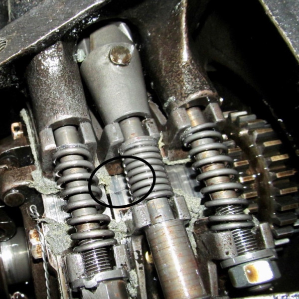

They must be badly glazed or burned. Good kevlars dont chatter & in fact feel like soft cotton lining. They can be removed & re riveted with the new side out. Hogs head must be removed . The worse news. That lint is a strong indication of a cracked drum shaving the band. Lift a wheel & have a friend turn the motor over whall you look @ the drum surfaces. That lint can get in the oil holes & prevent good internal lubrication. No additives are necessary & wont cure your problem.

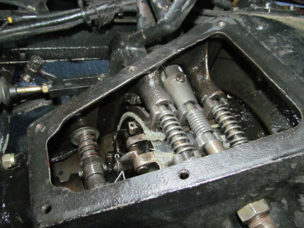

If the bands are on in the direction that the removable ear is against the side where the pedals are, you can easily remove them. you will need to remove the springs and pull out the shafts on the brake and reverse. Back off the low speed adjuster to allow the spring to be removed. Then you can rotate the bands enough to get the removable ear to the top and remove. Then pull the band out the opposite direction. Before you do any work such as removing the nuts washers and springs, stuff some rags into the transmission so if anything drops it can be retrieved before it goes all the way to the bottom. Also remove the key and anything else which could possibly fall into the transmission. One thing I have found out the hard way, is when you remove the nut from the end of the pedal shaft, the band can spring suddenly and knock it down, so be very careful.

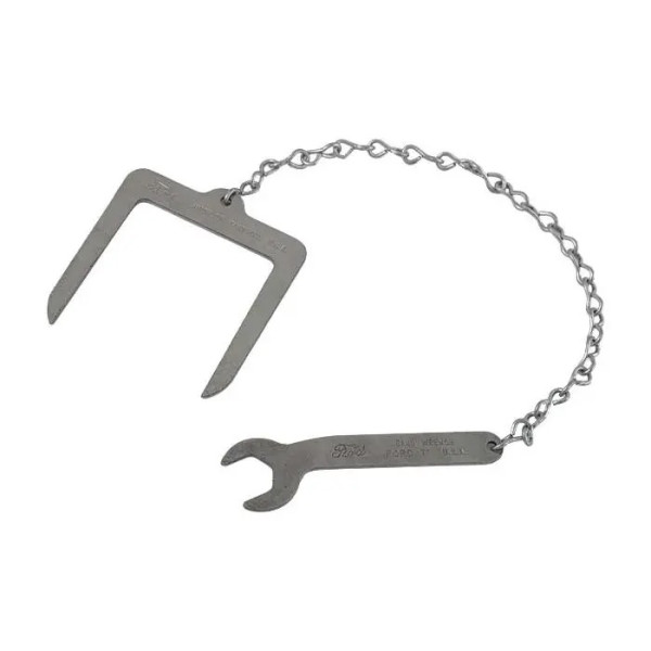

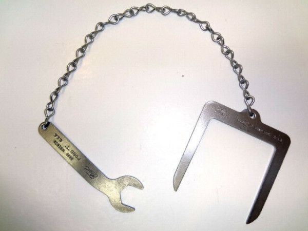

I don’t know why, but alot of people don’t like this tool, but I sure do. It prevents the bands from springing apart like Norman described and has prevented that from happening to me. I highly recommend it. Don’t forget the rags in the space to the right of the band nuts, all along the passenger side of the hogshead. Fill all spaces and take your time. Jim Patrick

This T on tour had hydraulic brakes, so band chatter was from low pedal, and poor low go, owner kept adjusting ‘worn’ lining til no more adjustment left. Taking off the inspection plate and looking close while hand cranking over showed cause of worn lining, years old worn down, sharp edged and now cracked drum eating that lining.

Car does have a Ruckstell, but not being a hot rodder my road test has been done in ruckstell lo. Bands are coming out at my leisurely way of doing things so it will be a while before I post results. I need to find my band clip as shown. No one mentioned to count the rags that one packs in and count the rags removed but I will.

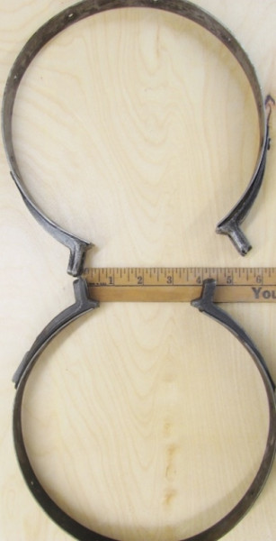

When re-shaping bent or out-of-round bands, strive for a gap between the ears of the bands of 4" to 4.5". The band should be shaped to this contour prior to fitting the linings.
Band above in photo is prior to re-shaping.

All as Dan said...PLUS, when you gently pinch the ears "closed" the band should close as a PERFECT circle and not rub prematurely on the drum...even when ever so slightly larger than the drum, the bands must not have a preferential area where they rub...they must be totally free of the drum.
if at all possible borrow a used drum to use as a go-nogo fixture when making them circular
