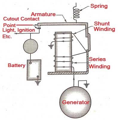

In its simplicity a cutout is a magnetically controlled switch that provides a path for current flow from the generator to the battery. The cutout permits charging of the battery when the engine is running and prevents the battery from discharging when not.

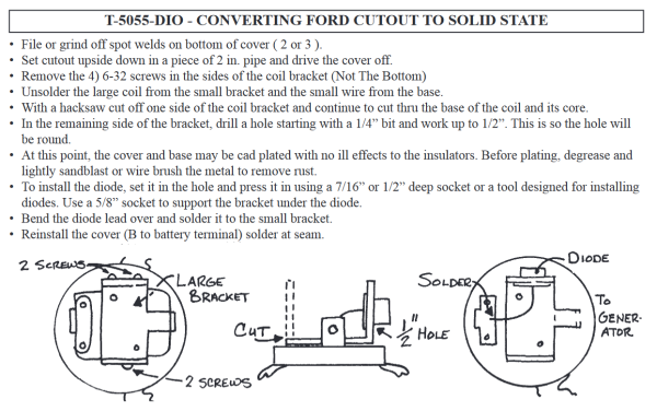

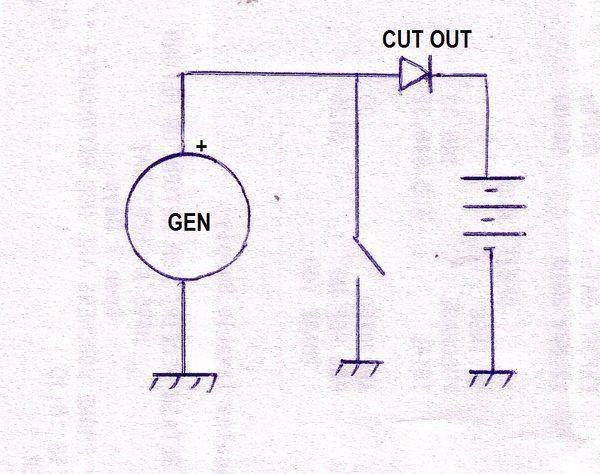

Up grading a mechanical voltage cutout can be accomplished with a silicon diode. One that is suggested is a NTE6094 Silicon Schottky Barrier Rectifier.
Checking web sites for various clubs and automobile clubs share similar information.
The diode can be found on line with prices from $5.00 to over $15.00 (USD).

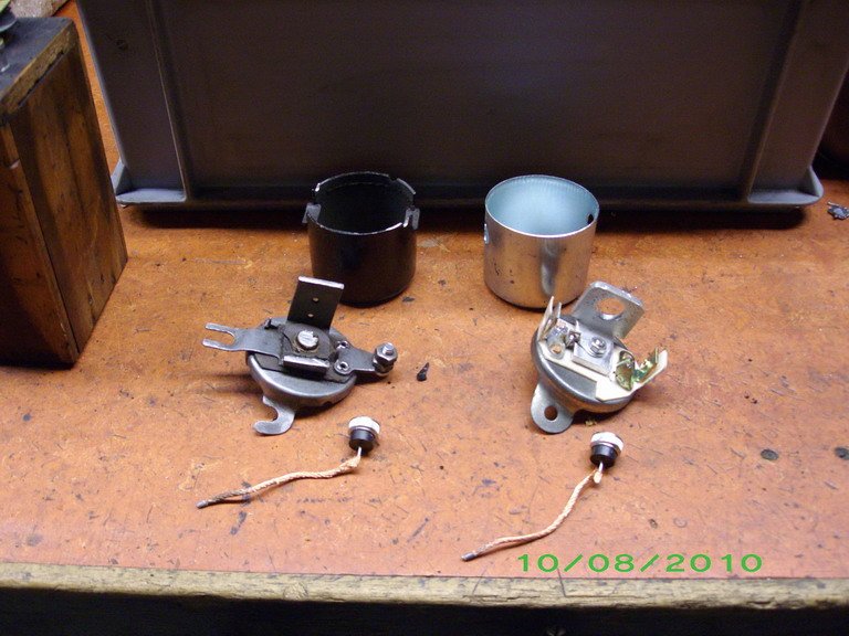

You can purchase a new, fully functional diode from the Nu-Rex company. It is not a mechanical cutout. It is solid state with an internal diode. Cost is only $62.25 plus shipping. I ordered mine on a Thursday and received it Saturday. My car is back on the road.

Its just the internal diode that makes it solid state, nothing else is needed. Diodes generate heat when functioning - a "heat sink" can be anything used to dissipate heat, a finned aluminum block or even the bracket the is mounted to and the cut-out body. There isn't much room inside the cutout.
An additional plus is that the body is cadmium plated. Its a good choice for those not wishing to mess with upgrading their old one.
